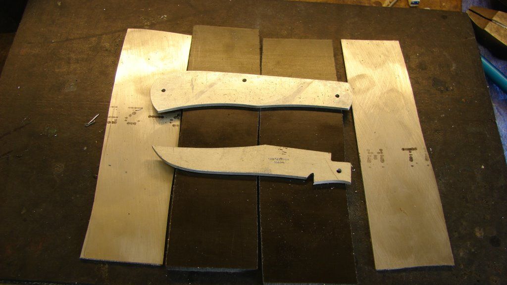

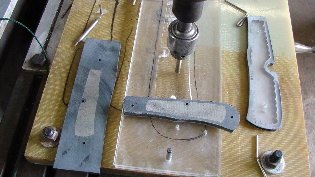

This is something new for Rick it's a shadow Interframe, Here's some WIP of what he's
got going on... Enjoy! No CNC machine at all.
Jason
The start..
Milling

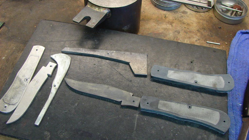

I had some photo problems with WIP pictures. So this is the end result! Lots of hours in makeing one of these. Had to start over twice but this is the first round of what's coming.

Is the black border of the interframe, polished black micarta? Can't tell from here. Looks great, I'd love to see one with ironwood for the inlay.
Black paper micarta. In the future I will be inlaying wood, ivory, stag and bone. The frames's will be micarta, stainless and aircraft aluminum. I wanted to work out all the milling process before I start on stainless. Its all done on manual machine's and stainless frames will take 6 or 8 hours. Were the Micarta takes half the time.
