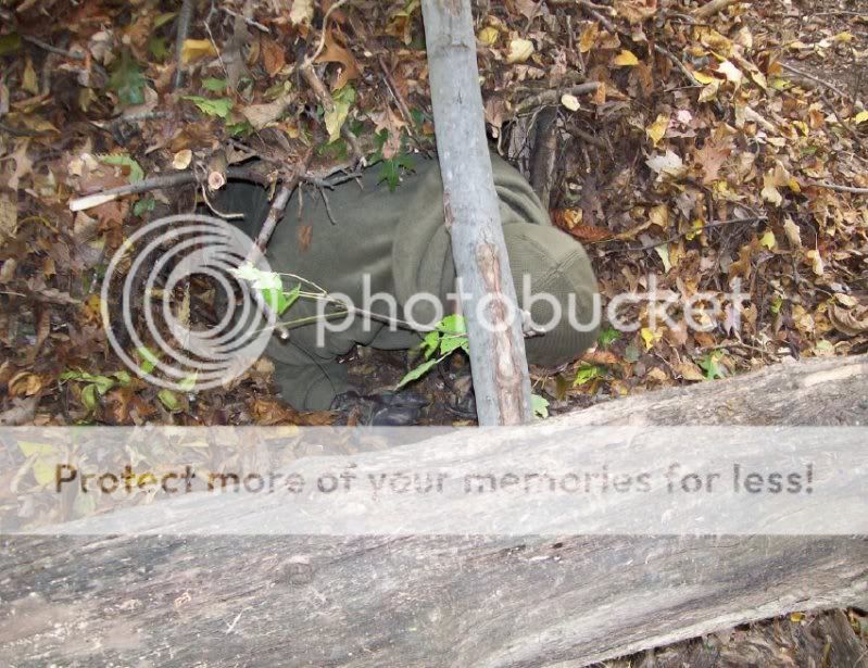

Rick at the entrance of his shelter.. Getting ready to crawl inside backwards.
By normark1 at 2009-10-15
A kind of poor picture of the final shelter.
Rick mentioned that we should have put more debris on,, however we were short of time…
Rick Crawling in…

With more debris on top and stuffed into the door... that's a damn good shelter.
The floor was awsome. We laid down bark, then about 10 inches (packed) of debris, then another layer of bark. After everything got packed down we had about 6-8 inches of SOLID, immovable insulation underneath!!

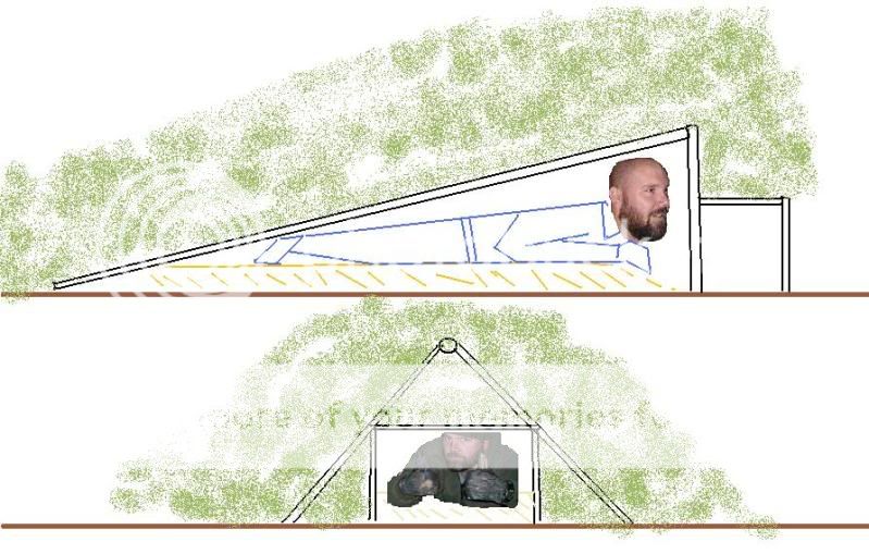

One of the most common mistakes I see is folks leaving the front either wide open or poorly insulated. All of your bodyheat will travel up and out the top of your hut if you don't plug the peak of the ridgepole. I make a "box" entry and tie it into the hut. it should be 1 1/2- 2ft deep, shoulder width.... basically enough to wiggle through backwards. (take into consideration the height of your ground insulation)
Pile leaves close by and inside the shelter. After you get in you can pack the cavity with leaves and maybe a daypack if you have one. It's tight (I happen to be a severe Claustrophobic as Eric will confirm) but I have spent a few cold nights in a properly done debris hut without a problem. The thought of freezing to death will help you endure many uncomfortable scenarios.

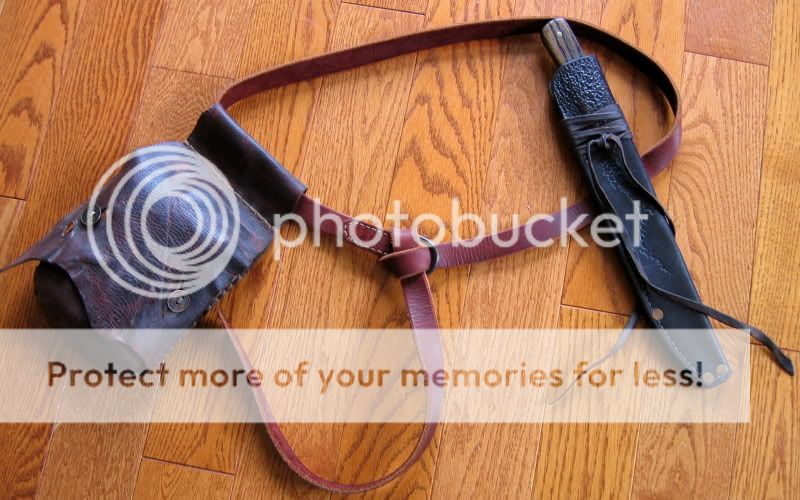

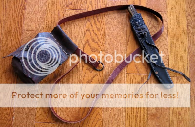

Oh man, I love watching the kids build debris huts. Almost 99% of the time, they seem to base it on the smallest kid in the class, and ultimately they want me to get in it. I end half way in it looking like a turd. Glorious pics! What is that dangling piece of leather?
....What is that dangling piece of leather?
Thats my Bushbelt, Joe. Infinate adjustment.... multi-use....
I can use it to hang my pack, tote firewood or bridle a moose!
I'd like to tell ya it was my idea, but ancient European civilizations made it public just before I did. Early bird gets the worm and all...
Fine looking shelter! Later you can show them a proper snow shelter...oh yeah, you already did that didn't you. There are a few things in this world that can help get past claustrophobia.
I love the belt design!
Your knife rides a bit higher than I thought it did.
...Your knife rides a bit higher than I thought it did.
I wear it in a cross draw fashion, Mist. For the most part, it sits on a 45Deg angle just infront of my left hip. I have really grown to appreciate this carry method for in the woods.
The Bushbelt is not worn to hold my pants up. Its a utility belt that can be thrown over my outer layer. I also have the option of sliding my belt items around without having to deal with beltloops. I can even wear it baldric style thanks to the extra length.:thumbup:

Rick the way you have you bush gear and belt really is a neat idea. I am going to look into make up a leather belt like that for carrying my bigger knife in the bladric carry. I have been using a military sling as my baldric carry strap.
how wide is your leather belt in the pics that you posted?
