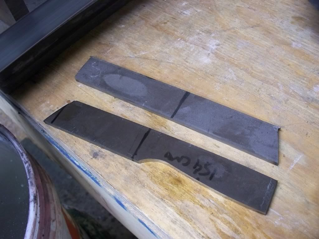

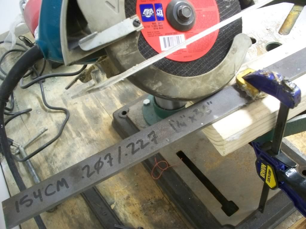

I'm about to cut a couple of 8.5" long pieces of steel with my friction saw.
Here's one after some stock reduction. I'm using a 36 Blaze belt on my KMG grinder for this part.
Profiled out!

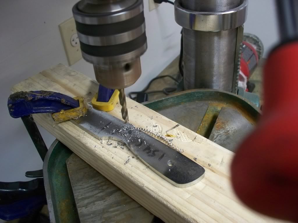

...starting the holes for the hardware and lanyard.

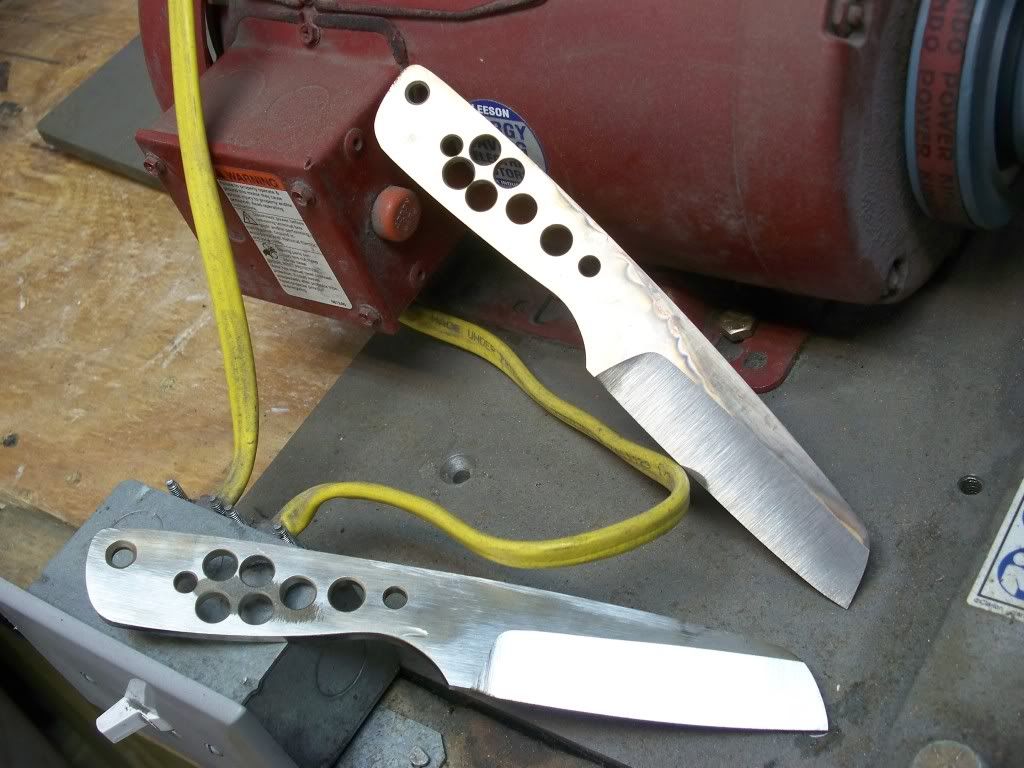

Thanks guys! Here's some more progress... the knives ground at 36 grit and a shot of the tapered tang.
