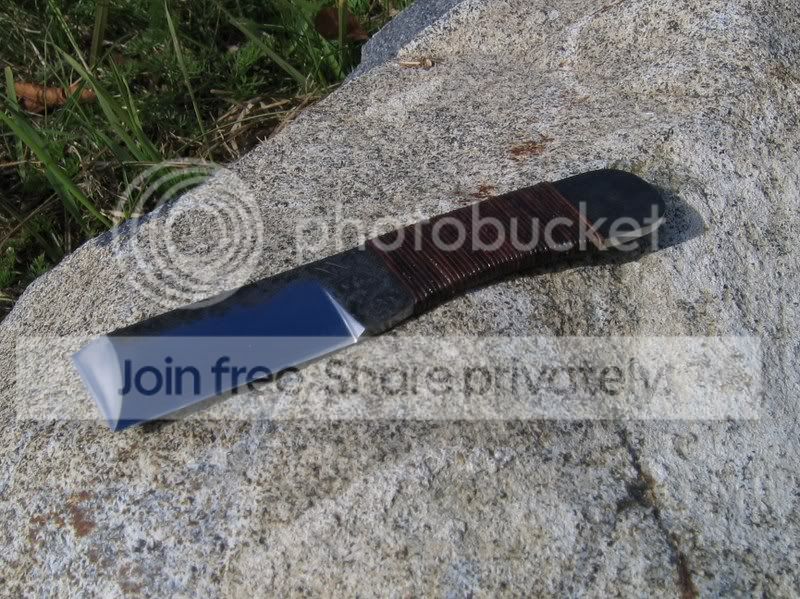

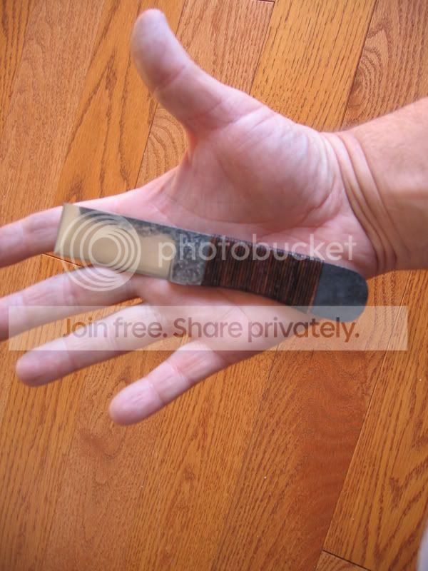

The knife that sparked the question was this one....
I made it as a right handed utility knife. If the grind has been deemed "left handed".... so be it. I guess it makes sense seeing that the bevel is on the left side of the knife.... But it is a left hand grind on a right handed knife .... he he he. IMO, it makes no sense to use this knife with a left hand..... but to each his own.
The original purpose of a chisel grind on a knife I am familiar with is in chefs knives. Of course chisels are a different tool but they would certainly predate these types of knives. In the kitchen the chisel grind should be on the right side of the blade, when in your hand for a right handed person, so that the flat can go right up against the fingers on your left hand. However Emerson sells knives to lots of folks with the grind on the opposite side. I think your knife would sell to lefties or righties without problems.
The blade on your knife is a left hand grind.( on a right hand knife). Whittle on a stick with the knife in your right hand then switch to the left hand, you should notice a differance in the way it cuts. The flat chisle point will work the same in either hand.
I have made chisel grinds on the other side and couldn't get the control that I could with this config...... I assumed it was the correct grind for a right handed grip. Then when I searched woodcarving techniques, "bevel down" was used more often than not, which confirmed my own experience. This knife was made as a utility blade for trap-making and campcraft stuff. I totally agree with the food prep arguement...... but this knife was not made for that.
I would still love to see someone make a concave cut into a flat edge with the bevel up...... that would impress me.
When are we gettin' together, Jimi?
AAAAAHHHHHHHHH! That makes sense. Use dictates design. With the grind you have it would work great for, notching traps and making firesticks. I was just trying to answer your questions as far as a left and right hand grind.
By the way The knife looks pretty cool.
Well, that J.Wade guy always throws me a curve when it comes to knifemaking.... I'm not up on all the industry standards and terms... I always seem to learn something new while at the same time, reaffirm my own theories. Thanks for all the responses guys..... and the compliments on the knife.
