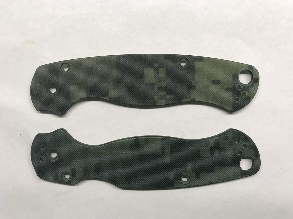

FWIW, and not sure if the pic will do it justice...
I used dark green RIT. Used the whole box in 32oz of water. Water looked almost black, so I decided to dilute it with another 32 ounces of water. Brought the water to boil, put the scales in, turned off the heat, let the scales sit for 30 minutes.
The main difference, what used to be beige is now green. Anything green is now darker green. And the scales absorbed the dye differently. Probably can't tell once on a knife. I will likely do it again to go darker. May even try different color.
If you go black, and want to maintain the camo pattern, I would cut the RIT amount by half. You can always go darker.
