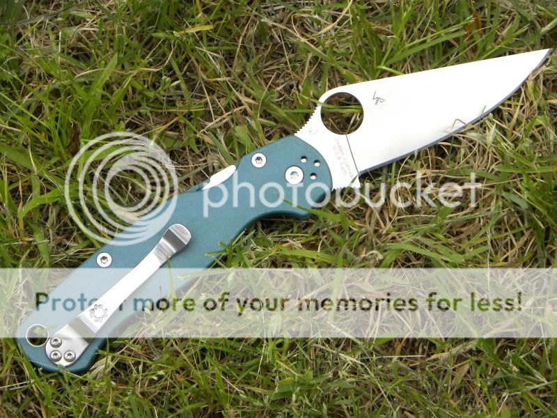

RIT dye remover will work on G10. I attempted to dye my grey Para-2 several times and that particular G10 just won't take hardly any coloring. I did get it to take a God-awful Sea-Foam green:
This guy is back to Grey, so I know it can be undone. Black however, is pretty dark, so I don't know what the results will be.
I actually like that color. Looks great to me.
