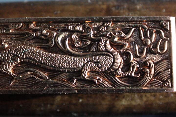

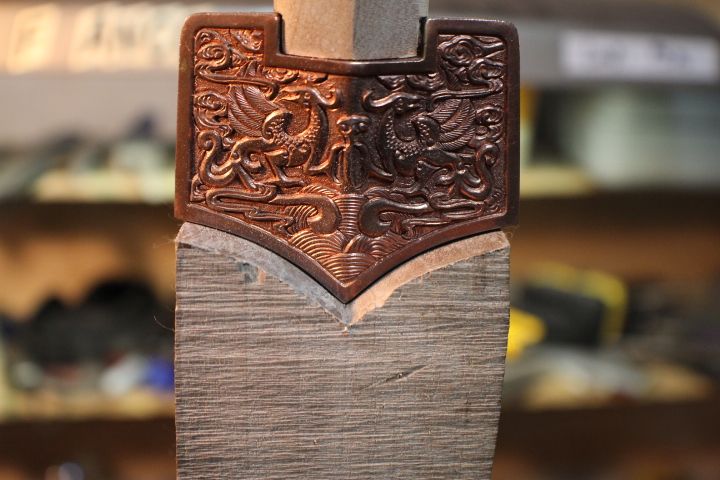

Here is a sneak peek at the guard. The fittings are amazing.

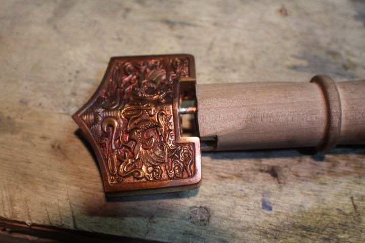

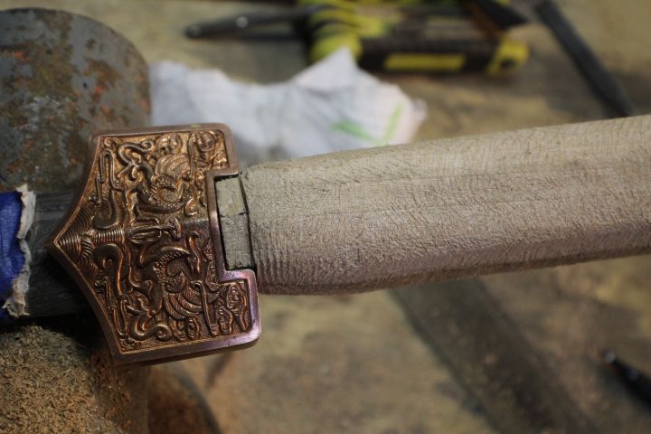

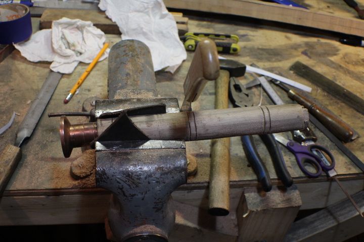

Fitting tenon of handle into the guard. Rough shaping at this point.

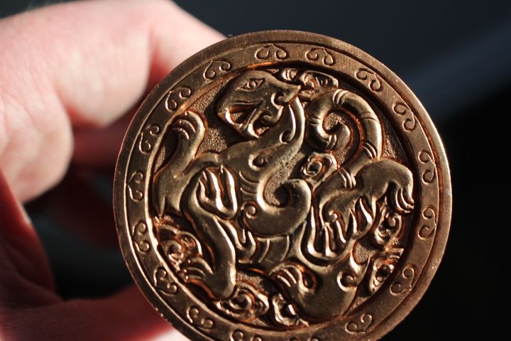

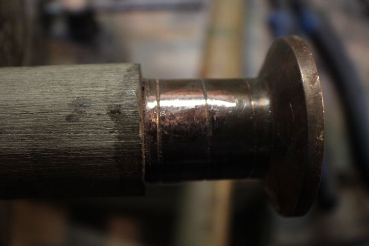

Pommel onto handle blank

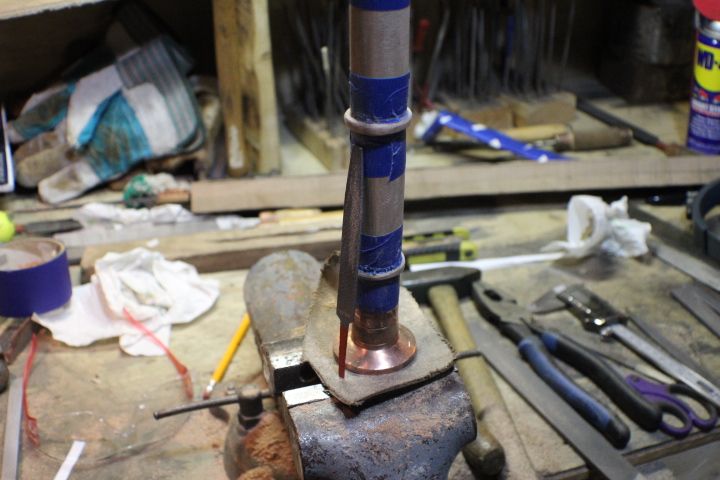

I don't have a lathe, so I am cutting with a Japanese backsaw to create the demarcation points where handle risers will be. I hope that makes sense, I am not sure it is English. There will be raised rings around the handle, and the handle will be round in cross-section (which appeared to be the style of the time).
I gotta get a lathe if I am going to do many of these. You know the routine, sell a sword, buy another tool.

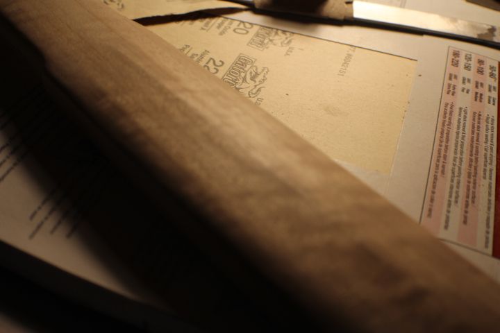

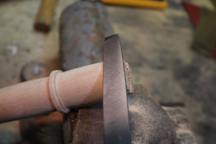

I removed all of the material with a cabinet maker's rasp from Germany (hand raised, great tool), and I am using a smooth-cut file to get the rasp marks out. Filing wood is relaxing and effective.

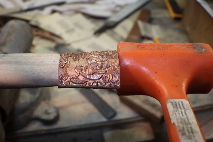

Pommel epoxied and pinned (invisible peened pin all the way through, made of same copper alloy). Here, I am about to file the handle rings to final shape and begin the polishing process. A smooth cut file, 8", leaves about the same finish as 320 grit abrasive paper, only the file leaves a burnished look that paper doesn't. I will use 400 and 600 grit after this. It is curly walnut by the way, and I am going to stain it with aqua fortis.

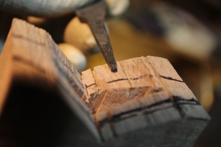

Inletting guard down into the throat of the sheath.
I do this with files, chisels, and rasps.
favorite little chisel working on inletting. It is, as you can easily see, a 6" file that had a high carbon tang. I made the tang of the file into a chisel that is about 3/32" wide. It works very well. I use a lot of files up, filing heat treated swords. So, I make most of my own tools (the ones I make) out of old files.

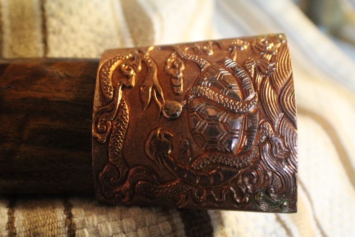

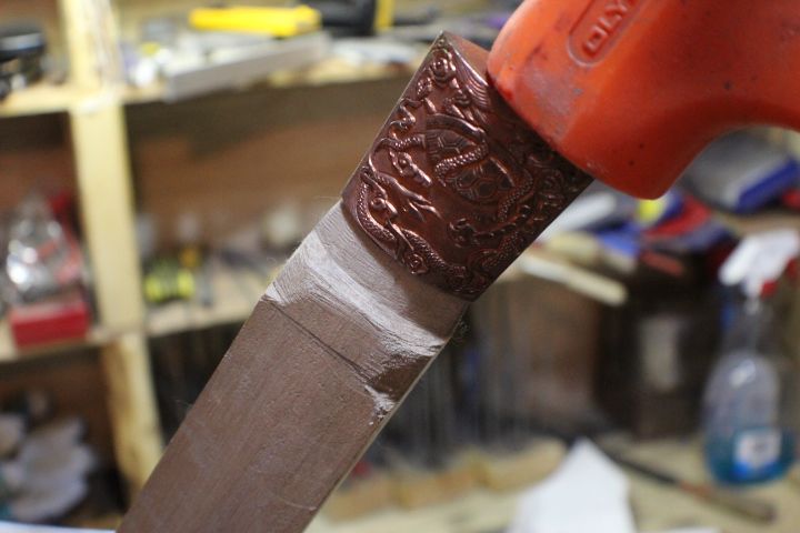

Fitting the chape to the sheath. This is where we stop, for now. Hopefully, more progress over the weekend.

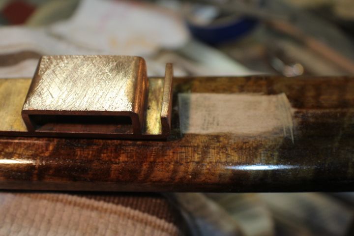

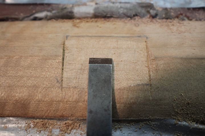

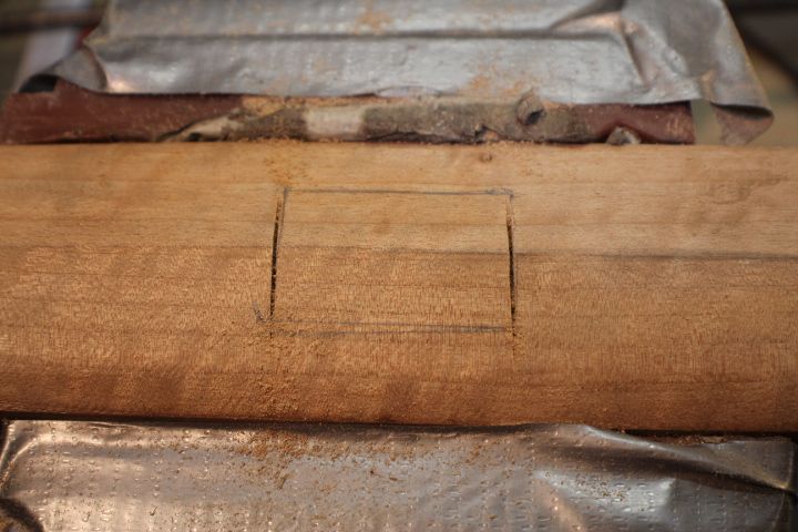

Here I am sawing the lines to then chisel between for an mounting for the scabbard slide.
Cleaning up the area.

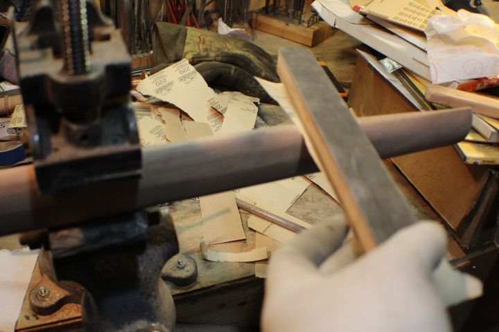

Using a Braun Block (from Ed) to sand the sheath. 100 grit paper and good backing, to get all the dips and stuff out.
These sheaths have a central ridge for most of the length that transitions to an oval near the chape.
Vise with neoprene on the jaws in a bullet vise, Braun block to sand.
More fitting of chape.

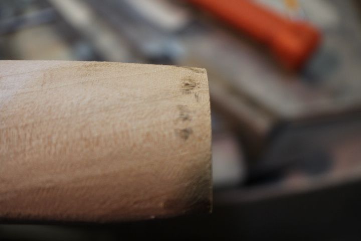

You can see the marks, where wood needs to be removed (and sometimes exactly opposite of there).

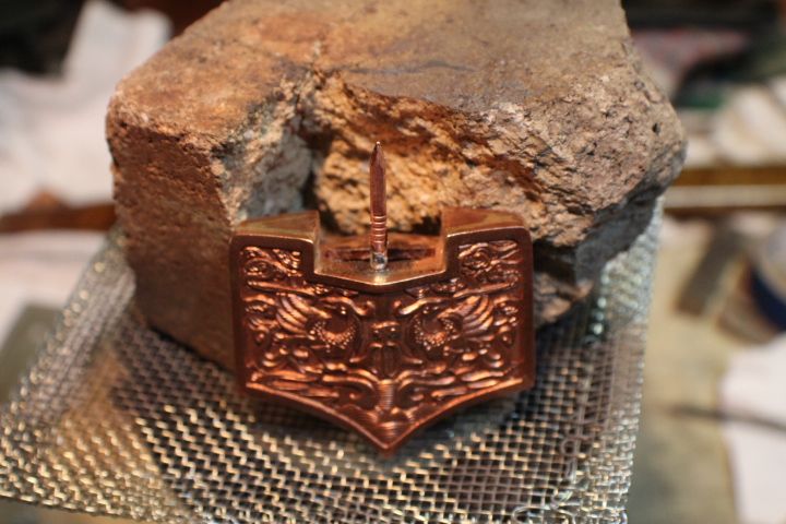

I soft-soldered (stay-brite) a hidden pin made from a copper nail into the guard. This is to make ultra-sure that the guard can't rattle, come what may.
Matching pinhole on the handle. Normally, you braze a ring to the guard, and then have the handle come inside that. This can keep the guard from moving. But, with these fittings, there wasn't enough room to use a ring like that, and have a tang that was very wide/thick. Therefore, I abandoned the ring, and you can see even the wood doesn't take up room on the sides of the handle. That leaves max room for tang, and the pin will take care of making doubly-certain that the guard can not rattle.
Surface prep for epoxying scabbard slide.

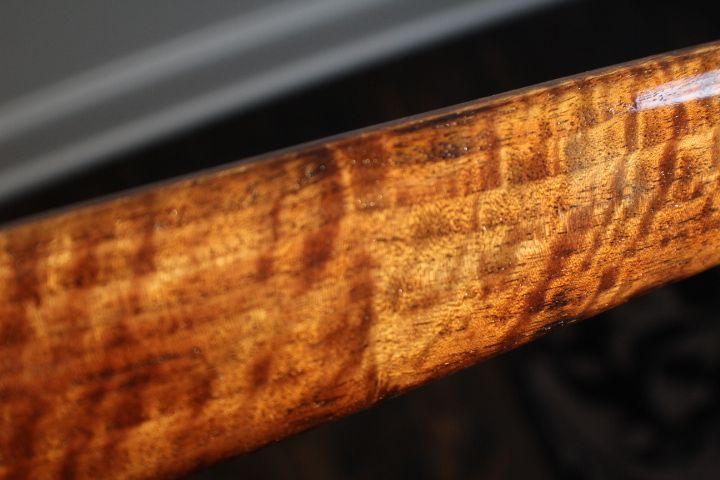

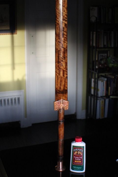

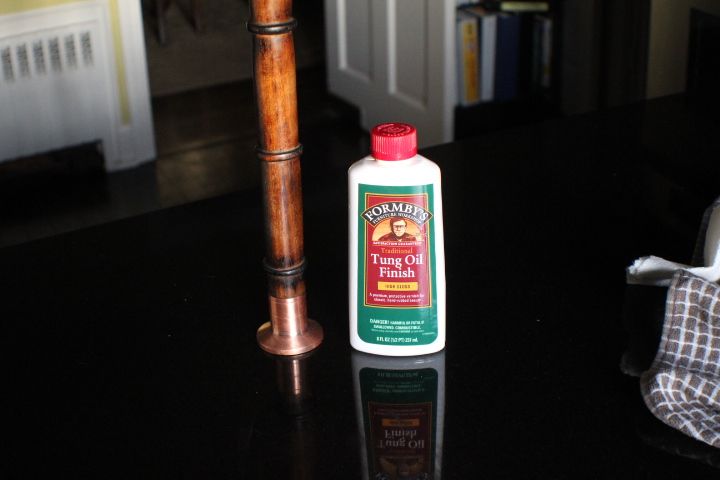

Here is a pic of the handle in place, but not pinned or epoxied. I am just looking to see if adjustments are needed. As you can see, I use tung oil. This stuff is great. Build it up slowly, in many layers. Wipe on, rub on. Let sit about 12 hours, repeat for several days. The sheath has a layer of tung oil that has filled the pores. It looks a little like a CA finish, only easier to do, and historically accurate.
Everything was stained with aqua fortis, which I learned from Alan, through this forum. I just buy Ferric Nitrate crystals and dissolve them in water. It is easier than nitric acid plus steel wool.

This is some of the most interesting walnut I have ever seen. Tung oil and AF go together so very well.
