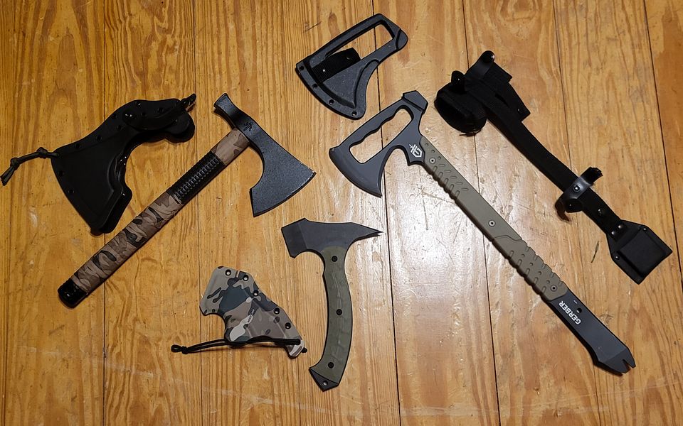

I have 4 rmj tomahawks including the one you speak of. The easiest way I have found to get them out is to put a shoulder strap on the sheath. When it's over your shoulder just give a hard jerk. It works for me.20260601_172919.jpg

I have this strap off of a 2 qt. canteen cover.
I used the existing holes in the scabbard. You all bump started some brain cells of mine. I'm going to be on the lookout for something similar in black though.
Thanks again!
That will work. Should lay nice a flat against your side, or lower back. Use a lot of caution when pulling it loose though, you aren’t leaving much room between the edge and your side - those hawks bite.
