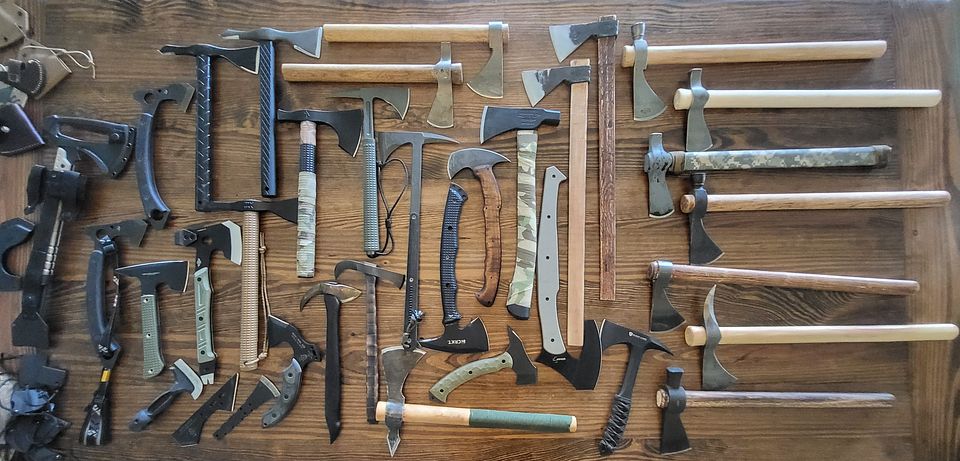

Can someone please tell me the difference between the RJM/ATC Model 1 and the Lagana model?ATCVD19.webps-l1600.webp
I noticed the head of the Lagana model doesn't have RJM USA cast into it but is there more?
Thank you to everyone in advance.
