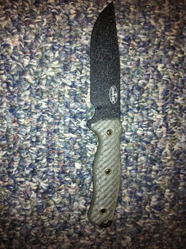

My first swamp rat has arrived and it is one of the nicest knives I own. It feels great in my hand. The only problem is that the blade is like a butter knife. So what do you guys recommend to sharpen as is and also a good sharpener when in the field. Or it seems like a lot of people are reprofiling the edge convexed. Is that the normal recommended way to go?
I was looking into getting the waki as well, but I'm just afraid of getting another expensive dull blade.
All in all I am happy to be joining the swamp rat family. I just need to give this knife the edge it deserves.
Thanks

I would try a diamond rod, or ceramic in a butchers steel motion before I sent it anywhere.
They make portable models for the field
You can also strop it if you have the set up for it.

It took me about 12 hours to get mine to the point where it was really sharp. It was shaving out of the box but the angle was just too obtuse for me. I took it from a 60 inclusive down to about a 15, and this is really how they should come from the factory. I stuck it out and it was worth it-the knife is just insane.

The knife comes at about 30 degrees, or 60 inclusive. I took mine down to 15 degrees, or 30 inclusive. My method was a 1x4 arkansas stone wrapped in 320 grit wet-and-dry sandpaper, worked on up to 2000 grit. I can't dull the thing now, it's awesome. Sure did take a long time to get to that point... if only Swamp Rat would consider thinning out the edge from the factory, I'd be much more inclined to spend more money on them. It sure is a hassle getting them sharp to begin with, but once they are there they stay that way.

I understand that we would all like sharp well ground knives out of the box but truth is its rare that it happens. When you put knives on big bench stones you quickly find that about 1% of knives are correctly sharpened, all the more reason to sharpen your knife as soon as you get it.

Even a simple $20 norton india stone will get your knife sharp in short time no need to ever send a knife back for sharpening and you can keep it sharp.

I think they do come with a fat edge on purpose. It is practicing CYA when you have a lifetime warranty. Most people that I know (average Joe) don't know what a sharp knife is and they beat the snot out of everything. These Rats are advertised as hard use blades and not capers. At $138 the RMD is way above its' competition and the folks that buy "survival" blades in that price range on average aren't really experienced users. Look at a Cold Steel or Fallkniven .... rubberish type handles made over seas for about the same prices. The FK has a nice convex but it won't hold up like a Swamp Rat ..... and most of those other blades don't have the Swamp Rat warranty. I can't think of any other company that offers blades with handles as trick as Swamp Rat for the money. I like to set my own edge bevels anyway and don't measure the angles. I thin out a section a little at a time until it cuts what I want how I want. Normally I leave half of the belly to the tip at the stock angle so that it stays tough.

That's why I would suggest to the OP that he take the opportunity to start learning how to reprofile an edge and properly sharpen a blade.
I know it can seem intimidating and frustrating when starting out, but once you get the hang of it, it is SOOOOO satisfying to know that you have the skill to put the kind of edge you want on any blade! :thumbup:
I know it's the first thing I do when I get a new knife. I actually look forward to it! ...True that SR-101 is tough stuff, so it can take some work to reprofile, but as stated before once you get it sharp it STAYS sharp for quite a while! ;)

I usually recommend that people start out with a cheap Buck knife and some plain old sharpening stones. Sure you're going to bugger it up, but that HC120 is pretty forgiving, and in a worst-case scenario, you're out what? $30? It's priceless experience, and you'll appreciate that Lansky set with the diamond stones a whole lot more afterwards.
