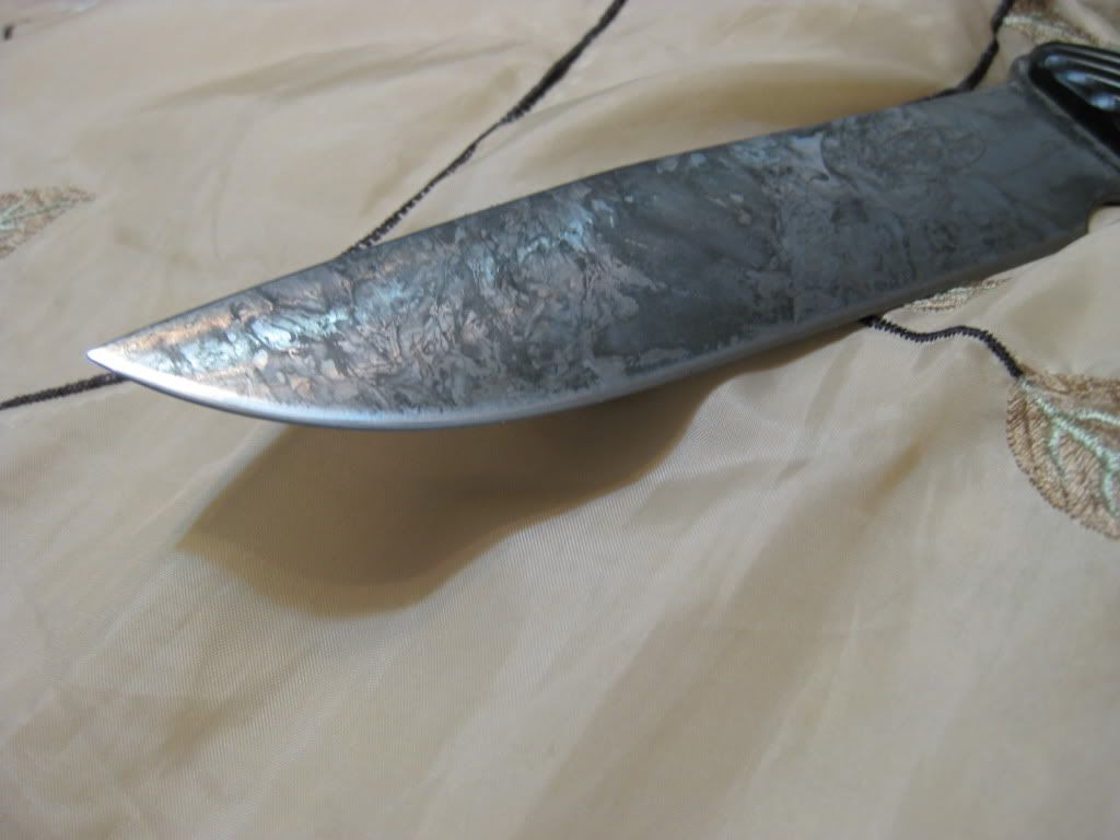

Here is some pics of a RatManDuex LE that I did a grapefruit patina. I like the random pattern that it gives. Make sure that it is completely oil free and compress between grapefruit halves for maybe 30-45 minutes.
That looks nice. What are the different benefits between patina and the clear coat?
Lemons work and so do tomatoes.....and just use the knife already! Anything short of a deep scratch will buff out. Unless you're chucking it down the street lashed to a pole, it won't scratch beyond fine lines. Remember it's a tool. USE IT. Wipe it with Rem Oil or beaver fat or crisco if you're worried....
For me, a patina is mostly about the look and making the knife special to myself. I don't believe it greatly adds to the corrosion protection, same with blueing. Your just speeding up what will happen naturaly and choosing a pattern. Wiping with mineral oil after use is your best protection. My guess is that clearcoat would wear and chip with use and then a patina would develop in the bare spots, ending up fugly. But I've never tried it.
