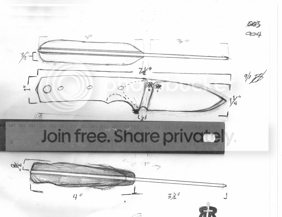

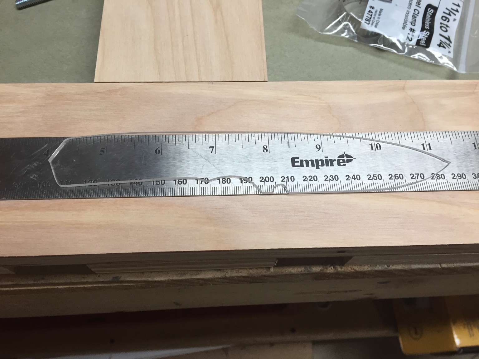

Little quick background. 1st knife build, using 1084. I'm making the knife, wife is making the sheaths, these will be Christmas presents for Friends/Family.
Design inspirations:
Aaron Gough Resolute - General Shape and index finger handle recess
L.T. Wright Next Gen - Size and thumb recesses
Woodlore Clones - Handle shape (I also have a typical "broomstick" handle drawn too)
Dimensions:
7.5" Overall
Handle: 4"
Blade: 3.5"
Sharpened Blade area: 3"
Fero Rod notch area: 1/4"
Any thoughts / Changes before I get to far?
I have yet to draw up a sample with a belly on the handle, I know that might be a recommendation.
I DO have a belly sample drawn out on a pice of plexiglass I'm going to cut out for a template though :D
I wouldn't round the butt off like in the top pick. I would move the lanyard tube up or down(I prefer up, just leave it 1/4" or so from the edge) and then spread your pins out til they look right. I would also lose the point on the butt. Other than that it looks good. Get after it and good luck!
Thanks Matt. I'm leaning more towards the "Coke bottle" handle sofa, but good call on the Broomstick handle. I'll also figure out a new spot for the lanyard hole, as your post reminded me that a lot of people offset the hole so the blade hangs away.

3/8" is good. With the tang that's 7/8". I usually end up near a 1/4" by the time I'm through. Stabilized is good since you won't have to mess with any finishing. Just sand up to 1500 or so and buff if you want it to shine. Leave it if you don't. You can also just use some naturally oily wood like rosewood, ironwood, etc.. I treat them like stabilized woods. If you have a local Woodcraft store you can find them. I got a piece of bocote and Bolivian rosewood for $36 and will probably get 10 sets of scales out of them. $3 a pop ain't bad.
I like the side profile and the changes proposed for the handle. My thought would be to trace your profile on a piece of thin plywood and cut it out. You can glue additional pieces to the handle area to give the thickness you need. You can then shape the handle and see what it feels like in your hand. I personally like at least a 4 1/2" handle on a hunter. Everyone's hands are different you might like something different.
Im just a hack but the point looks low to me. It would look more in line perhaps if you took that ruler centered through the pins and established the point there. It's not something I have done before but I read it on here somewhere. I've been reading a lot about knife design lately. Might not hurt to try.
And most people would recommend 2 pins instead of 3 for a first knife.

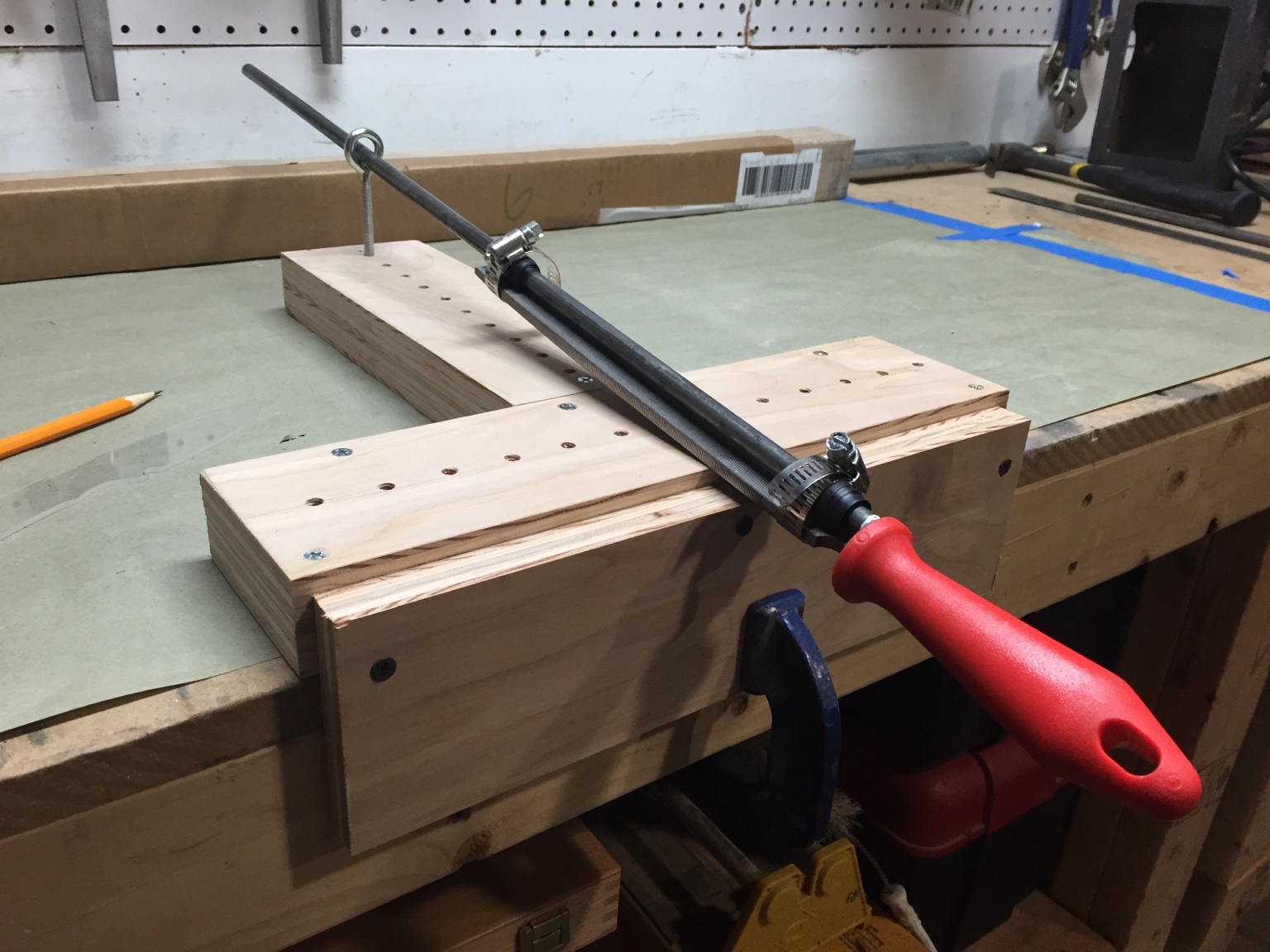

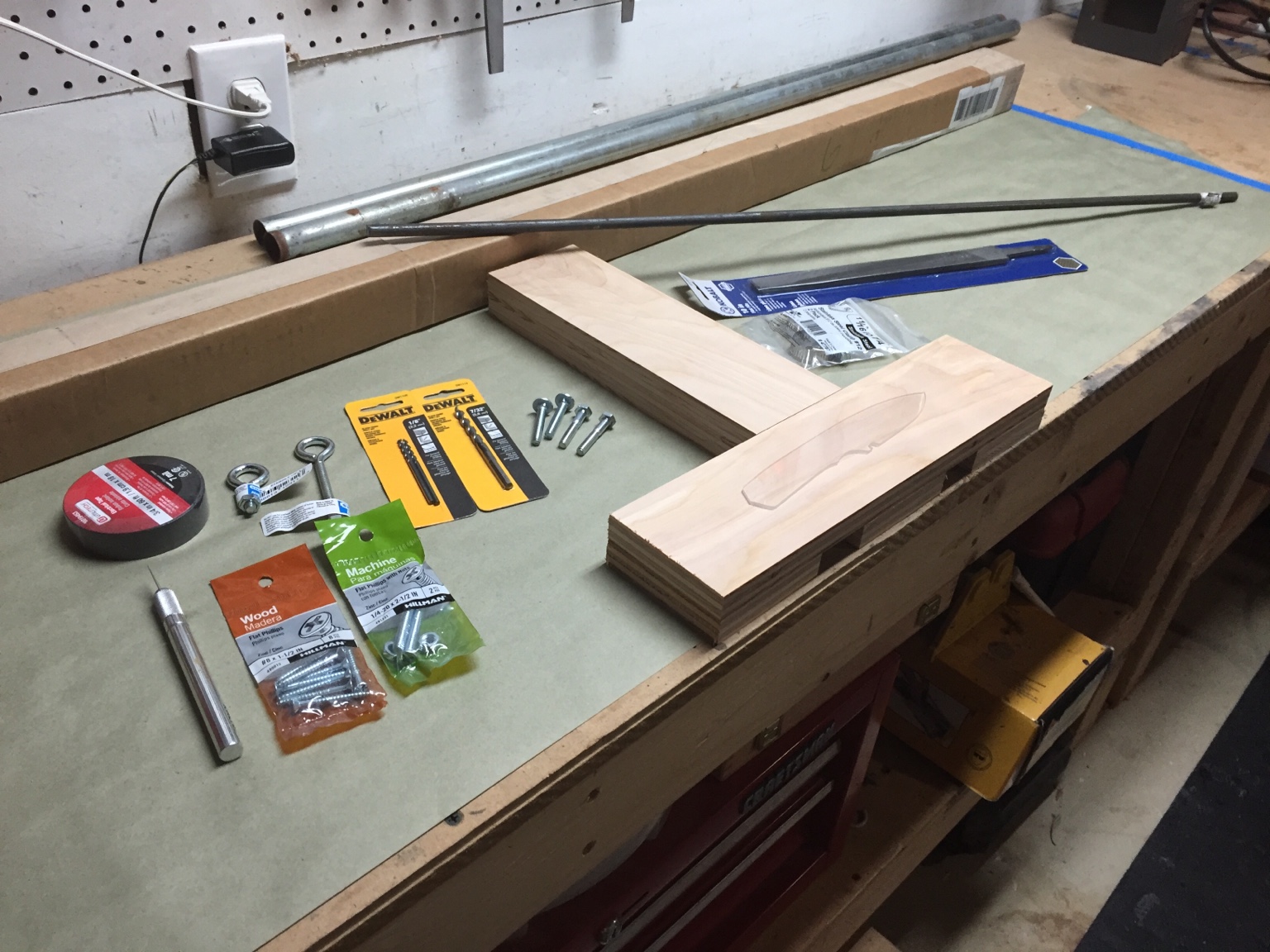

Thanks for the replies everyone! Time to get this party started. Steel is here! 1st up, I'll be building my Aaron Gough style filing jig, then we'll start cutting out some blanks!

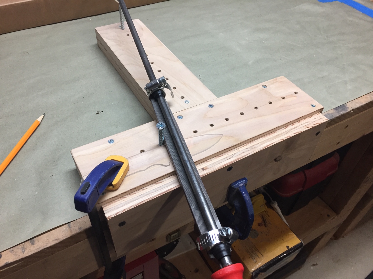

It is finished.
2 modifications to Aaron Goughs jig.
1. Added blocks under the "wings" of the jig to make them solid.
2. Added a skirt to the jig to hook it to the bench. The skirts is lowered enough so the file clears it at its most extreme angle.
Tomorrow I'll try laying and cutting out the rough blanks!

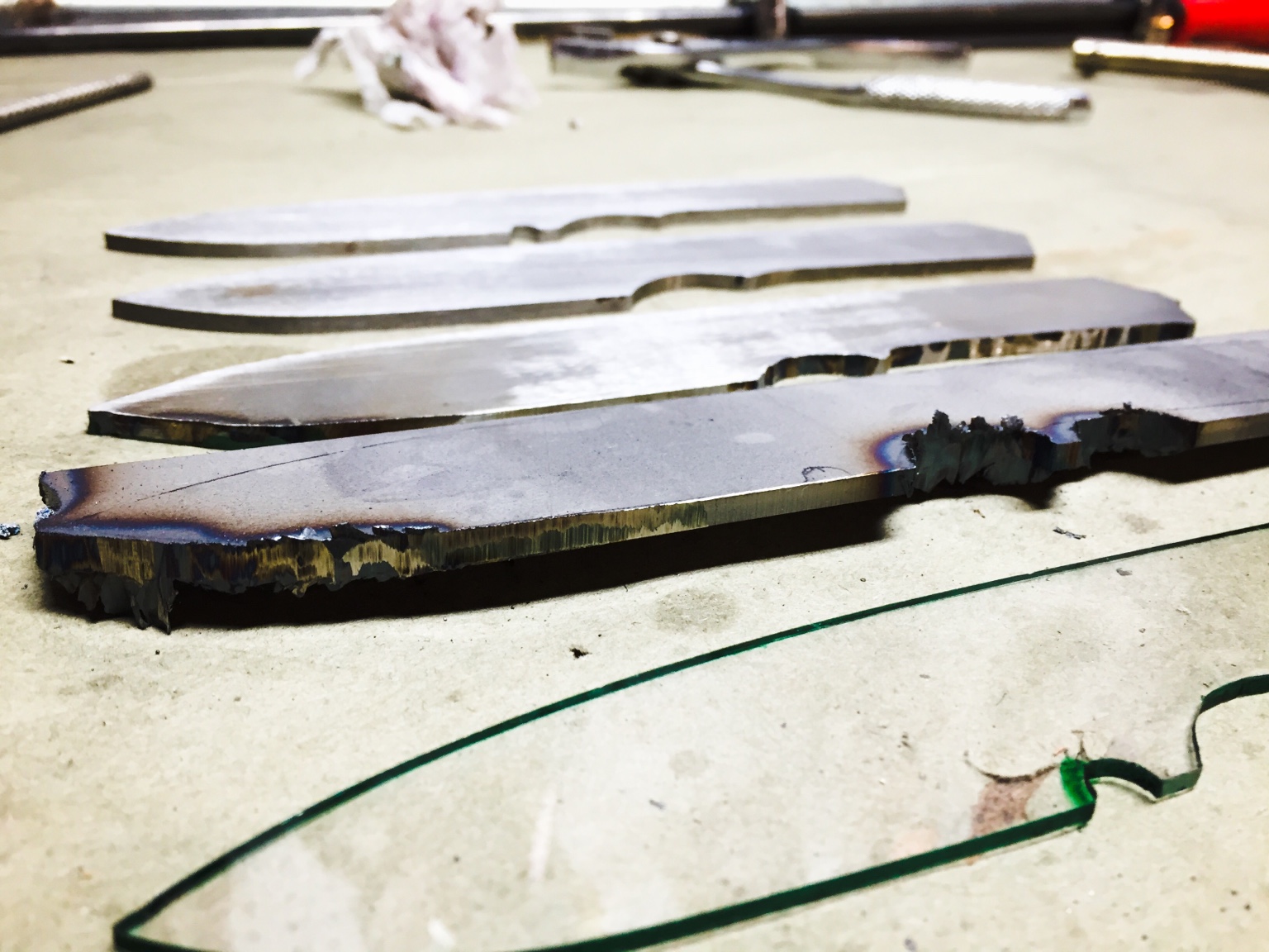

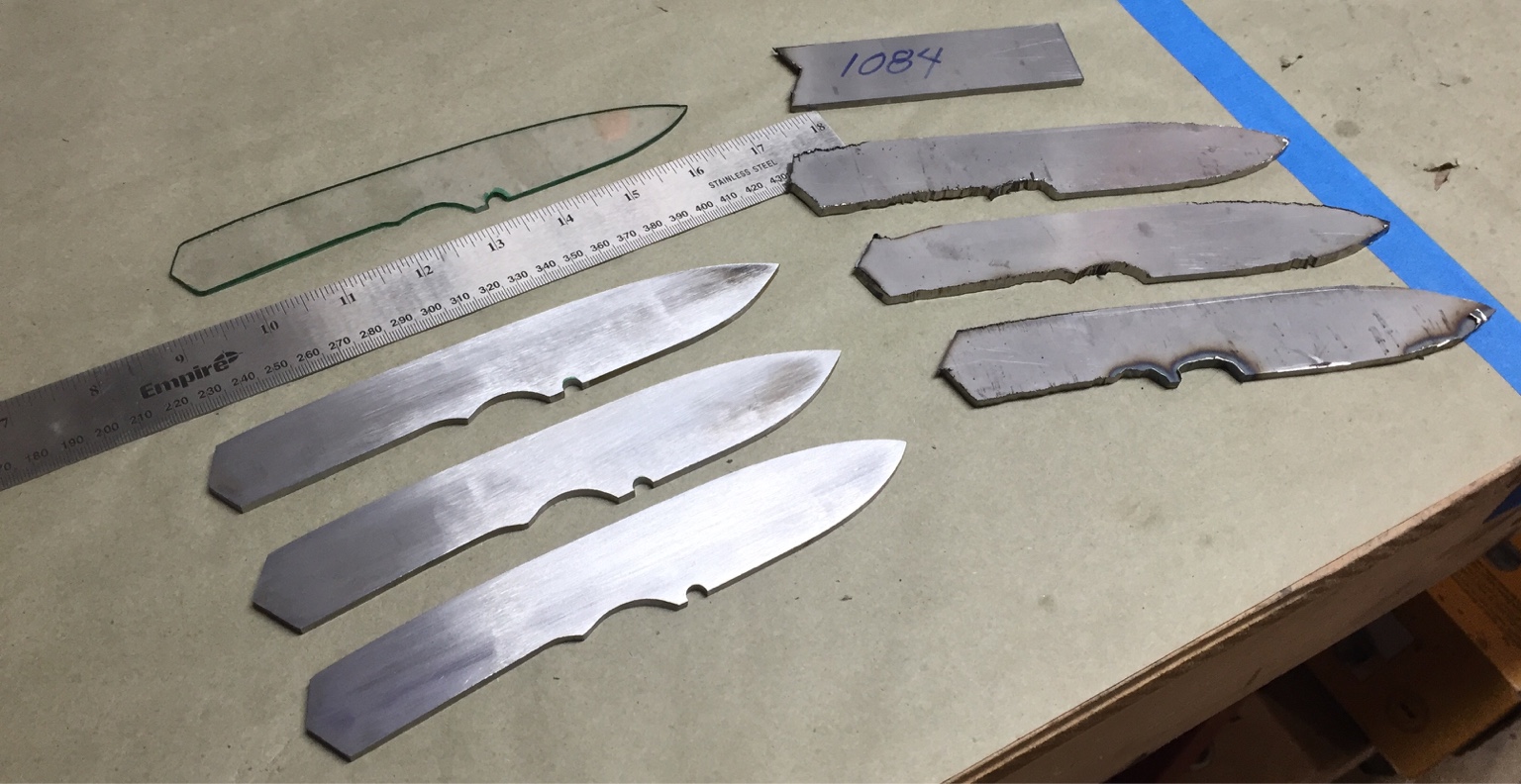

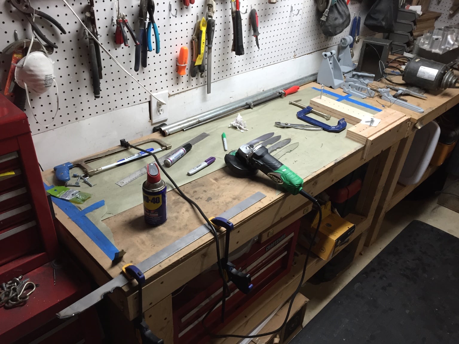

Marked out all six blades on the 48" piece of 1084 and cut the 1st one off with an angle grinder
. Eyes/Ears/Lung protection were in effect.

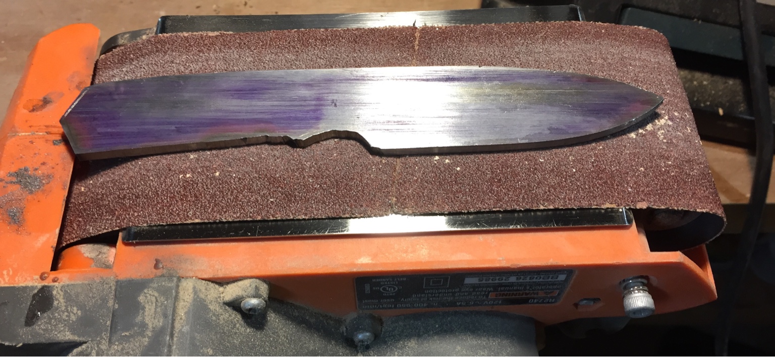

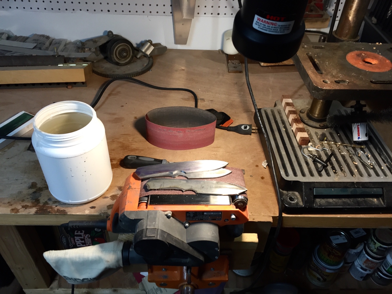

1st blank off the bar and onto my 18" Rigid belt sander.

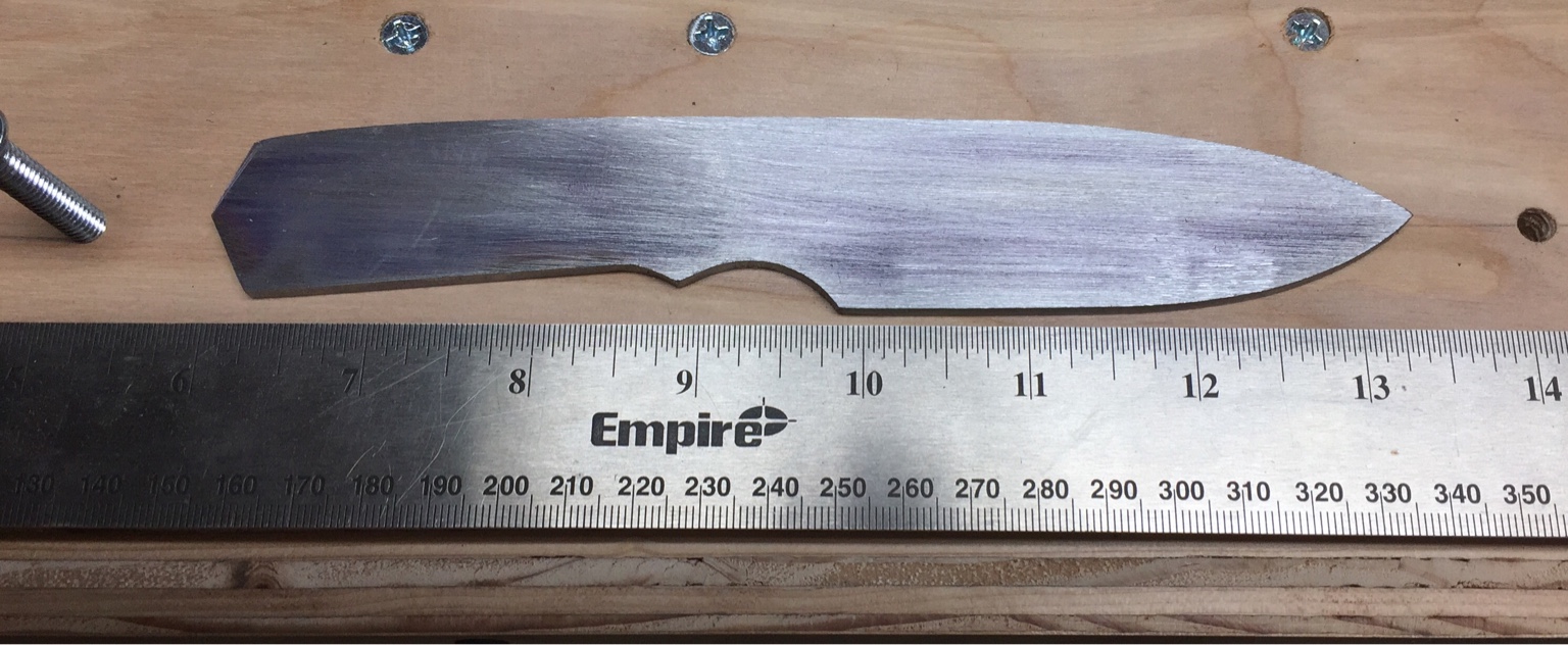

Rough profile is 95% complete. I still need to take some off of the upper rear end of the knife handle to make it look right.
The front wheel on the 18" belt grinder worked pretty good for the pointer finger relief.
Stay tuned for more, and feel free to offer any tips/suggestions along the way.
It's going to look like this for a few more evenings. 3 cut out, three to go! I have to say, that I'm pretty happy with the 18" belt sander so far. Will update when I have all 6 rough profiled.

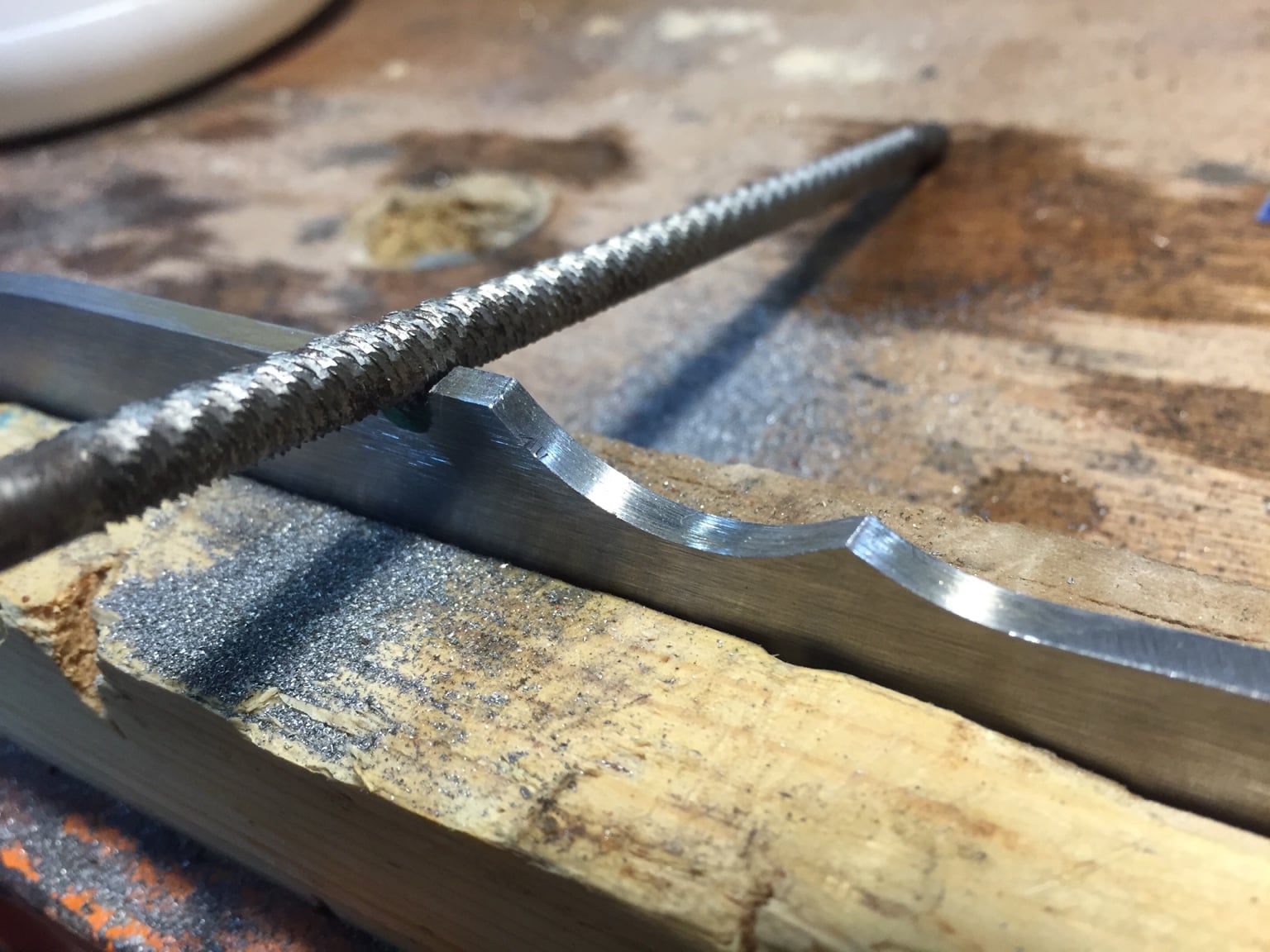

Haven't marked out pin/lanyard holes yet, but I had to test out the grinding jig.
Grinding jig works pretty good. Thanks Aaron Gough!
On the next knife I'll try to center the plunge line in the choil. This one went back further than I wanted.
