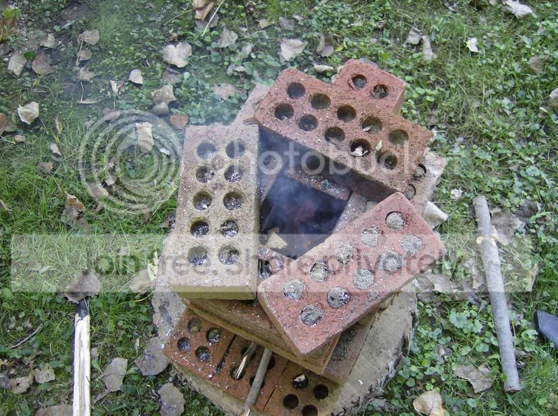

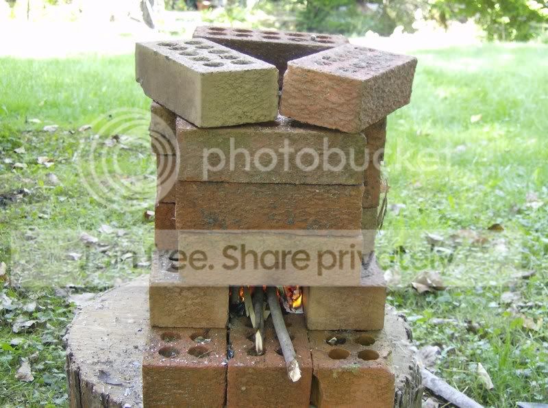

This was my crude attempt at a "Rocket Stove" from the previous thread on them. Worked very well but I am going to build a cleaner/more portable one from a old popcorn tin.
I do plan to build a nice brick one near the fire pit. Would be an awesome way to cook some food during bonfire nights.

The idea behind the "Rocket" stove is to insulate the chimney area (be it with bricks or some type of insulation in a can set up) and focus the heat right on top. The fire creates a draft coming through the system and burns HOT. It's very efficient.
