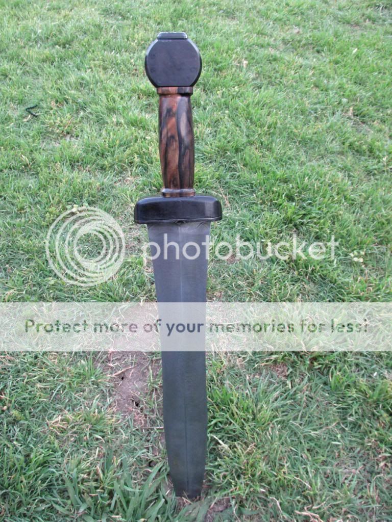

Here's a few pics of a sword build I'm finishing up. A friend & neighbor was interested in having his Albion blade (5160 steel) made
into a finished sword so... I constructed a guard from 1095 steel and a great piece of dark black ebony.
The handle is stabilized black & white ebony and the pommel is five layers of 1095 steel and is peened together with 8 pins.
All of the steel was heat treated and heat blued for a nice, battle-worn patina. Just needs a peen block and peening to be complete.
The steel adds just enough weight to make this feel really substantial in the hand. The balance point is ~ 1" off the front of the guard.
Gerry at Exotic Woods USA was great about finding me with some really nice ebony at a really good price so check him out
if you're in the market for hardwoods www.exoticwoodsusa.com Thanks Gerry.
This is my first sword project so I welcome your comments. Thanks for looking.
I might have sanded out the mill marks; just my opinion. Overall it does look nice and serviceable though.
Did you sharpen it and do the heat treat yourself? I know you can get them from Albion heat treated. I have their riding sword blade I need to hilt up.
Are you worried about the handle cracking when you hammer the peen in place?

Hi Gregorio. I certainly understand your point. I was prepared to hand finish the blade but after etching the blade with FC acid and sanding w/ 1500 grit, it gave a nice "french engraved" sort of look that the customer and I both really liked. The blade came HT'd (Albion used HT salts). I did re-temper the tang for my own peace of mind and annealed it on the end. The tang has shoulders that taper down inside the pommel. I taper fit the inside of the pommel so that the shoulders on the tang will absorb all of the peening blows. Not sharpened yet - I asked him to spend some time getting used to it first before we sharpen.
My only complaint with the blade would have been a few places where the mill dug a little deeper and created gouges that would have been a pain to remove if we'd gone with a finer finish. Anyone buying a blade from Albion might want to mention that when ordering from them.

I like the filework a lot too. Simple, yet accentuates the curves nicely, and very aesthetically pleasing placement, IMO. Nice work! I also like the milling marks. Gives it a good character.
Interesting. It looks more Xiphosish now than a Gladius like and being a purist I of course would have liked a mainz style blade to become a mainz gladius. Of course that's been done to death and it's not my blade, if your customer is happy that's great, and it does look like good work.
I like the milling marks. Makes it look like something a legionaire would have actually used.
Me too...I like the stuff that looks like someone would have actually USED it in battle not the super fancy bright shiny "show" stuff. I love it to be honest!
Thanks guys. The customer and I both agreed that it needed to look "battle-tested" & something with a story behind it.
