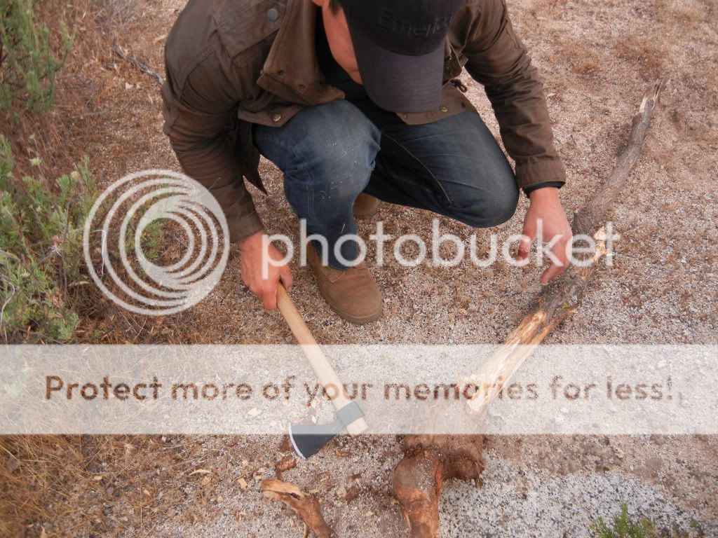

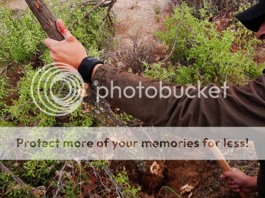

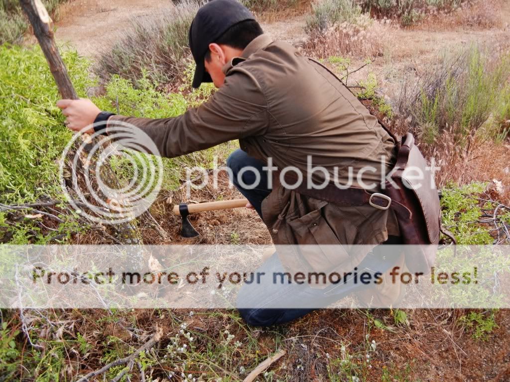

I’m heading out to my family’s ranch today, im going hunting for a piece of wood that can be made in to a ball club. It is a desert environment and there are a lot of shrubs and trees to look at. I will post some pictures of my field trip. I found a few Indian artifacts at my family’s ranch over the years, a few arrow heads and grinding holes scattered in the rocks I will post some pictures of does as well. It rained all night, might of unearth some nice arrow heads or clay pottery pieces.
Found this small tree that has a good size root ball. I’m not sure what type of tree this is, the wood seems hard. It was very hard to get out of the ground. My cut up thumb wasn’t helping.
It has a pretty good size ball. It’s my first time doing something like this. I’m going to remove the rest of the bark tomorrow. Anything I can do to help dry out the wood?
