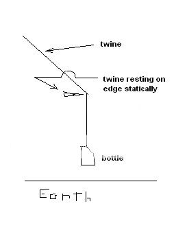

Thanks for the reply, Mike. I'm still trying to visualize it. It would be easy with a drawing. Is this the condition at the start of the slice?
So the edge was statically supporting the weight of the bottle, and then you would do the slicing motion and watch (and record) where the twine broke.
Do you think measuring like this at a slow slice speed will measure the same "slicing ability" (your sharpness) as the faster & harder slice it takes to cut the manilla rope? I am still thinking about how this affects the conclusion that can be made.

Actually, the edge was pointing straight up, but that is the general idea in the picture. Care has to be taken not to add tension with the hand holding the end of the twine. I kept my hand at the same height as the edge, so the twine was at a parallel angle to the ground (vertical from the ground to the edge, then horizontal to my hand) and not going towards the ground adding more tension. When you add tension with the holding hand the twine is cut with less edge length, but after several trial runs for practice I got to feeling comfortable with my consistency with my technique. I'm not sure if that is how Cliff does it (with the edge vertical or not), but I figured that way the edge was supporting the full weight of the bottle and I got consistent results with that technique, so that is what I did. Any input on how to improve my technique on this type of measurement is appreciated, as again this was my first test of this type and I am trying to learn.
I think this type of measurement correlates well with the rope slicing ability, as the cuts on the rope took more and more force and weren't as clean as the results on twine cutting got worse. The twine testing also correlated well with the loss of ability to push cut and slice newsprint and shave, which are pretty standard "layman's" tests of sharpness, along with feeling for smoothing of the edge with the finger pads. Of course, it is very hard to quantify the "layman's" tests for any statistical analysis. For the purposes of this test I think the twine testing worked very well, and the numbers and my "layman's" tests told me that both steels (as done on these knives) were perfoming pretty much identically for me when cutting that rope. Again, this was my first measured test, so I know there was room for improvement in my technique and methods, but the results were pretty consistent for me from run to run and that makes me think my method was pretty solid on this test. I would have loved to do more testing, and hope to add more knives with the same type of testing in the future to see how S30V and other steels compare to my results here, but this testing is very labor intensive and tiring, along with taking a lot of time. Having a young family and a high hour job limits my free time for testing like this. Hopefully soon there will be future tests posted on these knives so I can see how other's testing comes out for these 2 knives and how it correlates with my testing.

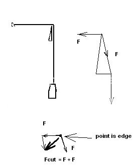

I'll try again - I should have drawn this the first time, because it makes more sense than my previous dwg:
So the force at the edge is adding the vectors F and F, both of which are the tension on the string (= weight of bottle). And the force that is making the cut on the edge of the knife is at a roughly 45 deg angle to the knife edge (depending on exact angles). The force will vary a little if the angles change, but not much. Quite honestly I don't know how much the direction of force making the cut really matters, but wanted to point out that the cut is not being made with a force perpindicular to the edge.
Another issue that comes to my geeky mind is at the beginning of the test, when the edge is sharper (push cutting), is some amount of twine cutting being done prior to the slice? If yes, at the beginning of the test there may be more of a push cutting factor to this measurement, and as the edge gets duller this factor decreases and it becomes more slicing. just conjecture...
I do not doubt the correlations you mention, but I do not think I would be comfortable assuming equality between this measurement and manilla rope slicing without data that showed there is equality (or a direct correlation) between them. To me there are too many differences in the two cuts to just assume a direct correlation.
All that said, your results look consistent and seem to provide a decent measure of comparison for these blades. While I prefer the tests where the measurements are taken directly from the cutting of the rope that is causing the edge degradation (Wilson & Goddard), I think your test would be a heck of a lot easier for the average guy to keep consistent.
