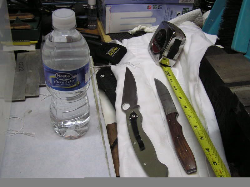

Well, here we are. I'm not as far along as I would like, but I think I have the testing procedures worked out, so I thought I'd show them and see what you all think.

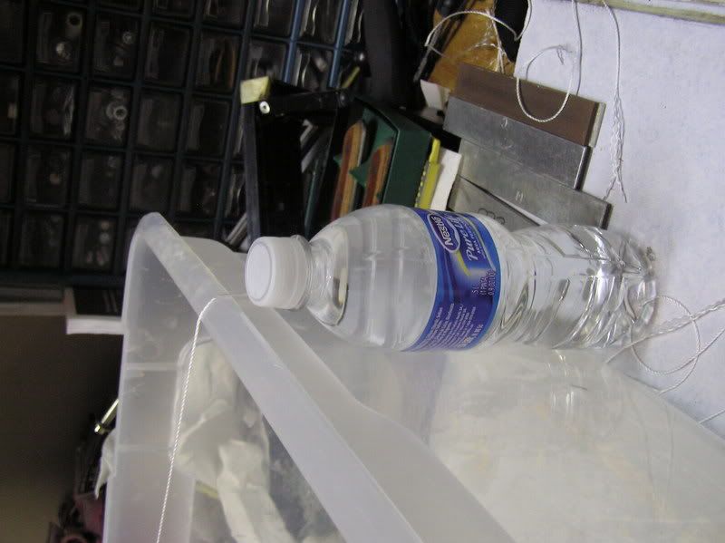

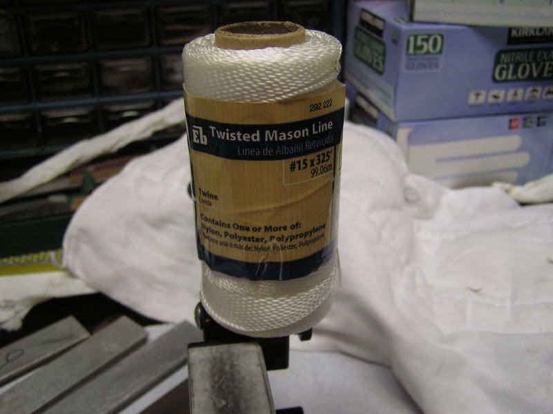

I'm going to follow Gunmike1's lead and stretch some thread/twine across a plastic bucket, holding it on one end with a water bottle tied to the other. I can lift the water bottle a repeatable distance, to the lip of the bucket, and slip the knife under the thread, pick it up about a quarter of an inch (this is the most variable part) and draw/slice the thread towards me. Here are some pictures of how it will work, the thread is from Home Depot, SKU 292 222 twisted mason line. I'll be cutting 5/8 manilla from Lowe's, and will get the SKU in a couple of days when I run out and need to buy some more. I have the knives marked every quarter of an inch, so my precision will be to the nearest eighth of an inch.
The thread:
http://i137.photobucket.com/albums/q203/sodak_photos/p1010578.jpg
The knives:
http://i137.photobucket.com/albums/q203/sodak_photos/p1010579.jpg
The highly calibrated weight:
http://i137.photobucket.com/albums/q203/sodak_photos/p1010583.jpg
The technique:
http://i137.photobucket.com/albums/q203/sodak_photos/p1010582.jpg
I am going to do a run with the knives as is - Gunmike1 knows how to sharpen them, and then I'll standardize the bevel on my Edgepro for both of them, and do 3 runs coarse, 3 runs smooth, then start thinning the bevel.
Sodak,
Do you mean lift the thread up, or lift the bottle up a quarter inch?
From the pic it looks like you are lifting the thread up a quarter inch, so I think the force of the cut will be dependent on the distance you lift the thread, or more accurately stated by the tension on the string and the angle of the thread on each side. I think how close to the edge (either edge) of the tub you place the knife may also affect the force of the cut (not sure, and too late to get the HP out). I would suggest making every cut in the same location of the tub, and you could argue that each cut used the same force better if you had a jig (or something) to help ensure you lift the cord equally high for each test cut. I do not know how cord stretch affects this, but if you can get equal force for each cut I think it wouldn't make a difference. Good luck.
Lift the thread with the knife. You're right this is one of the larger variables that I'm running in to. I tried to rig up a ruler of sorts to measure the "lift", but it got too time consuming. If you lift too much, you essentially just cause a lot of tension between the holding hand and the blade, negating the "standardized weight". I'm trying to eyeball it carefully and be consistent, and am finding out it takes a few runs to really make things repeatable.

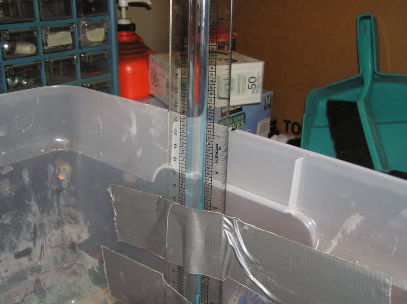

How about putting something in the tub for the spine of the knife to rest on that way you're always at the same level of lift. Heck you could even use a ruler and then measure by how much the knife is moved on it.

If you are worried about the height you are lifting being repeatable, you could add a ruller into the setup. Just hold the ruler next the string, and watch as you lift.

I was trying to come up with a quick stand to set the ruler in, but was thinking about it too hard - duct tape, of course! The force that binds the universe together! :D
http://i137.photobucket.com/albums/q203/sodak_photos/p1010584.jpg
I marked it on the 6, and marked the other side of the tub where I hold the string to it, so now the only (really significant) variable is measuring the length of edge, which is always the challenge.... As you can tell from the pictures, I'm accustomed to working in clean rooms with highly sensitive apparatus....
