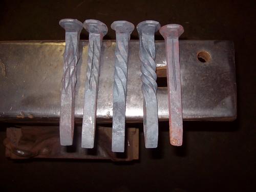

Forged this up tonight for a sword I am working on. here you go Patrice :)

I'm assuming the rope is several strands twisted together. Did you forge-weld the ends, or somehow cut the strands into the middle a solid bar???

You chiseled some deep grooves down the center of the four sides of the bar, lightly knocked off the four corners, then twisted it all to give the illusion of a multi-strand "braid" or twist??? :confused:
Your scale and movement of curves and spirals from one end of the guard to the other is spot on. Well done! Hows the fit on the tang? I'm guessing you punched and drifted that too?

This how it was done, the only reason I know is that I saw it done before by someone else but it wasn't done as well as this one. Its darn near perfect:thumbup:
Phil's read a couple blacksmithing books :D He and Unky are right, I drew a taper, then knocked in the corners then chiseled in a groove on all 4 flats then twisted, it is a very neat effect (and no forge welding needed :)).

Mostly, I just look at the pictures. I've dabbled around with the pineapple twist, so I was familiar with the look from that process. Here's a snapshot of the pineapple twist steps from someones flicker...
