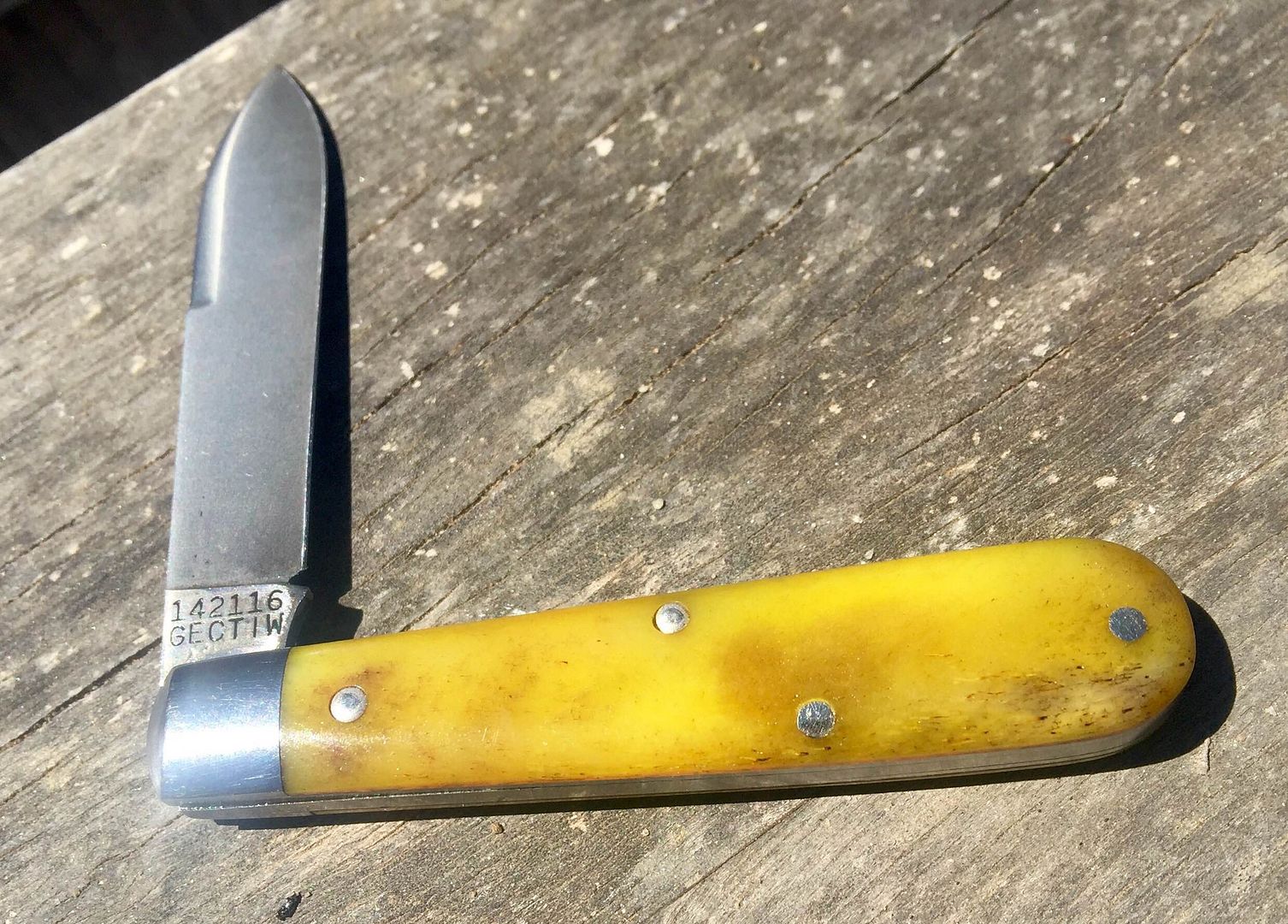

I was 100% happy with the smooth RBB I received right out of the tube. It was not as rotten as the few pictures that float around the forum but in no way was the knife just plain yellow either. I have no prior experience modding traditionals and had never attempted to modify bovine scales before this endeavor. That being said the RBB was one of a very few variations in color that I felt comfortable attempting to modify as the combination of color and pattern would be far more forgiving then most.

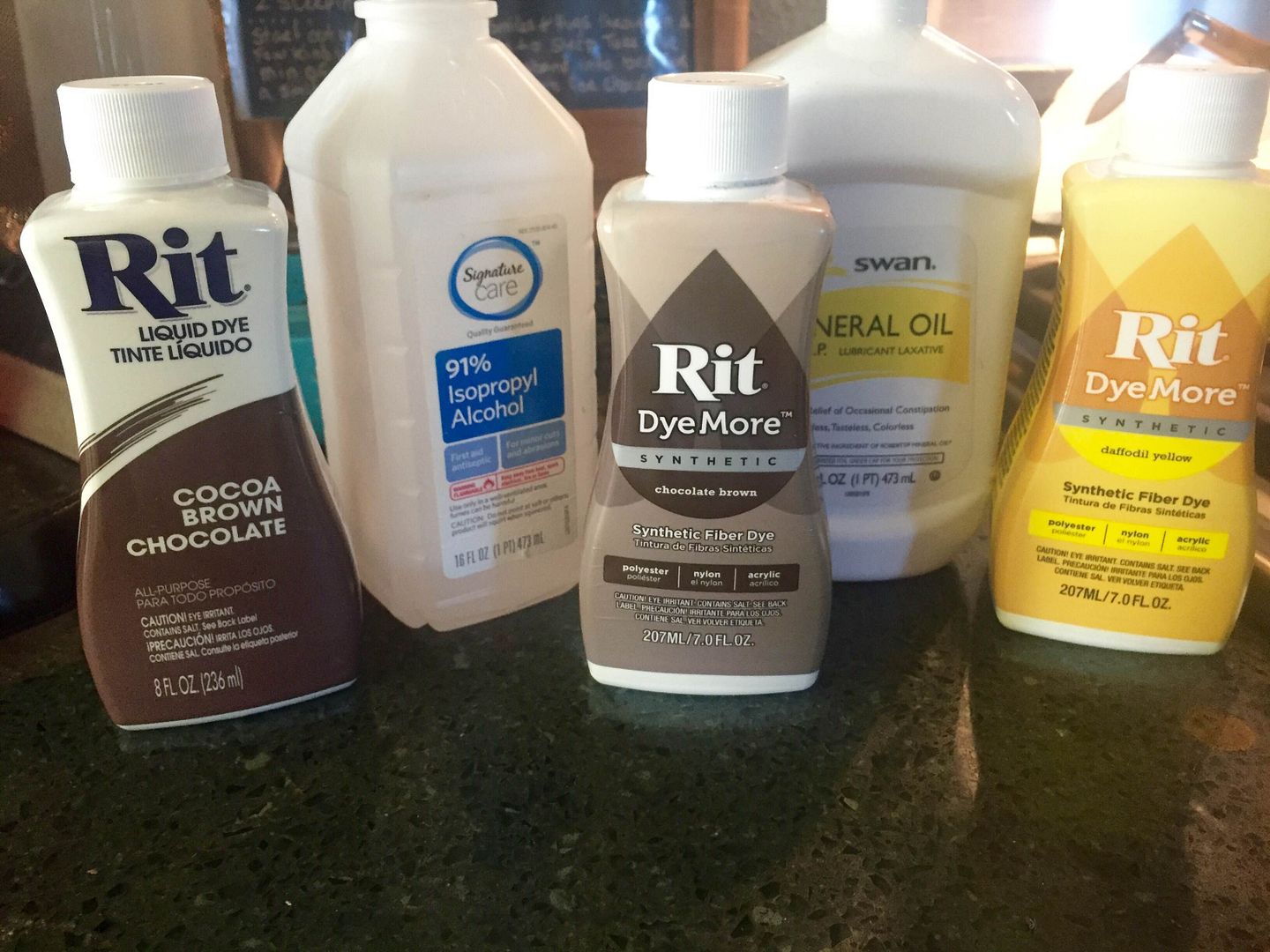

Here's a picture of the various liquids used in the process.
I started with chocolate brown RIT dye which is a darker brown not to be confused with coco brown which is lighter. I mixed some dye( about a two second pour) a half cup of water and two drops of dish soap and brought it to a simmer. While this was heating up I put on gloves and wiped down the scales with rubbing alcohol to de grease them. I placed the cleaned knife on a few paper towels and readied some q-tips. Once the solution was simmering I used the q-tip to apply some drops of dye to the bone.

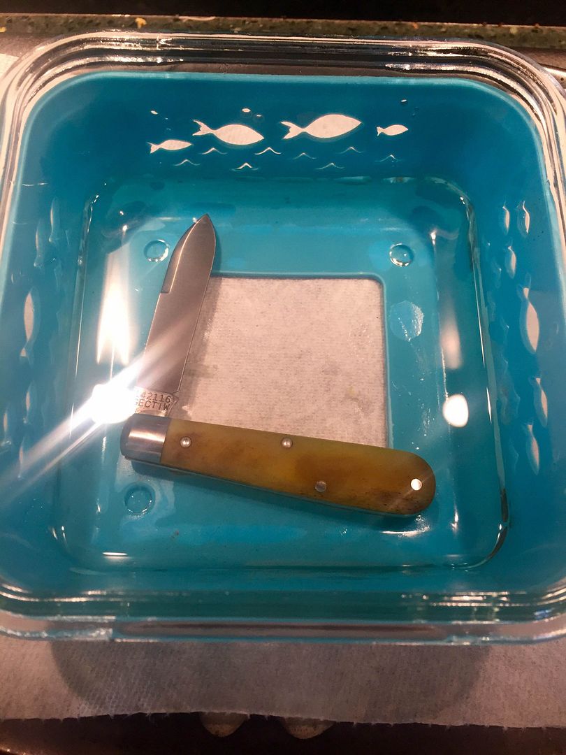

I repeated this process with the chocolate brown until there were some noticeable bruises. At this point I cleaned the knife with soap and warm water and then gave it a fifteen minute bath in food grade mineral oil. After the bath I let the oil drain for about 30 minutes and wiped the knife down. This is where I will give you my lesson learned on this portion of the process. Don't give your knife the oil bath until you are completely satisfied with the new color. This was trial and error for me and adding more dye after an oil bath is possible but a lot more challenging as the bone soaks it up.
Another note on the oil bath is that while some parts of the bone don't take well to dye the scale as a whole will really take up the oil. These oil treatments will make the original color ( yellow in this case) darker and more translucent. This gave me a good understanding of both smooth oiled bone and smooth ivory bone. If you want the color darker give consecutive baths but let the bone sit and fully Take in the oil first.

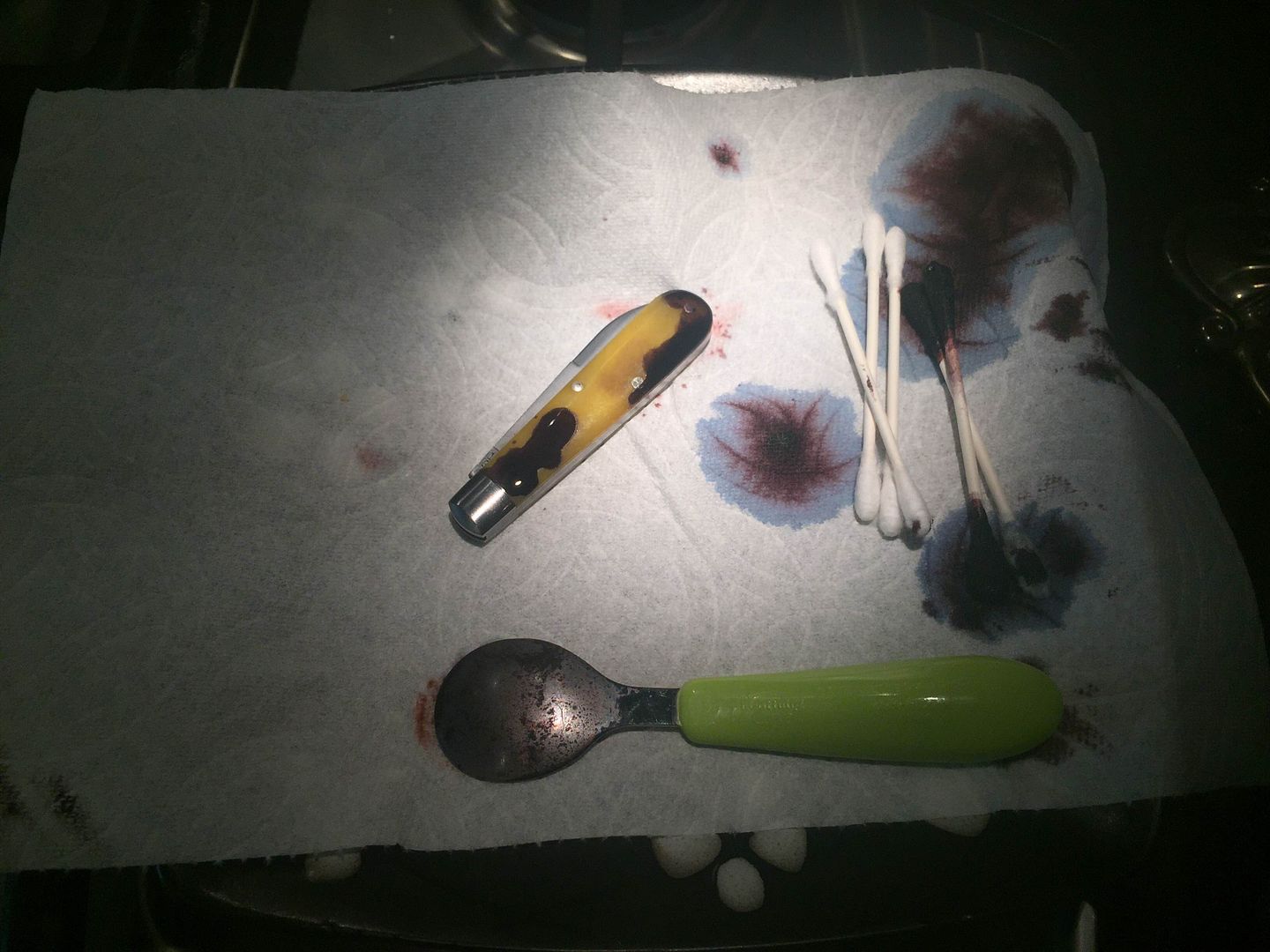

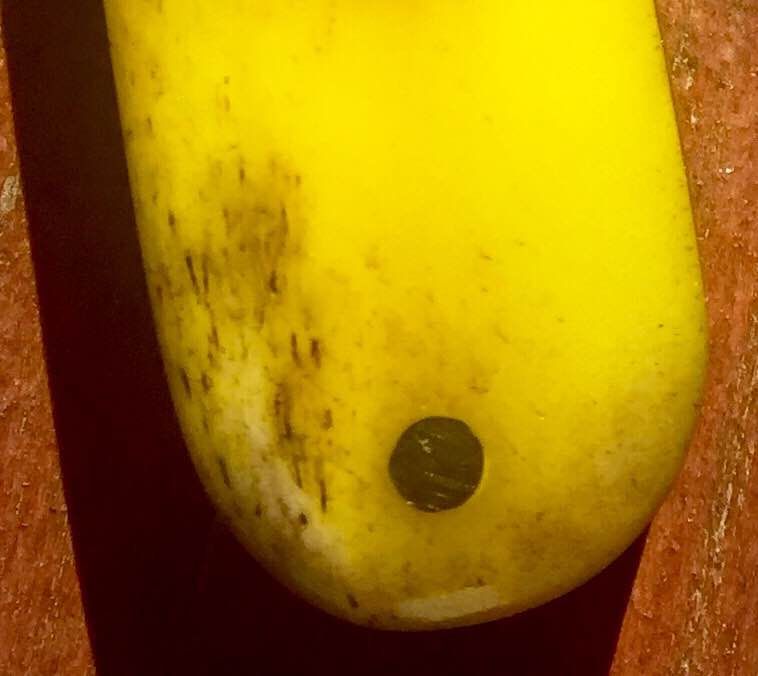

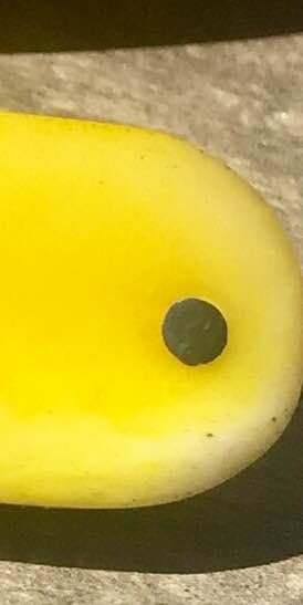

The biggest challenge I had was with the bare end on the pile side of the scales. As you can see on the original scales this portion was white. I had assumed this was due to finishing but quickly learned this was not the case.
This section of the bone was extremely stubborn and all but refused to take dye evenly. After the initial chocolate brown dye treatment I was left with white bone and small black streaks only present in the small creases of the bone in this section. It was the only portion I wasn't really satisfied with. I decided to work backwards and this is where the Amarillo yellow dye came into play. I used repeated coats of yellow to help dye the remaining white in hopes that I would then be able to add more brown bruising over the top. Here it is before adding more bruising.

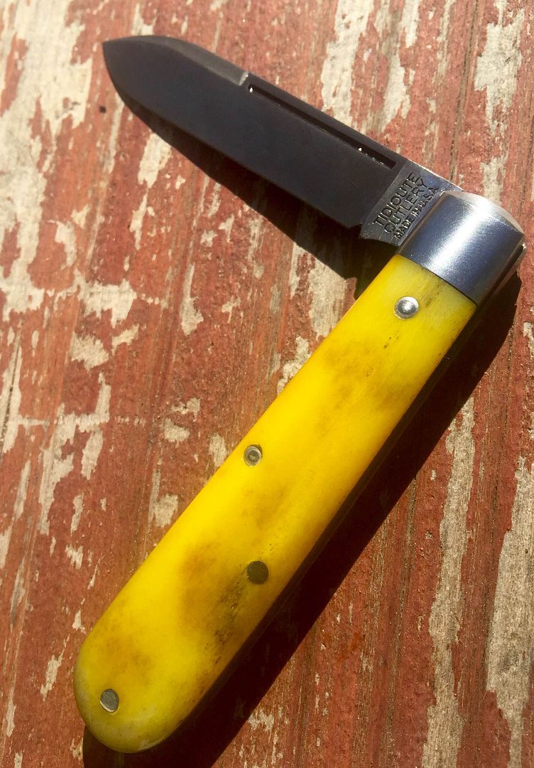

Here is the knife right out of the tube-

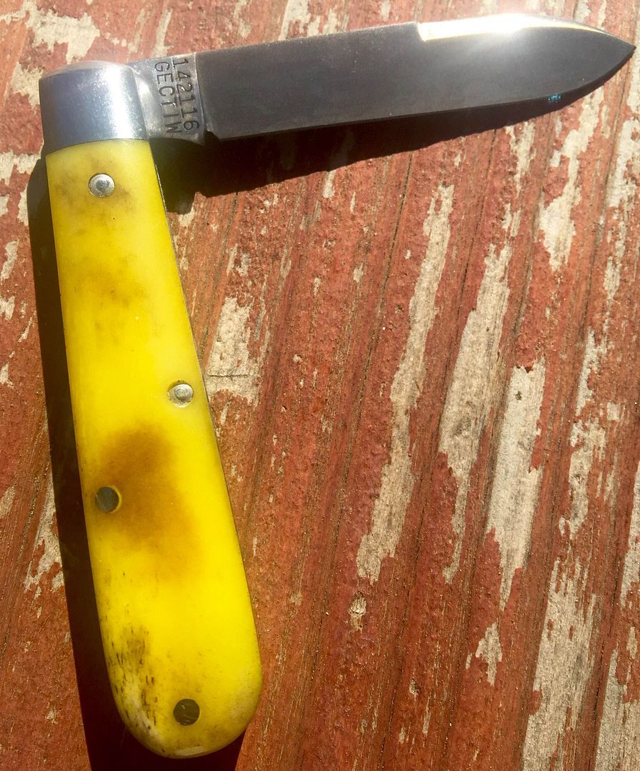

Mid way through the process-

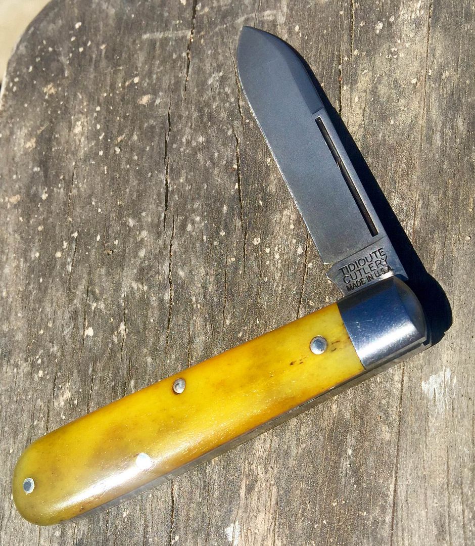

The final product-
Here's a few in direct sunlight
