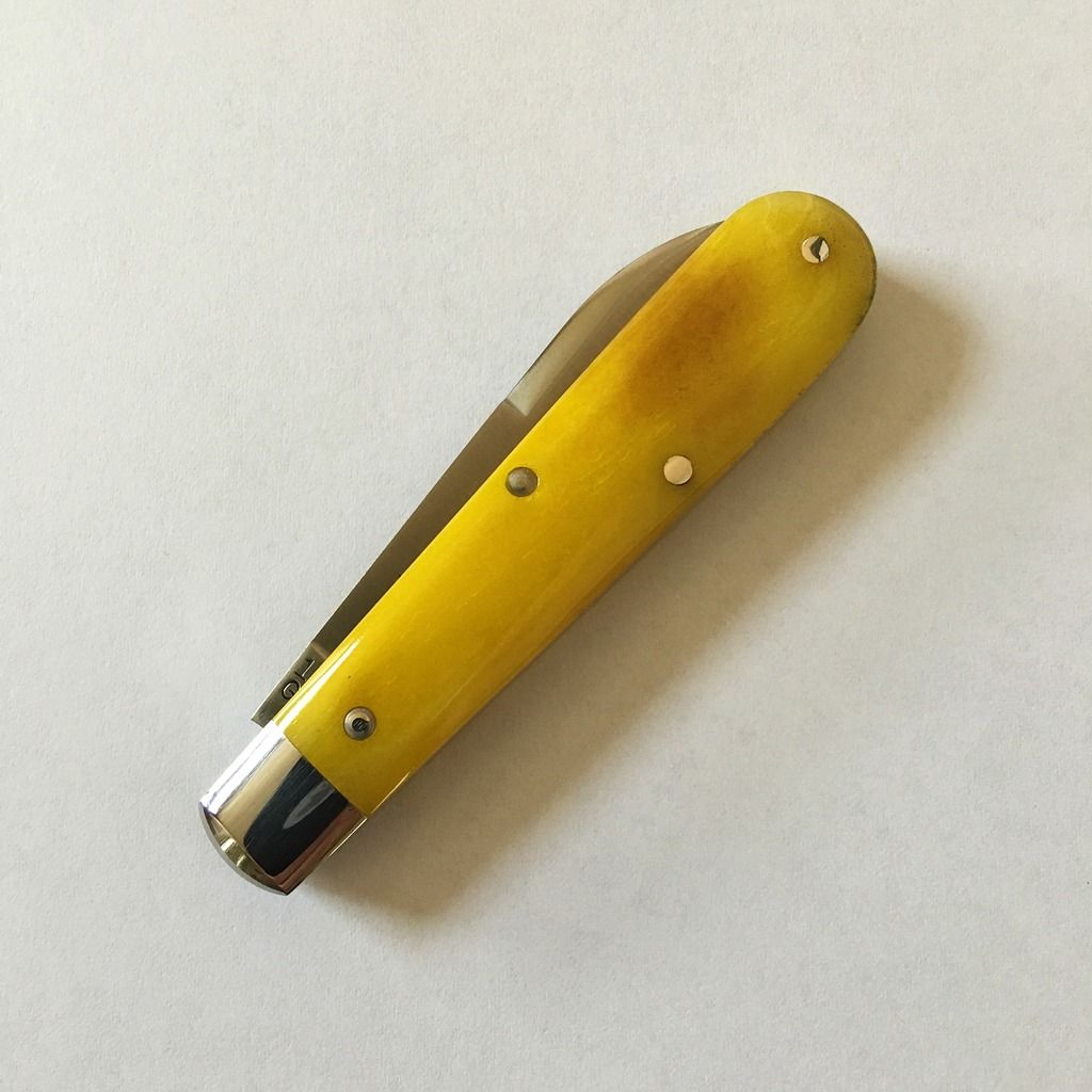

Here is the original mark side.

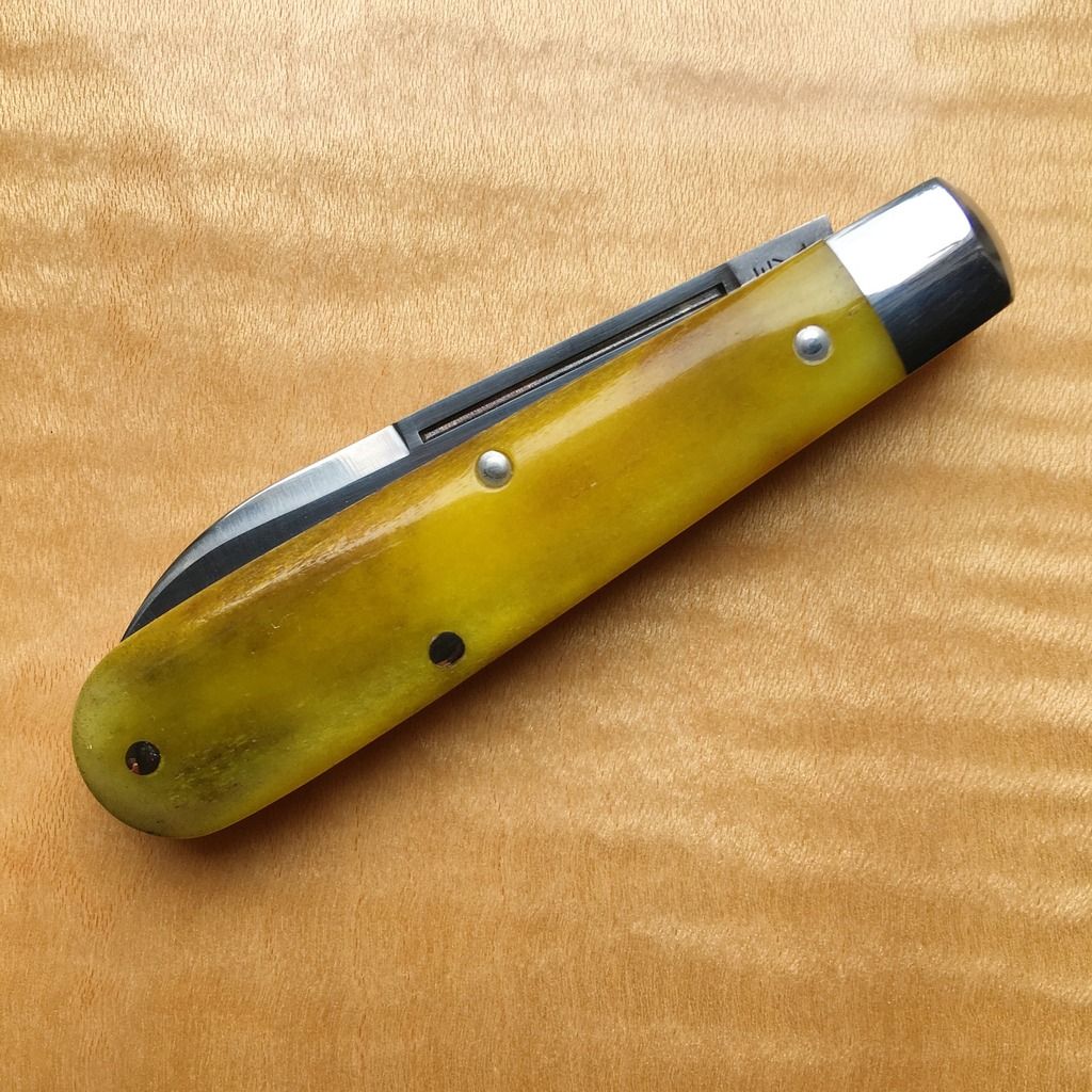

Here it is after the dyeing process.

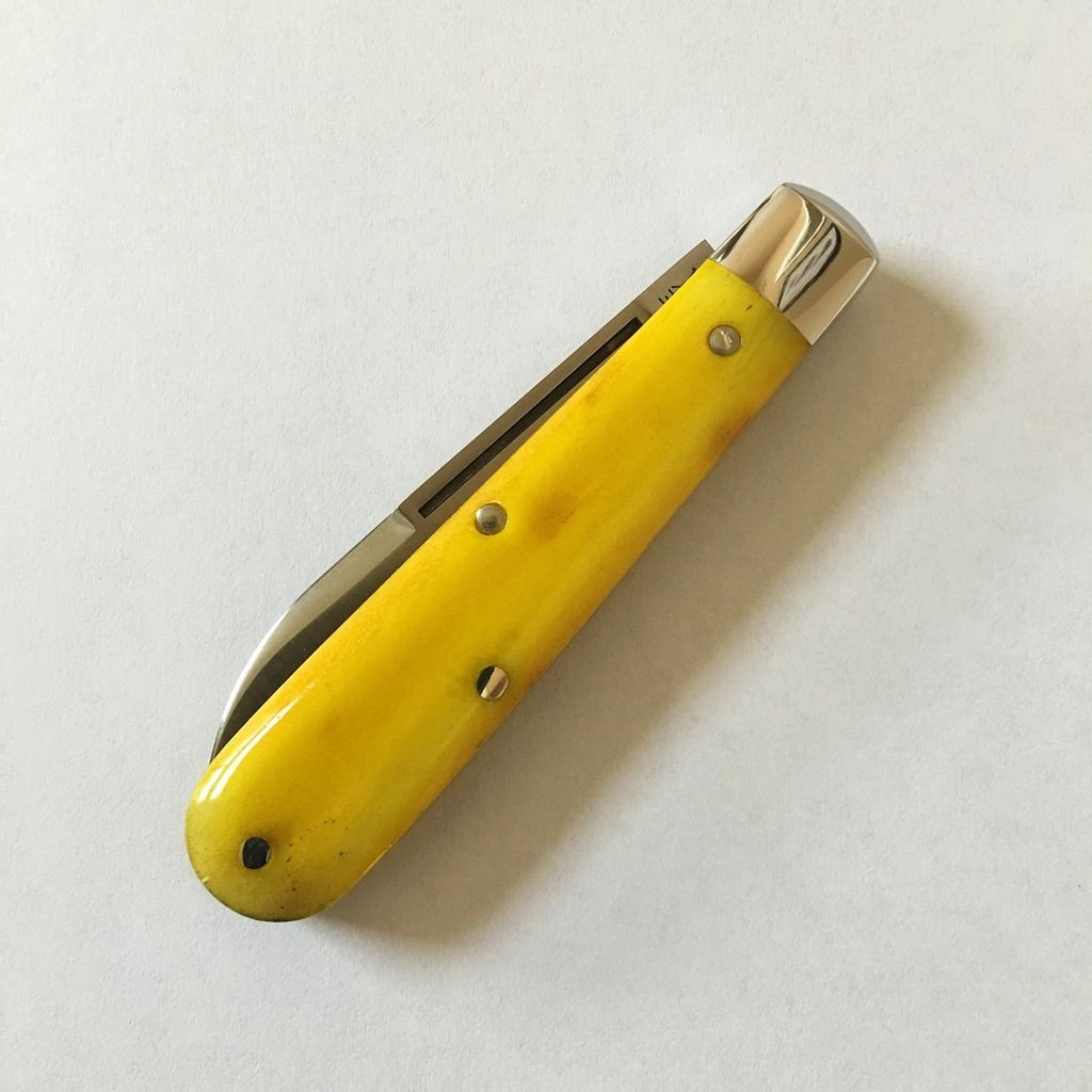

Here is the pile side pre-dye.

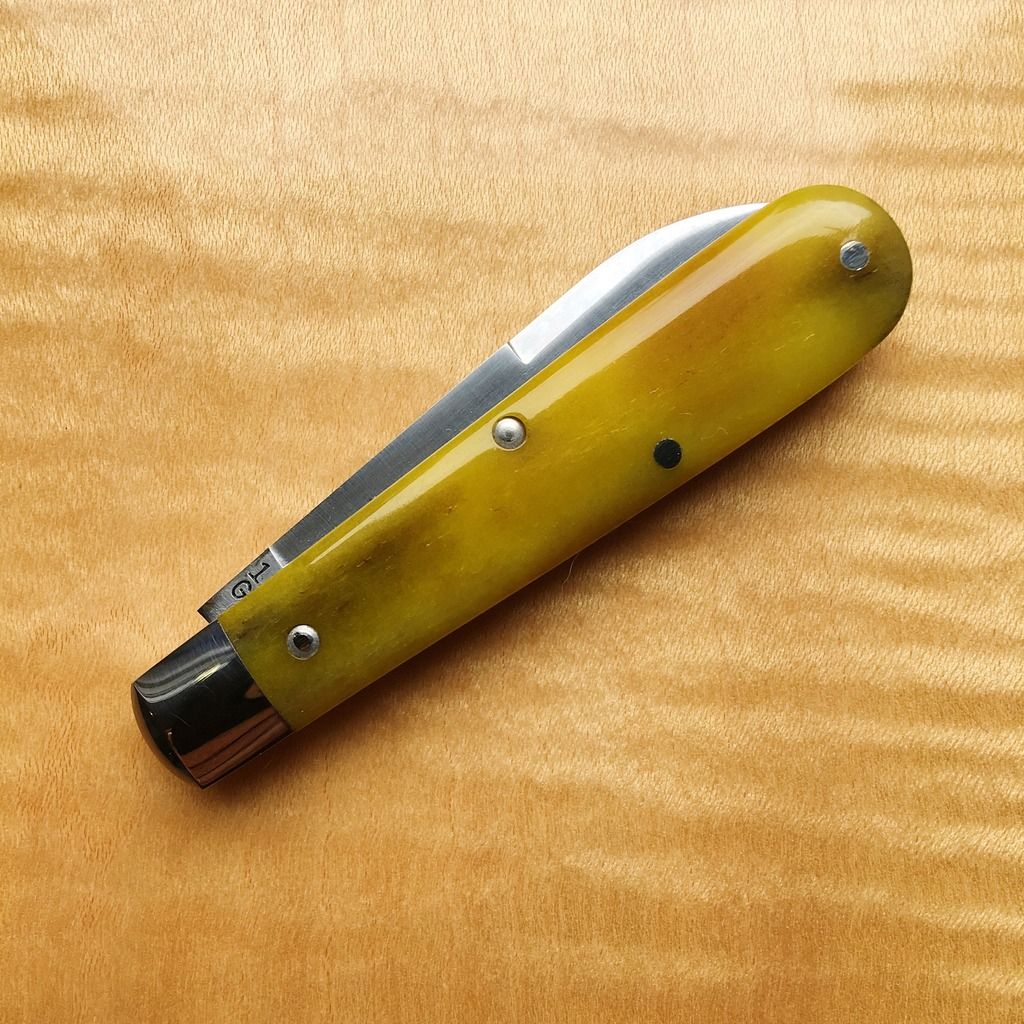

Pile side after.
I think I may have gone a little too far, as pretty much all of the bright yellow is gone, although in sunlight the new version is not quite as dark as the pics show. Overall I am very pleased. This was my first time changing a knife to suit me better and I have to say, it was indeed a lot of fun and it now feels more personal. I am going to sharpen it up on the Sharpmaker and strop and my "new" knife is going to ride in my pocket all week!
