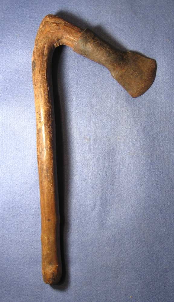

Rough-Forged Traveler's Celt Test Piece
They grow the saplings in the curve they want. However, one can also find the same adzes mounted to a block, through which a mortise is cut like an eye and a handle affixed that way. In the absence of a small chisel or proper boring device, one could always use a bow drill and deliberately burn/rub through to form the mortise.
