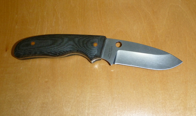

I hope you bladesmiths don't mind a newbie question from an amateur. I'm about to make my second (ever) handle for a knife. My first was an Ipe handle for a Spyderco M390 Mule. What I'm working on now is a Spyderco Woodcraft mule and I (ironically enough) will be using Micarta. I got some green canvas Micarta scales from Texas Knife and am wondering which side of the scales I should adhere to the tang. One side is extremely smooth and glossy. The other side is a lot more rough and feels like bare canvas. Thanks in advance for any advice.

I got my handle glued up and I'm now just waiting for the epoxy to cure. I'm using just two pins so that I have an open 3/16" hole for the epoxy to pool in. I also bought a tungsten carbide cutter bit for my Dremel tool and cut 6 shallow trenches on each side of the tang to allow for more spots for the epoxy to pool. I got an idea of how hard the steel is when I tried to do this with a Dremel bit I already had. All I was doing was making polished lines on the tang and probably ruining the bit.
I finished the Mule and wanted to share it with you guys. Thank to everyone who gave me advice in making the handle scales for this.
