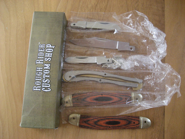

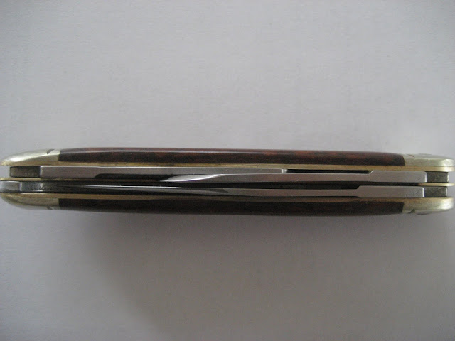

Well this is a bit tricky Robin, the knife is RR kit, which I managed to complete. I didn't like the scales that came with it so I changed it to snakewood, there was no shield originally so I fixed in small silver plate, and I swedged the clipoint blade and the sheepfot as well. I still need to make the final polish and try to hide the pins.
this is how I got it
and this is better view of the swedges
Mike
Mike
In that case, great work ;-))) I have a RR trapper kit that sits on my bench and taunts me. They sent me a kit with a deformed backspring so I've been thinking about turning it into a single blade. Some day I may give it a try.
