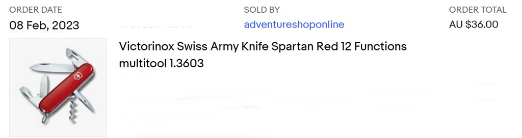

Oh , supplementary information :
Was on Feebay and spied another Camper / Scout knife cheaper than these two Chinese made knives , and it's not Chinese ..
Of course I had to shell out some Republic Bananas to add it to the collection .
Be interesting to see how it performs for $36 Oz to my door !

I now await the mystery knife : It's not made in China , it never occurred to me to consider this brand . It just flew under the radar and was only accidentally seen on Feebay ( and purchased ) ..
It is so cheap , I have to wonder if it's the real deal ? Seriously , how can it be cheaper than a Chinese made knife ?
Hopefully gets here next week .
Will be going against the Boker for fit and the RR for performance , is that fair ? Maybe not ! But for a company making knives for over 100 years , they might be doing something right !
Find out next week !
$36 Oz bananas to my door for a Swiss Made Knife ... Officer Model ( Officier Suisse )
So how will this old classic stand up to the Chinese ?
