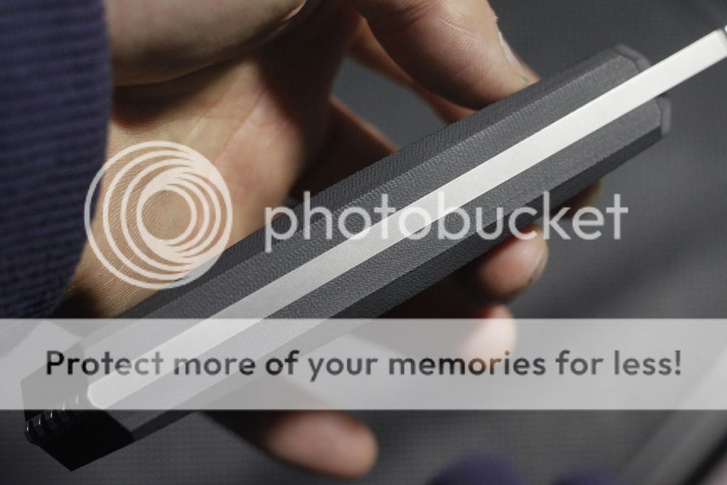

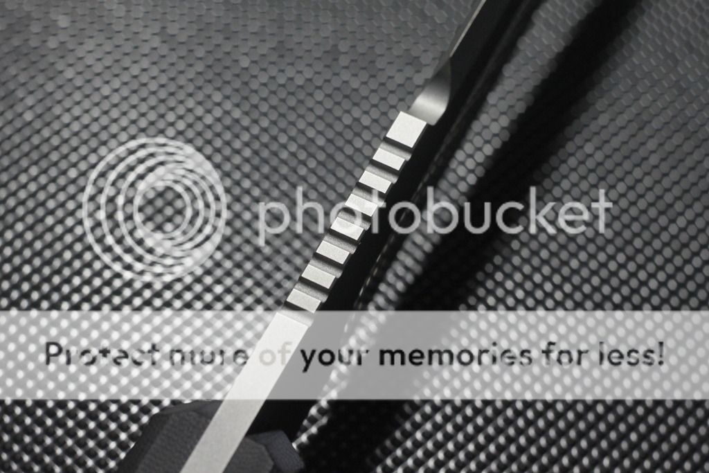

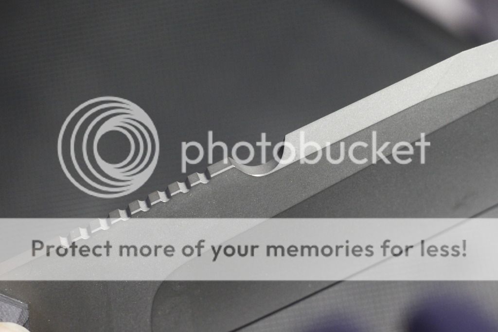

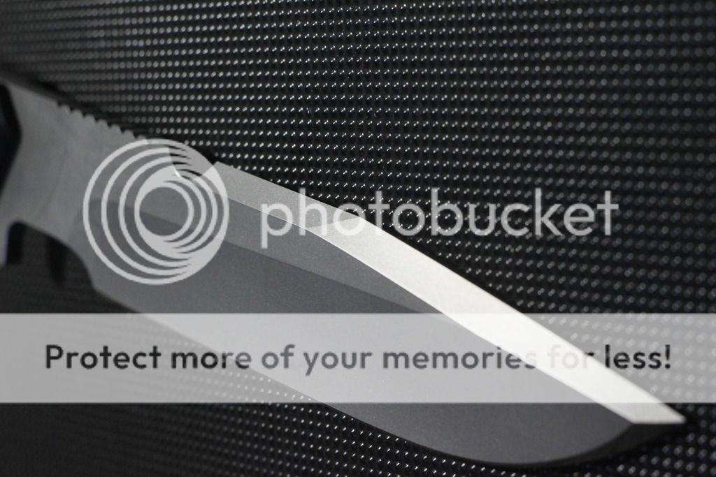

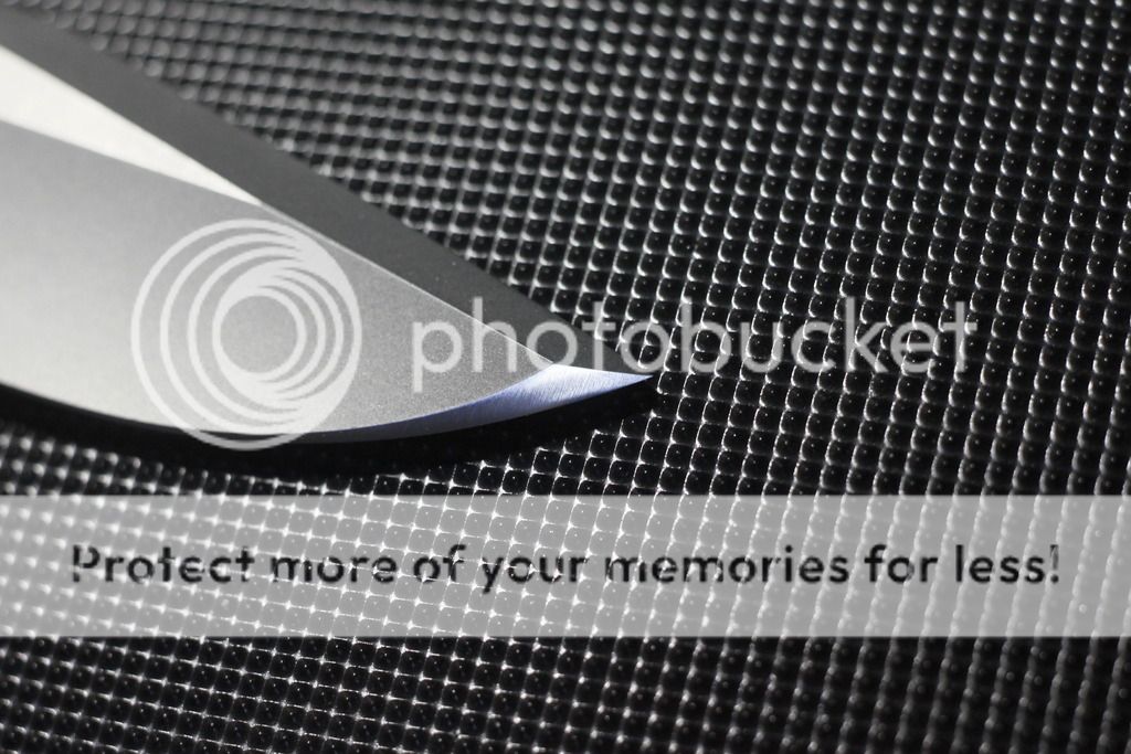

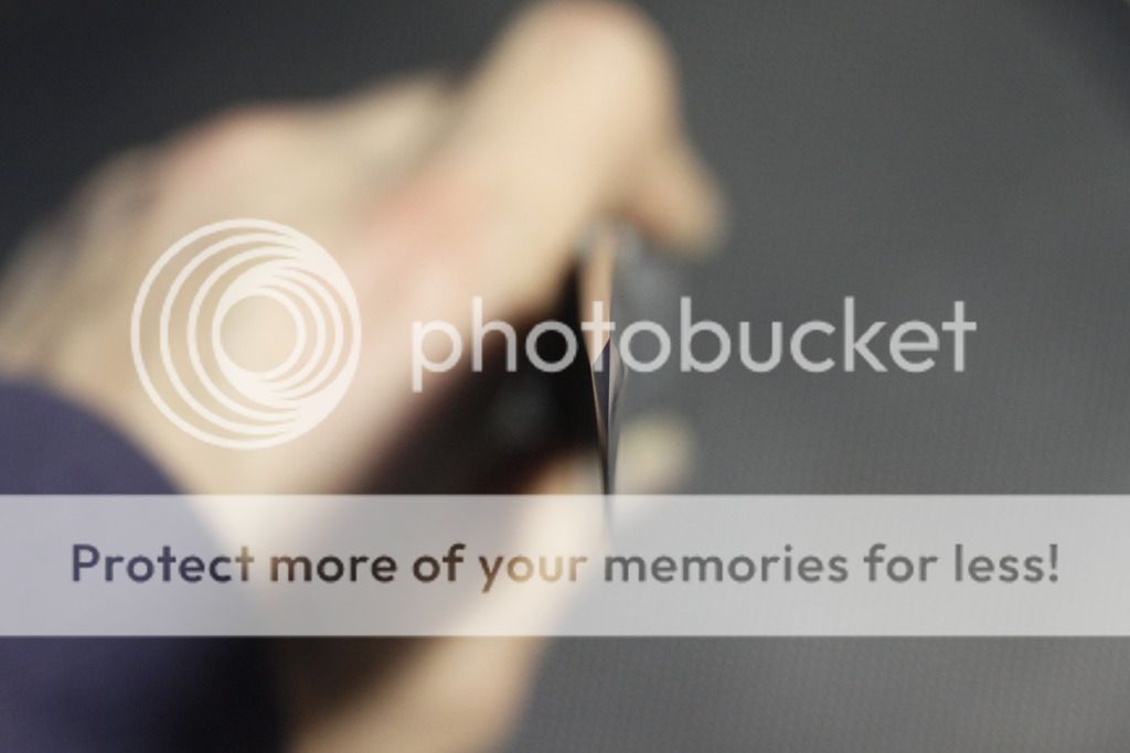

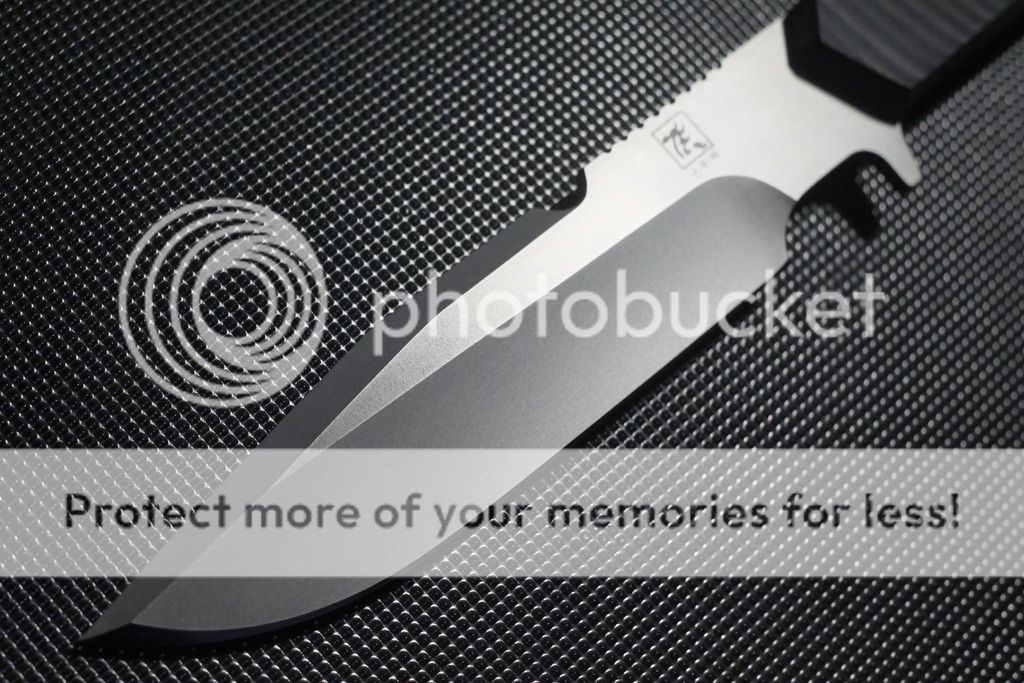

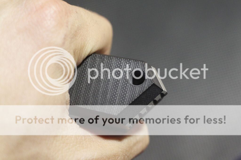

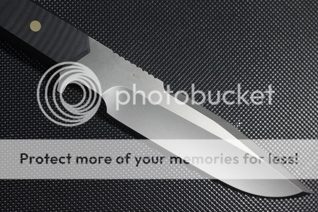

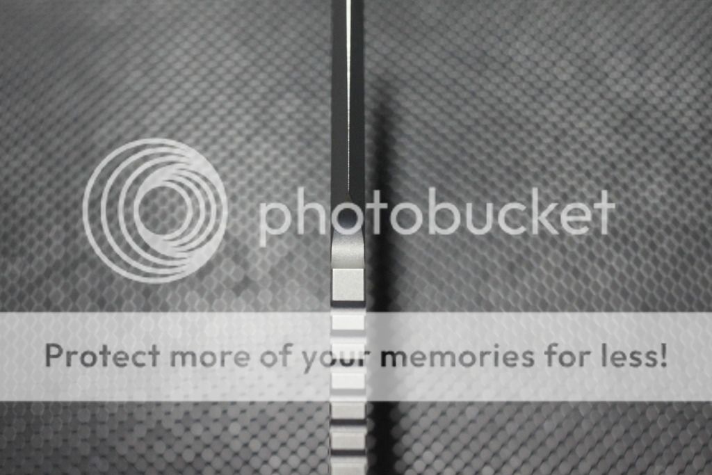

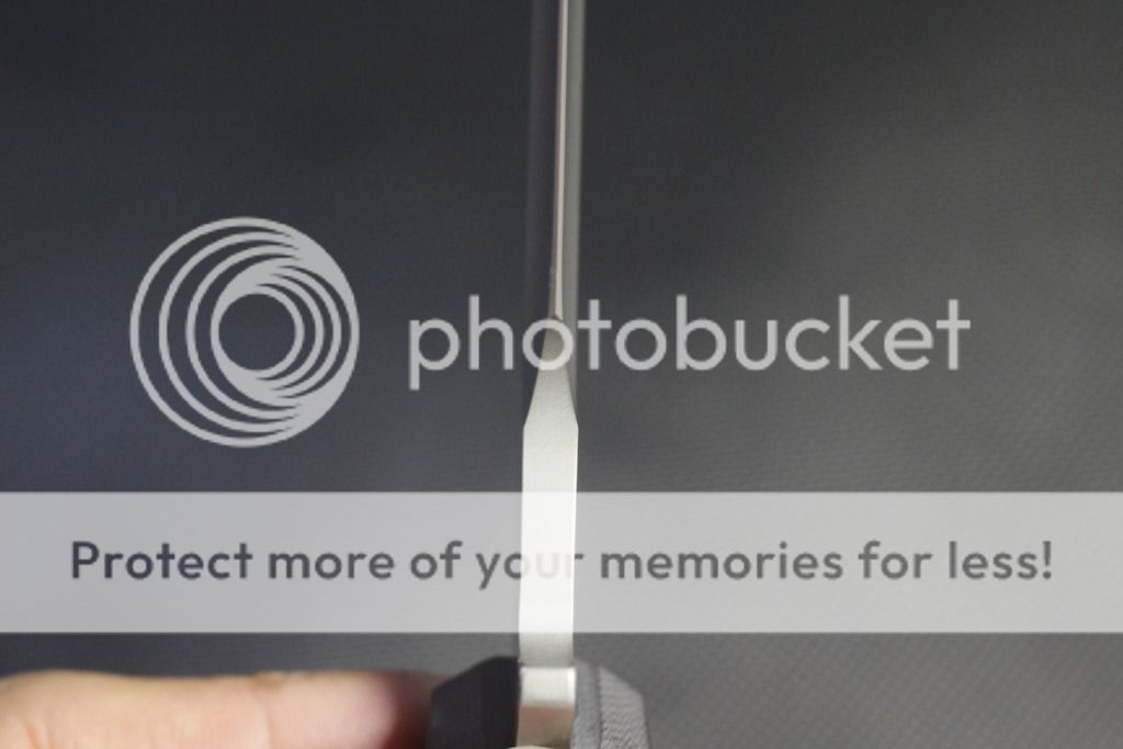

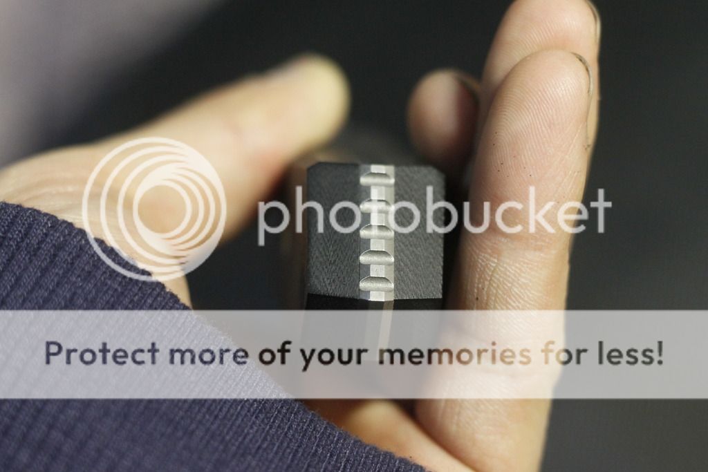

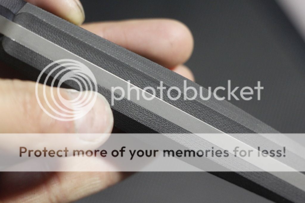

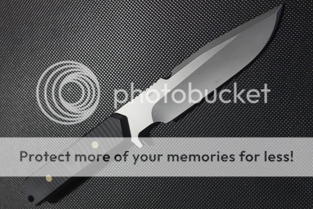

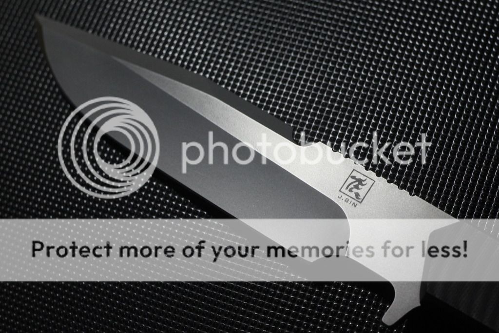

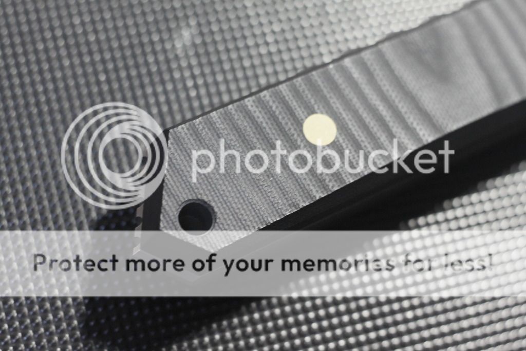

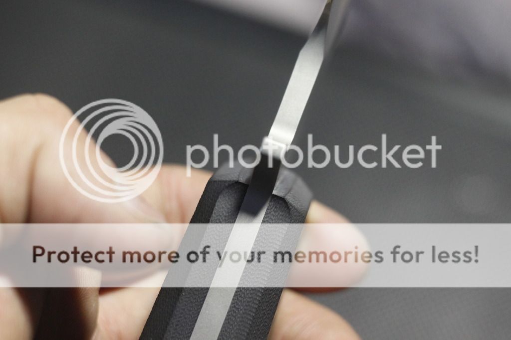

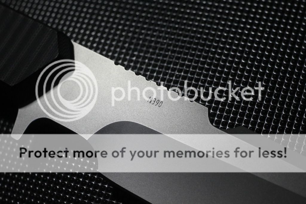

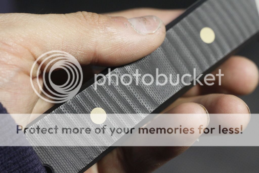

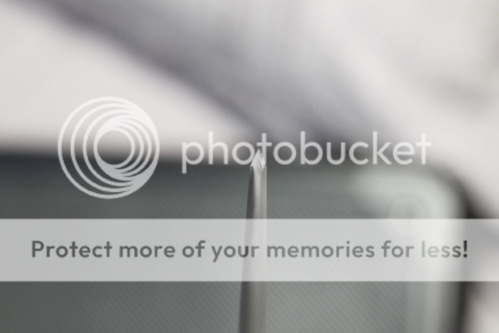

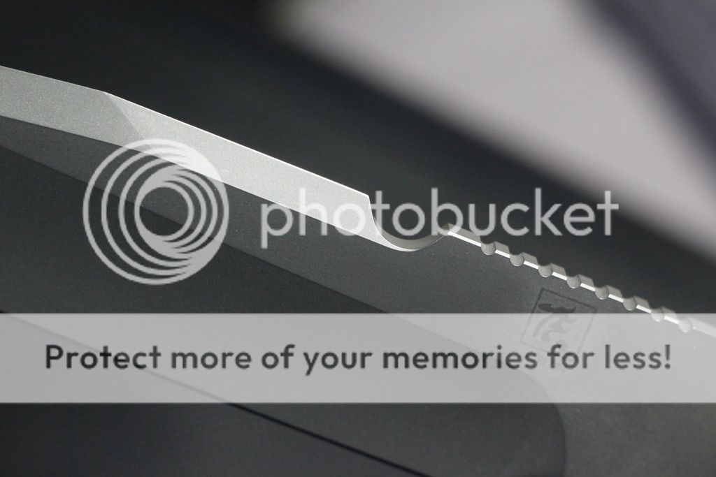

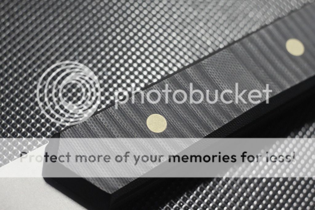

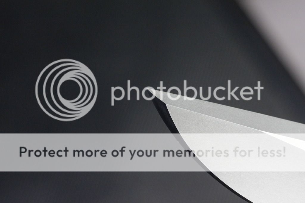

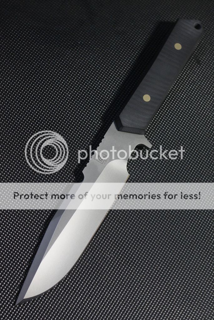

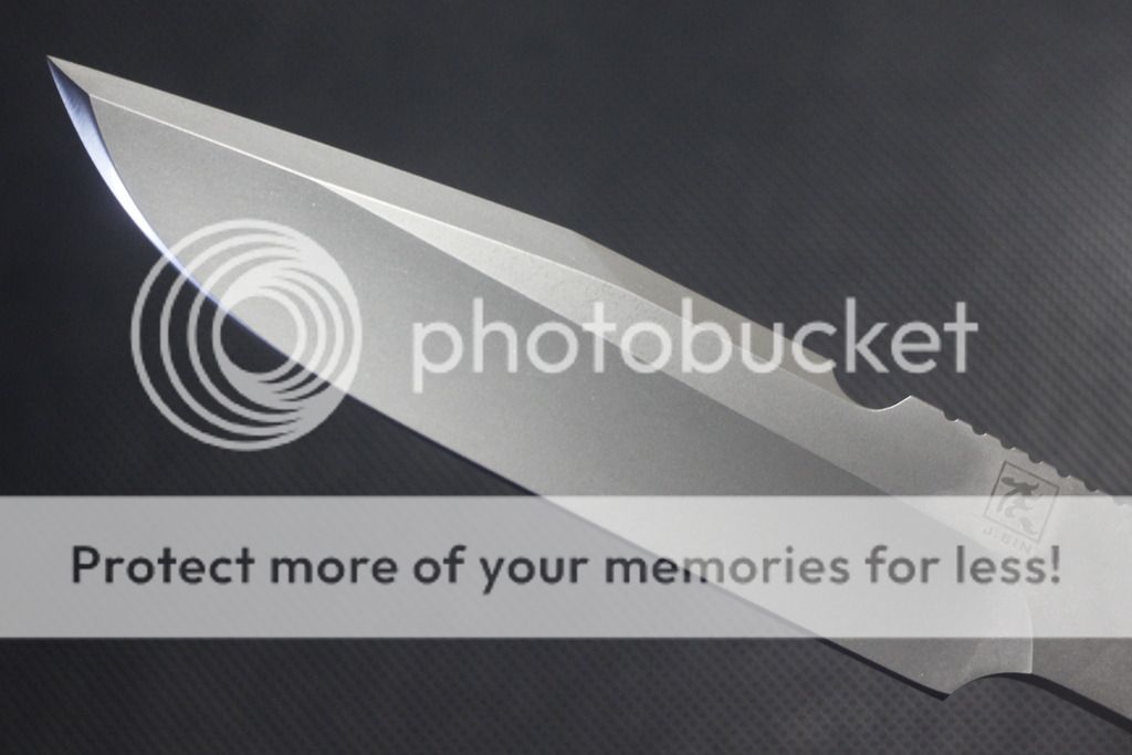

Hi Guys,

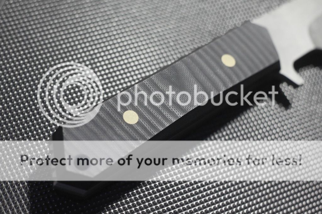

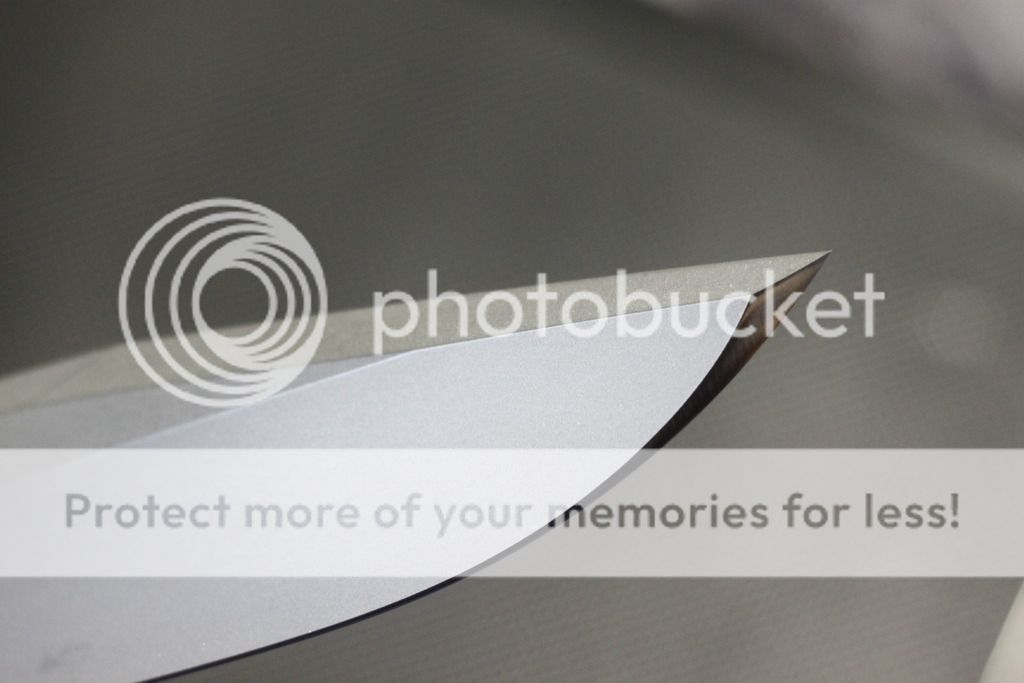

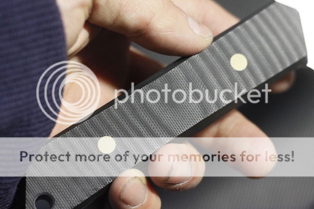

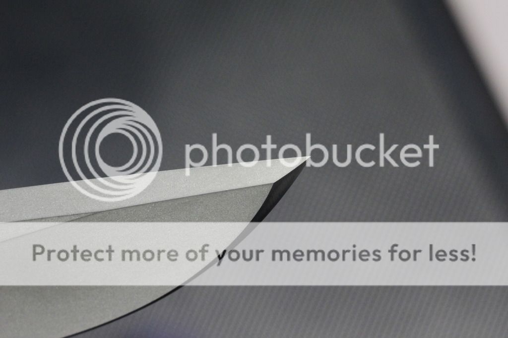

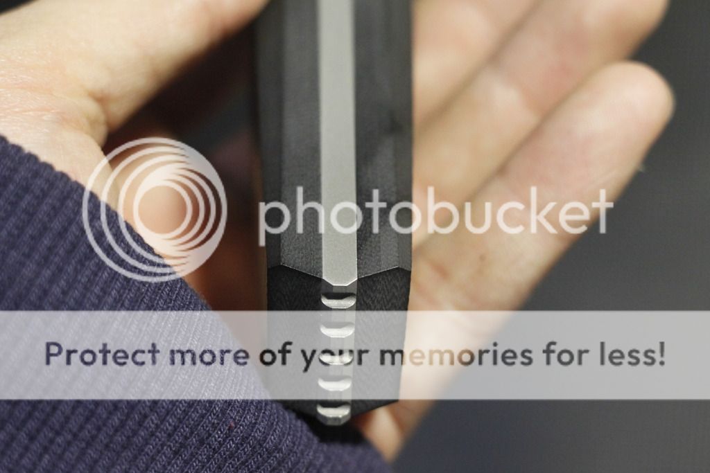

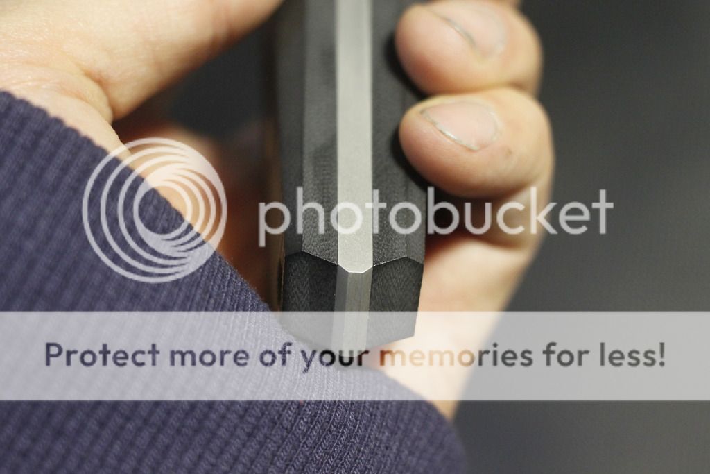

Here is my new fixed work,made in Bolher M390 super steel Peter HT at 60RC.The blade is 6inch with deep hollow grind,combo swedge is hollowed too.Convex grind blade tip.The handle is made from black G10 and copper pins.
Thanks for looking
J.bin
跨洋支持一下小次!
再接再厉!
