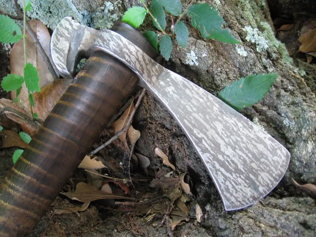

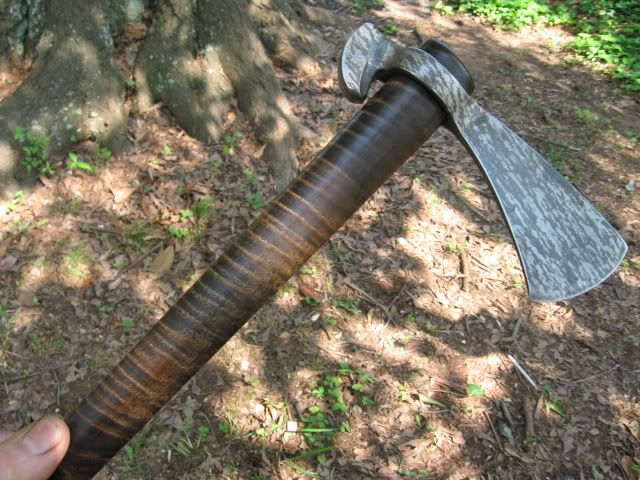

Here's a little hawk I forged from a new spike-A pia to make and I don't do many,getting the eye right is the worst and this one isn't perfect,I blued then etched in bleach for the patina.The haft is a nice tiger maple-Thanks for looking----Butch
That is freakin cool.......thing looks like you could trim a gnat's wings as it's flying. Is it as balanced and nimble as it looks??

Pretty well balanced,and it is a light weight since it was just a spike:thumbup:Thanks--Butch

That`s a beauty. Would you mind giving us some more details on how you go about etching with bleach to get that patina? I`ve never heard of that before.
Hi David,it's very simple.I finish the head to it's final grinding,clean . (I use spray brake cleaner,go over with cold bluing I dab on rather than rub),I then suspend on a wire in reg.bleach,take out rinse ,rub with a fine Scotch_Brite pad.I look at the finish if I want more,I drop back into the bleach,til I get what I want------Thanks again for all your comments-:thumbup::thumbup:-Regards Butch
PS: Some metals do etch differently,so ymmv---
