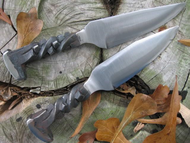

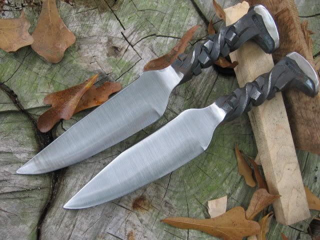

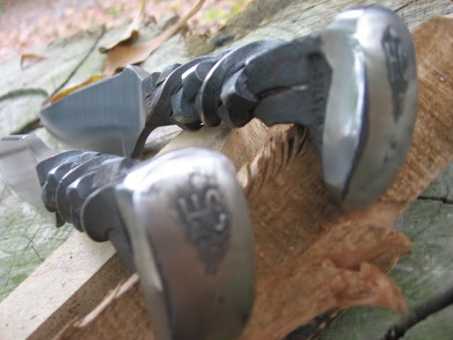

These are 2 of my forged rr spike knives made from new spikes.They have a lttle different twist than the last ones,chiseled and twisted,,convex grind,hair popping sharp,with my touchmark--specs--9" OAL--edge 4 1/2"---width 1 3/8"-----60.00 each-postage and fees inc. in the conus --Paypal preferred-Thanks for checking it out--Butch--First 2 I'll take it--gets themPrice drop 50.00 each---Bottom one is spf--Both are sold-thanks Guys
Those look...incredible! I don't believe I've ever seen a spike done with a handle like that before. What kind of grind is on these?
Thank you,they have a convex grind and are hair popping sharp-The handle is chiseled length wise on all 4 sides then cut across on two oppsing sides then twisted,looks and sounds complicated but it's not:DRegards Butch
