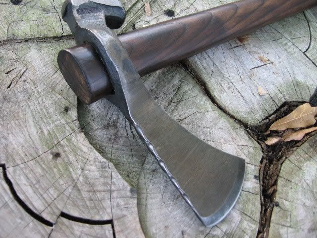

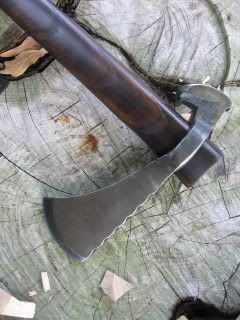

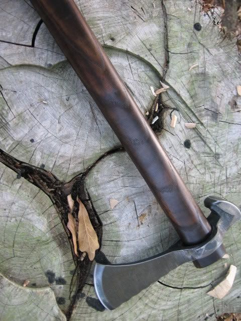

I don't forge many of these mainly because they are a pain to make.There is just not too much material in a rr spike-I added some filework to the front edge,the haft is ash burnt pretty heavily,steel wooled and tung oil then buffed on beeswax-Very light little hawk,hope you likee:DRegards Butch

Thanks,I have done that before,but I like it to look like a rr spike.I upset the spike end to get more material for the blade---Regards Butch:thumbup:
