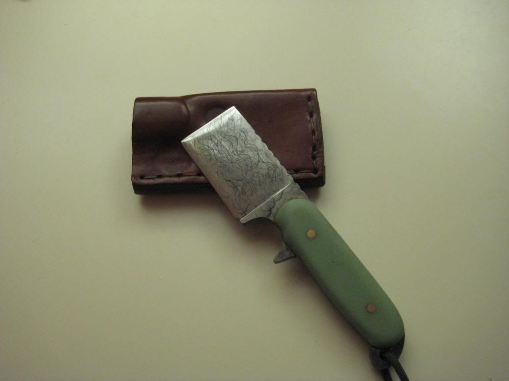

here is the knife I was talking about. It is the first knife I made my self, and is 5160, with a ghetto back yard heat treat and temper (used files and sand paper to make, and drilled the tang holes and handle pin holes with a hand crank drill), all from materials and tutorials on this site.

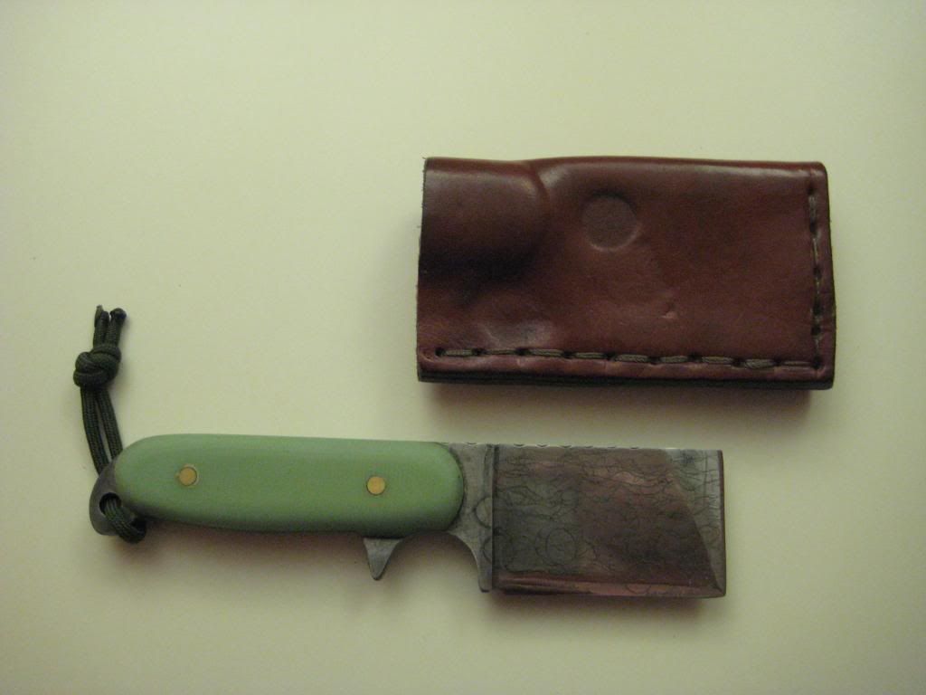

The lighting in these pics is terrible, but I am too lazy to get it back out for better ones.
The etch in these photos is much deeper than the earlier pic. You can see zig zag stripes in this one if you look. It is actually etched into the metal, and even with a loaded strop polish, the etch lines are still on there.
