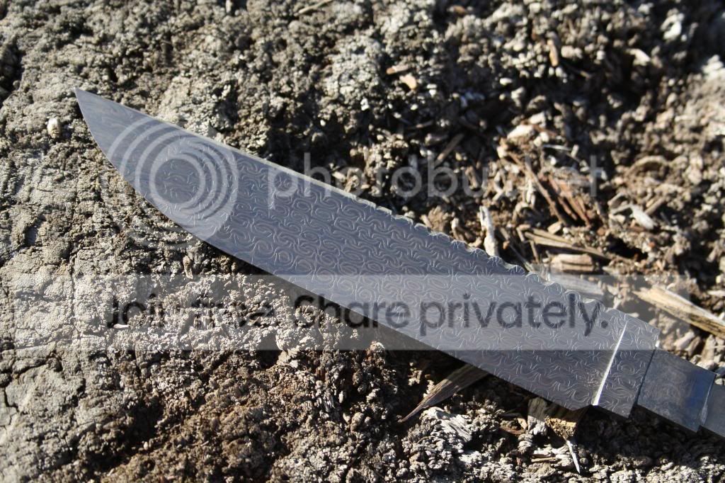

This is the blade I started with. Damascus from Robert Eggerling, etched a bit deeper than normal and finished with 2000 grit paper.

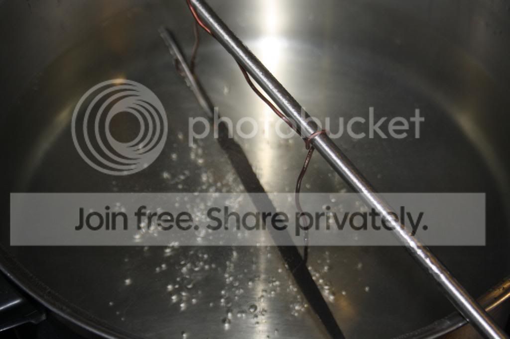

Clean the blade THOUGHORLY, several times. Wipe a thin coat of the solution on the blade, don't overcoat. Leave for 24 hours. You can actually watch the rust forming.

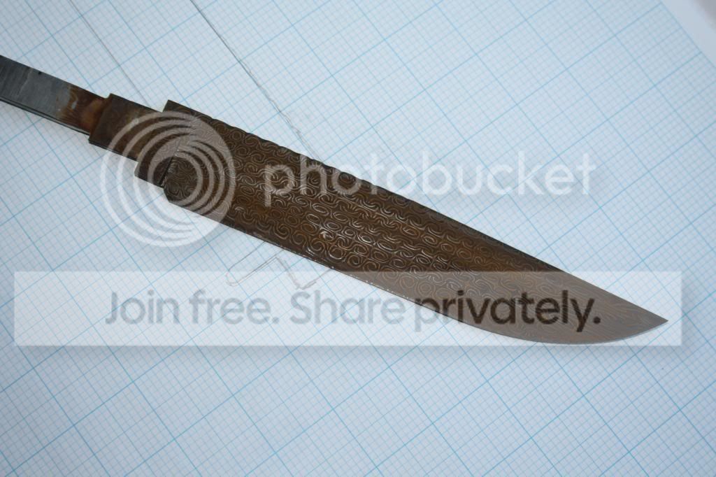

At this point I was thinking what have you done stupid. Didn't look good at all. Next step is to boil in clean water for 30 minutes. Got busted by the wife for using the good pot.
Now the blade has turned black. Card with 0000 steel wool. Now looks more promising.

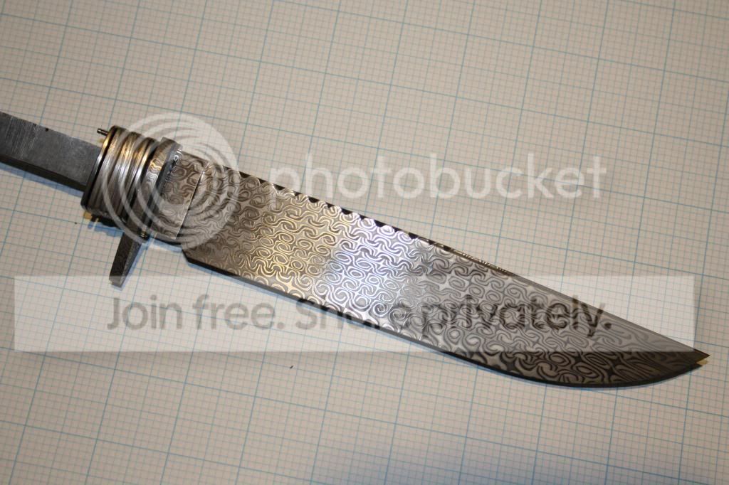

Repeat this process up to 10 or 12 times. I did it 7 times and on the last coat, the blade did not show any rusting at all. to finish, boil blade again in soda to kill any remaining acid and soak in oil overnight. Again, I was happy with the finish, just interested in any other methods. Here's the finished blade. Excuse the crap photo's.

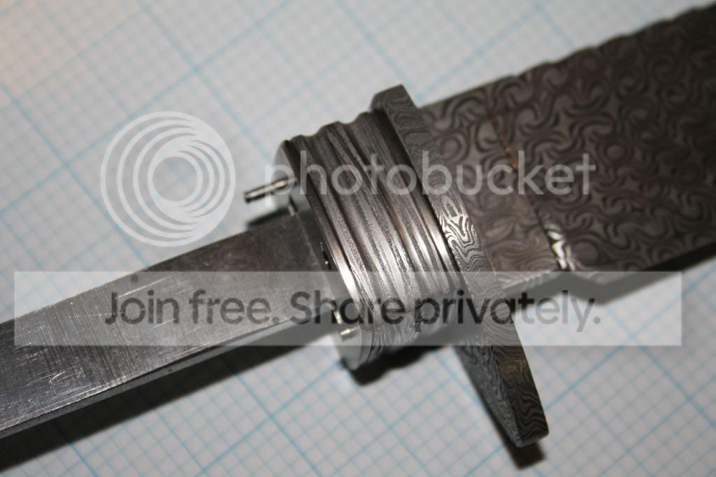

Doug, sorry this has nothing to do with your bluing question (looks great by the way) but is there a reason for the step down tang? Never seen it done that way before, always tapered.
Hi Patrice, the knife has a frame handle and the spacer finishes at the step. The handle frame fits up against the step and spacer. Don't have a pic of the frame, but this one shows the fittings in place ready for the handle. Hopes that's clear enough.
Cheers, Doug

Almost forgot, the fittings on the knife are Nitre Blued. First time I've tried this as well. My mate the gunsmith told me to use a lead melting pot to melt the salts if I was only doing small parts, worked really well and is easier than setting up a tank and burner.
