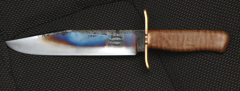

You may be able to get a lot of the surface rust off by simply using some elbow grease and some CLP/Break Free. You should also keep a layer of Break Free, or similar substance, on the blade at all times - regardless of whether the blade is stainless or not. Oh, and never store any knife in a sheath. A sheath is for carrying, not storage. It's asking for rust.
I use Break free on my main hunting Bowie, and have had some days where I carried it sheathed in 90*/80% humid environments. As you can see, the original saw blade(L6) it was hewn from was pitted(we did it on purpose for a work-knife look, as with the bluing/case hardened look). I'm using it as an example of how even a carbon blade that has had previous rust can be preserved. With Break Free, there's never been any rust since it restarted life anew as a Bowie.
