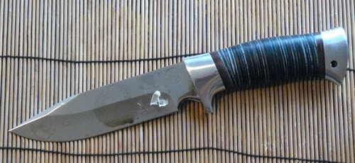

1. I decide to use 3 different liquids - unfiltered water, lime juice, onion juice.
Sorry I did pictures for Russian spoken forum, so labels on the picture are in Russian. So there are (from left to right) water, lime, onion!
2. I left my knife for 3 days on the kitchen table - average temperature 75F, humidity 75% (Chicago summer
what I got after 3 days you can see on the next picture:

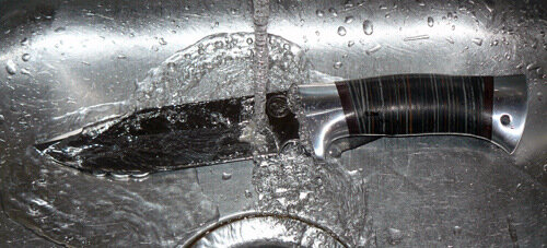

So we got 3 different marks on the blade. (it would be strange if we would not get them). And I decide to wash my knife in regular tap water:
[url=http://fotki.yandex.ru/users/vovchk/view/9327/]

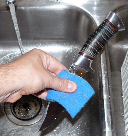

A piece of onion "glued" to the blade - lets try soft sponge:
[url=http://fotki.yandex.ru/users/vovchk/view/9330/]

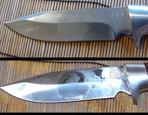

What do we have now?
[url=http://fotki.yandex.ru/users/vovchk/view/9328/]

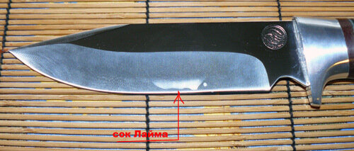

What can we see? I took two shots - with and without flash.
We still can see some marks but NO RUST AT ALL
No marks after water, very light mark after onion and a little darker mark after lime! Again - NO RUST!

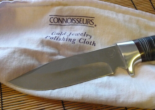

Ok! I decide to try regular jewelry cleaning cloth from WalMart (used one! with almost no powder!)
[url=http://fotki.yandex.ru/users/vovchk/view/9333/]
And as result we see:
[url=http://fotki.yandex.ru/users/vovchk/view/9332/]
Just a very light mark (no rust) from the lime juice! Nothing after water, nothing after onion!
That lime mark i cleaned with NEW jewelry cloth!
