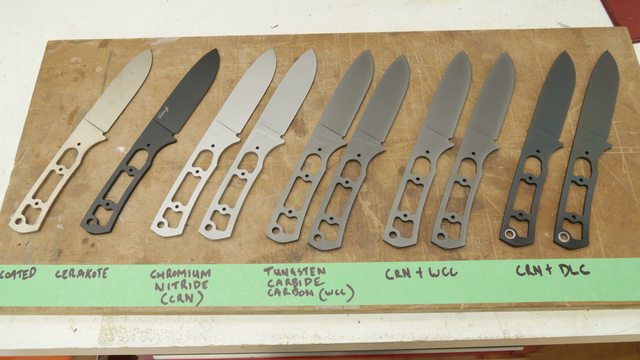

The coatings under test will be:
* A2 Uncoated
* Cerakote (Graphite Black)
* Chromium Nitride monolayer (CrN)

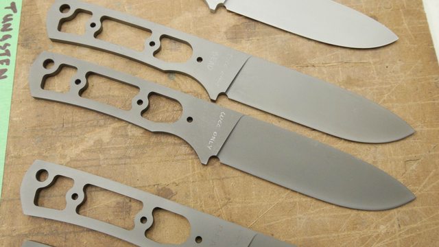

* Tungsten Carbide Carbon monolayer (WCC)

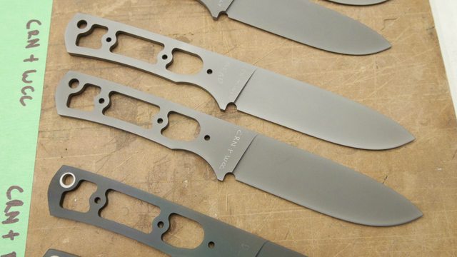

* CrN + WCC dual layer PVD

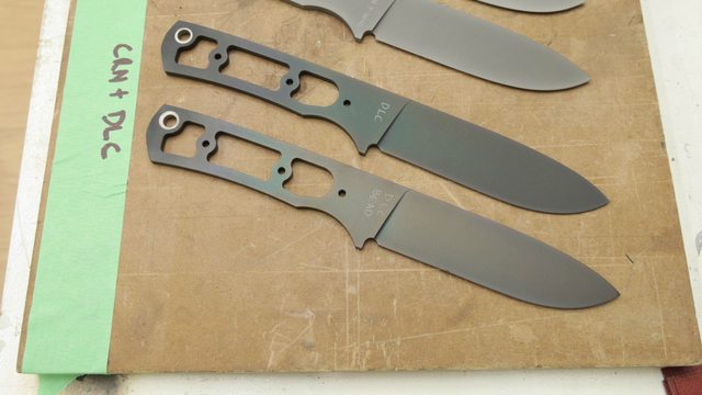

* CrN + DLC dual layer PVD
Chromium Nitride, WCC and DLC are all coatings that are used commonly in industry. DLC is used commonly on cutting tools, injection molds and so on. WCC is used on sliding parts that have to be run dry, like slides in injection molds. WCC seems to be used less in North America, but more in Europe for some reason.
DLC is a coating that most of us are familiar with and it sets a pretty high bar! The DLC coating that I've had done is a dual layer coating with Chromium Nitride underneath for added corrosion resistance. The DLC came out this time with a little bit of a rainbow sheen to it, but my coating provider has promised me the next batch can be done without that. They will also be doing the next batch with a thicker Chromium Nitride underlayer and a thicker DLC layer, so if the next batch comes from them it should actually outperform the DLC seen in this test!

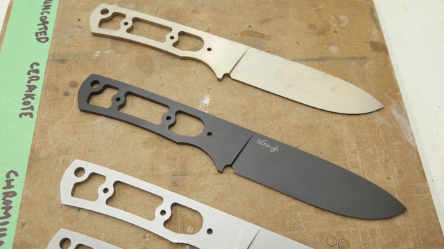

Without further ado here are some photos of the coatings as they were received from the suppliers, you can click on the images to see the full-res photos:
My initial impression is that overall Cerakote still looks the best when it's a fresh coating. It has a really nice even satin black that's pretty hard to beat.
The other coatings are very 'dry' when they come from the suppliers. They're so clean that any fingerprint shows up on them as an oily spot, much like a fresh acid etched finish actually.
To counteract this I have tried lightly oiling them the same way I would with an acid etched finish, and it had a similar effect! The coatings all darkened up significantly. The DLC coating went completely black and now looks every bit as good as the Cerakote finish. The others are still a dark grey rather than fully black which is not ideal...

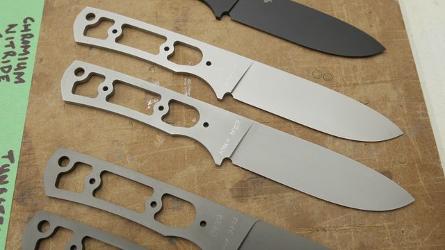

The chromium nitride is a beautiful satin chrome appearance, I really like it! It doesn't work all that well with my handles that have two colors (black & green for instance) but it looks great with solid colors. I had a number of customers that were after a more 'high visibility' knife for hunting use, so the CrN paired with Blaze Orange handles might be just the ticket for that!
