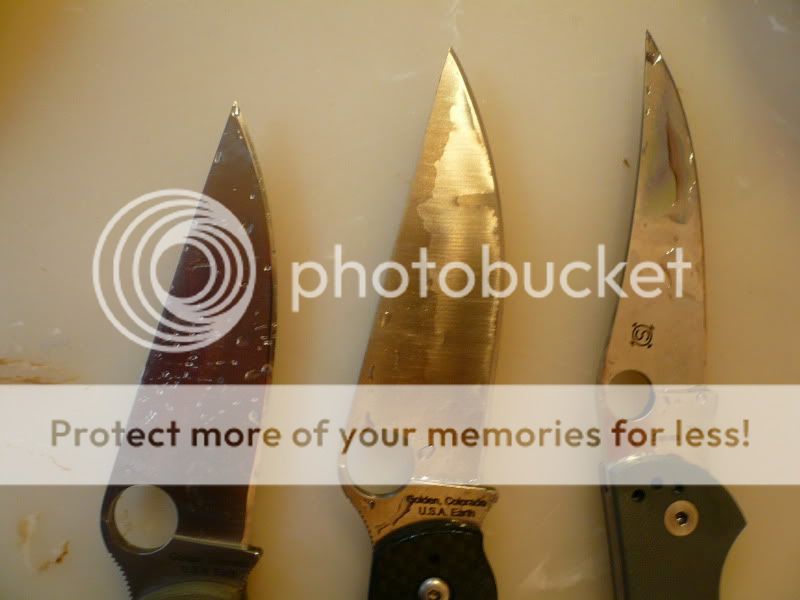

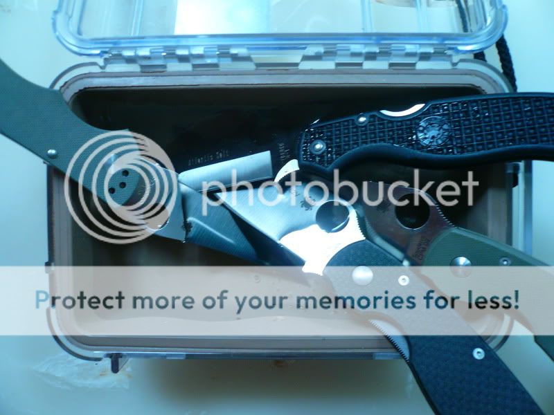

so, with all the recent threads about rust, i figured i would put some of my spydies to the test.
1. atlantic salt: well, we all already know what the outcome of this will be. more of a control than to actually test the h1.
2. s90v military: should be pretty resistant, but we shall see.
3. d2 military: semi resistant? im really curious about this one.
4. vg10 smith: also should be pretty resistant.
solution is water mixed with saline solution. i have soft water, so wanted to speed up the corrosion. this is purely to satisfy any curiosity, i didn't measure the amount of water or saline, and will check periodically (read: when i remember). enjoy!
initial submersion. i put only the blades in the solution, i didn't want to have to worry about rust in the pivot areas or inside the scales.
after about 4 hours.
the d2 has a small spot of what appears to be corrosion near the edge.

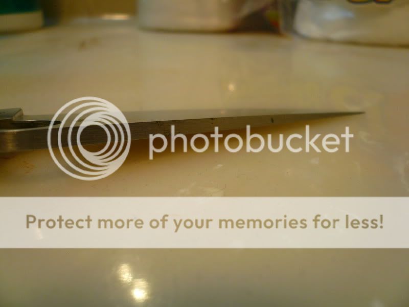

in my experience, D2 tends to pit and rust.
a spot nearer the choil is actually now a hole in the edge and surrounded by surface rust!
there are a few black spots on the blade and spine as well.

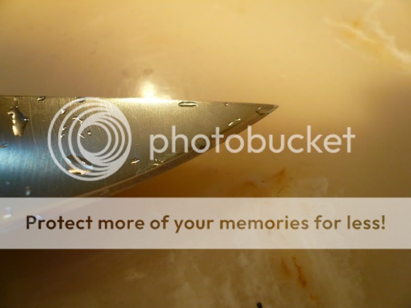

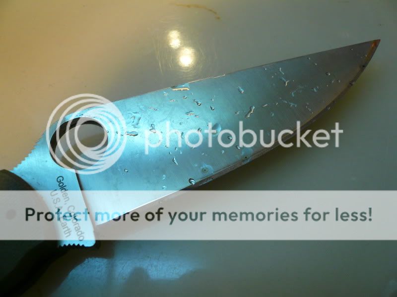

and vg10 and s90v have no signs of corrosion as of yet.

the spots on the d2 are definitely pits. about 6 total, 2 on the actual edge.
probably because the saline sped up the corrosion process. since it corroded so quickly, i removed the other two last night before i went to sleep.
ill put them back in today.
be careful with your d2 blades!
