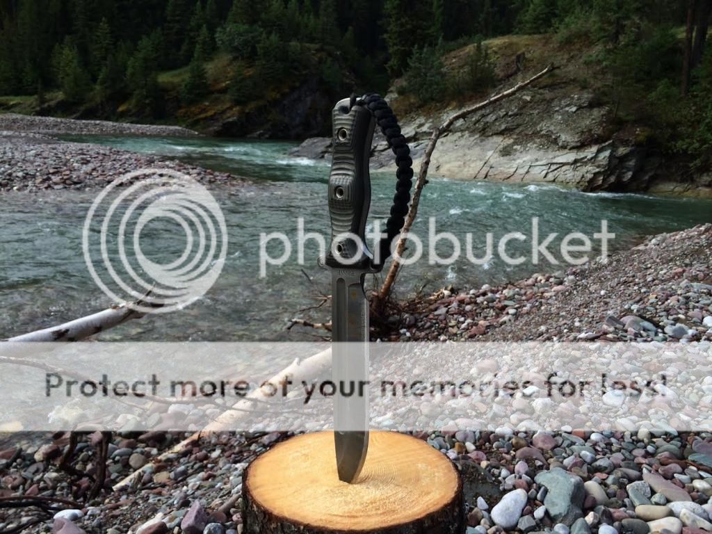

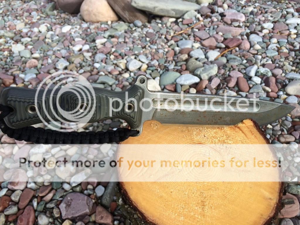

Every now and then, I see posts about INFI not being a true stainless steel. While I don't disagree with those sentiments, I've put my stripped TGLB through a bunch of Oregon humidity without pause.
I recently went home to Montana for a few weeks for some much-needed R&R in the Bob Marshall Wilderness. Unfortunately, the weather decided to throw a curveball at us and we got a solid 30 hours of heavy rain out of nowhere. The rain conveniently hit as I was clearing a snag in the river with the TGLB, so it got SOAKED. Given my complete disregard for the well-being of my knife, this made for a perfect opportunity to test the oxidative properties of INFI.

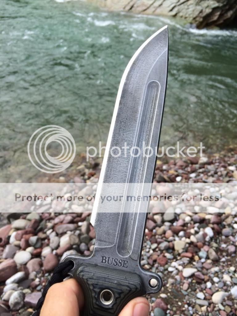

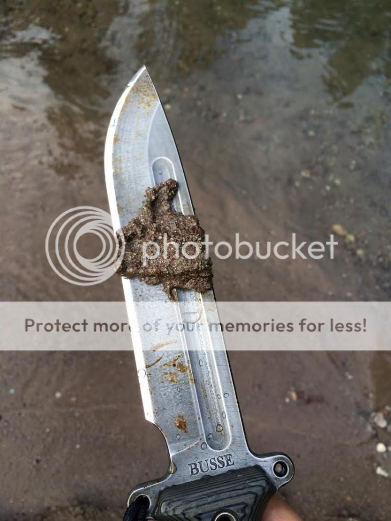

I left the knife outside on the ground overnight while it was still raining and woke to find a lightly rusted slab of steel.
Not one to leave my stuff in shambles, I figured a good sanding would take care of the mess, so I grabbed a pinch of river sand and gave it an 'ol fashioned.
Good as slightly new!

Looks like you might have a layer of decarb left on there. Stain resistance may improve if that is removed. Nice pics! :thumbup:
Looks like that to me also...
My experience (limited) with stripping is that decarb layer will promote rust directly proportional to how much is left behind after stripping...more decarb present = more / quicker rusting--- less remaining decarb = less staining & more rust resistant...
***NOTE**** notice how rust free your primary edge is...cause it's more finely finished and carb-free also...
I've seen after freshly stripping the epoxy coat, a blade form rust atop the decarb layer before my eyes immediately...
Remove decarb with sanding thru at least 1200 grit wet/dry...start as coarse as you're comfortable with--- riversand, etc....
Finish with chrome polish, like Mothers...I top that by melting in a coat or two of Frog Lube...
or leave it as is, if you like the gunmetal look :thumbup:, and knock the orange stuff back down when it rears its ugly head...:eek:
Fairly stainless after being left out all night in the wet. I have had S30V get fairly rusty in my pocket while working in humid air and sweat.
