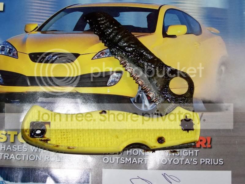

This might be old hat for some of you but I was shocked at a picture of a
Caspian Salt on another forum that was severely rusted. I guess there
isn't much that won't rust but it still took me by surprise.
I would like to see the picture as well. Many people have tried their hardest to get H1 to rust including using chemicals without much luck. Sometimes the laser etching can look rusty but it will come off and I think is a discoloration from the laser (could be wrong on that).
I know mine has seen a ton of salt water and not rinsed and looks fine so I find it a little hard to believe unless they put it in some type of acid. Even then I doubt it.
What was it exposed to, and for how long? I know tonydahose managed to severely mess up an Atlantic by leaving it wet in a bucket of chlorine tablets. Pictures here. All that really proves is that no metal is totally immune to corrosives at high enough concentrations. Don't recall the exact details, but IIRC, the Caspian you're referring to suffered similar abuse.

High grade stainless steels can appear to rust from a surface contamination of carbon steel. Common sources include, grinders, steel racks, handling equipemtn, flapper wheels, carbon steel wire brushes, etc. Engineering specifications for welding stainless steels often contain strict requirements for stainless and carbon steel tool segregation.
Not being able to see the knife in person it is hard to say. If it has lived in the salt water for an extended amount of time then it might not necessarily be rust. It mainly looks like it is raised up from the surface and there are different kinds of algae and plant material that can attach itself and look brown like that. He said it cleaned off and there was some pitting of the steel which doesn't make since to me. I have taken a plastic scotch bright pad to rust before and it doesn't do a whole lot to it so the fact it came off also makes me question if it is actually rust. I have spent a lot of time around the ocean and have seen plastic that has been in the water for extended periods of time have a similar look. I wish he would post a picture of what it looks like after it was cleaned up.
I'm just spitballing here but that doesn't really look like rust to me. Especially that middle picture. It looks like some contaminant on the surface of the knife. Reminds me of my grill at the end of the summer. Not calling this guy a liar but something just isn't right in my opinion. Having spent some time around the coast and on salt and brackish water there are some other things that will adhere to and look like rust. FlaMtnBkr you may be on to something.
Looks like something hit the blade and that rusted, not the knife. Seems like if you hit it with a wire brush on a grinder it'd all come off. Not sure though, pretty intense in any case.
I think it was chemical corrosion:
Quote from post #38 of the CPF thread.
I would be happy to send the knife in to Spyderco but only if they want to see it. Unfortunately I did take some scotch brite to it and removed the majority of bloom. I don't know if the pitting I seem to be seeing could result from corrosion growth on the surface but it wouldn't surprise me. If the growth limited the flow of oxygen as well as trapped some free chlorine ions (presuming I have my chemistry right) pitting is common on many steels otherwise not prone to corrosion. Well at least I know this can be a killer of 316.

i took the knife nice and wet and threw it into the chlorine container,
H1 is great stuff. I am a diver and can attest to that. However, My salt one did start to corrode lightly around the logo and around the washer on the blade pivot. nothing much, a little WD and good as new. But I do think that the photos are genuine. H1 is heads and tails over regular stainless, wich starts rusting as soon as you get out of the water, but it still has to be rinsed once in a while.
yep...that was me..it wasnt the brightest thing i ever did but it is what it is. as for rusting on the logo that rust was probably from the stamp that made the logo, thats what i have read on the subject.

I don't buy it. Why would there be chlorine in the ocean? There wouldn't. He might have meant chloride ions which there would be lots of from the dissolved salt (NaCl) in the water. But chloride ion wouldn't do anything to H1 as evident by the many people who have left a H1 knife in a jar of salt water for a year.
I still don't think it is rust and is some type of algae growth on the blade. Rust goes into the blade and then makes layers of less densely packed iron oxide which can then grow out. On the knife it doesn't look like it has etched into the blade but is on top of the steel in a layer of gunk. Ocean gunk to be exact.

I say the metal snap or fastner in the sheath was rusted onto the blade. If not that something metal and subjected to a corrosive. You can see the location of where it was, and the effect of gravity on it as it spread the oxidation/moisture. The other areas of the blade not contaminated are just as you would expect to see from H1.
Whatever caused it almost electroplated the rusted metal onto the H1. I'd suggest something acidic that actually caused a current in a battery like situation.
