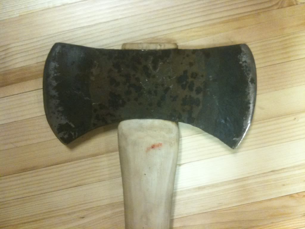

At the end of our last chapter, I'd discovered that a rusty old head that I picked off the Bay (described as a 'decorative item') was in fact a Mann KnotKlipper. I've since gotten it hung and started sharpening it back up. the hanging went pretty smoothly. 36" HHS DB haft, with a 1/4" excess protruding from the top of the head, as is the fashionable style these days.

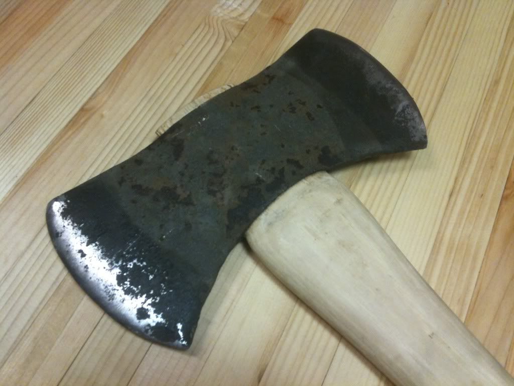

However, once I got to work on the bit with a flat bastard file things got more interesting. I was using a Made in Mexico Nicholson bastard that, just last week, blew through the bit of a contemporary Collins (not very surprising, I know). But after an hour or so of roughing in the profile on the Klipper, and doing my best to remove the pits in the bit, that Nicholson was/is scrap metal. D-u-l-l, dull. I could tell from the get-go that the Klipper steel was tough. Damn tough. But to dull a Nicholson that fast!? Now, I'm not sure if it was the fact that the file was imported, or the hardness of the steel of bit, or a combination of the two that killed that file, but it's dead as a doornail. A knife blank. I plan on picking up a new Nicholson, a US made one, this week to see how it fairs against the Klipper. Stay tuned.

That's interesting and very good to know about your experience with the file, Nick.
Is that blood??? :D
I use a hand file on every axe and I've done 3 or 4 Mann axes and I've noticed every one was hard to file. I wonder if they are tempered a bit more than the others.
Before I start with a new file I make a few passes with it on a piece of brass or copper first. I've been told this makes them last longer although I don't have any definite proof of it. I figure it can't hurt, anyway.

Sometimes oxidation on a tool can act like an abrasive against your files. This is a case where a knotted wire wheel or cup would be appropriate. Knotted wire wheels are made from carbon steel. They'll scratch the surface but that doesn't matter if you're planning to file it afterwards anyway.
Another thing that is important with file work is to stop if for some reason the file isn't cutting. A file skipping along the surface of the work will dull very quickly. Sometimes just a change in the speed or pressure applied to the file can start it cutting again.

I'd be tempted to grab a sanding block and get busy with the wet & dry to be honest*, rather than risk dulling a new file.

*actually I'd take it to the belt sander but you may not have or want to use one.
I'm curious for your update. My plumb double has the hardest steel of any axe I've seen and it dulled up two files. I was thinking about getting the U.S. nicholson file so I'm anxious to hear how it works out. Thanks for the update.
i came by a knot klipper a few years ago, had the same thing, just hard as hell. I did all my profiling with power sanders after the file just skidded off with only leaving some scratches. nice bit though, good work on yours.
