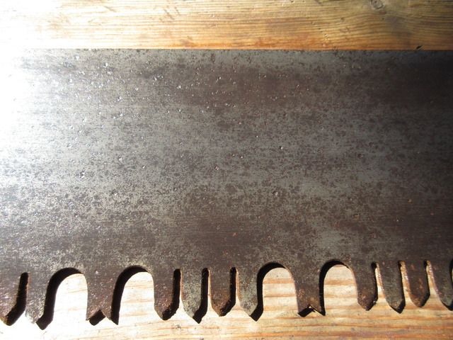

So here is the worst side of the saw, still needs more work as one can see but want to know if this one is too far gone.

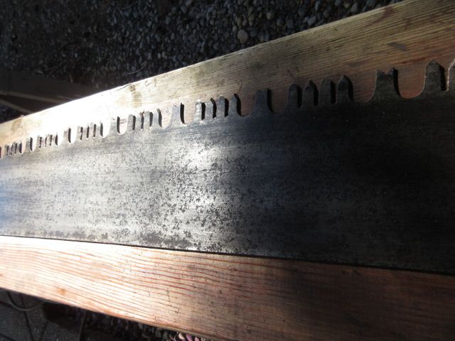

The other side which isn't as bad. This saw was in a shed for a long time.

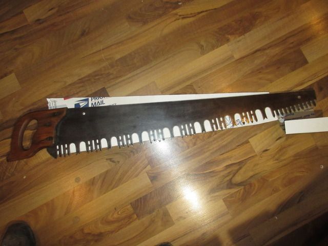

Here is a six foot saw that was given to me

Since it was "free" I thought I'd see what I could do with it. A person from the crosscutsawyer forum provided me with enough information from a similar saw they had to make a cardboard template of the plate. When I put the template on the plate it was obvious it wouldn't work. I trimmed the template down to have less belly and traced it on the plate.

More work than I wanted to do. Then I thought I might I might shorten it by a foot. So I laid out the plate where the end would be cut off and redid the tooth line (still with a shallow belly). Again, more work than I wanted to do.
The saw is now a decoration in my wood shed. :)

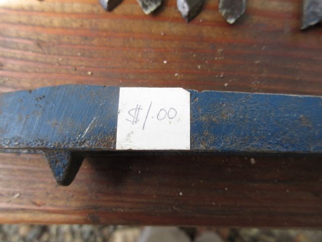

So I got my first saw maintenance tool today that I found at a antique store. Think I did pretty good on this purchase.

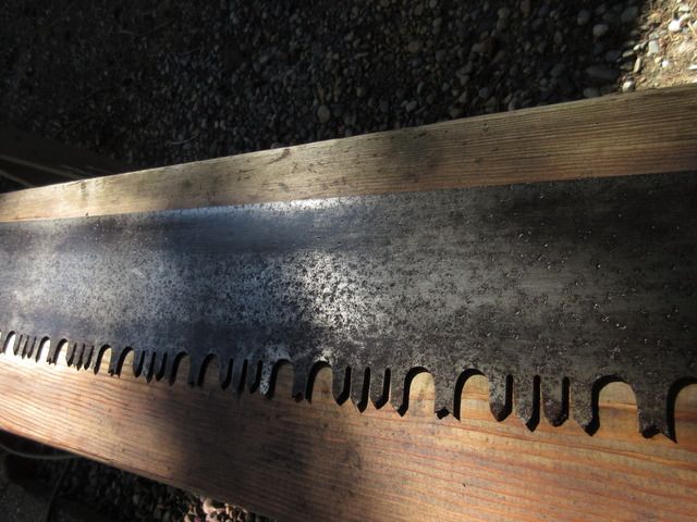

The saw is not too far gone, but those deep pits on the teeth could cause the tooth to snap when setting. Saw looks like it could be a Simonds 520. If you've not filed one of these big saws, I'd suggest starting on a smaller one man saw as the blade will be more forgiving. A big bucking saw is a lot of work and it can get discouraging when things start going wrong after hours of prep time.

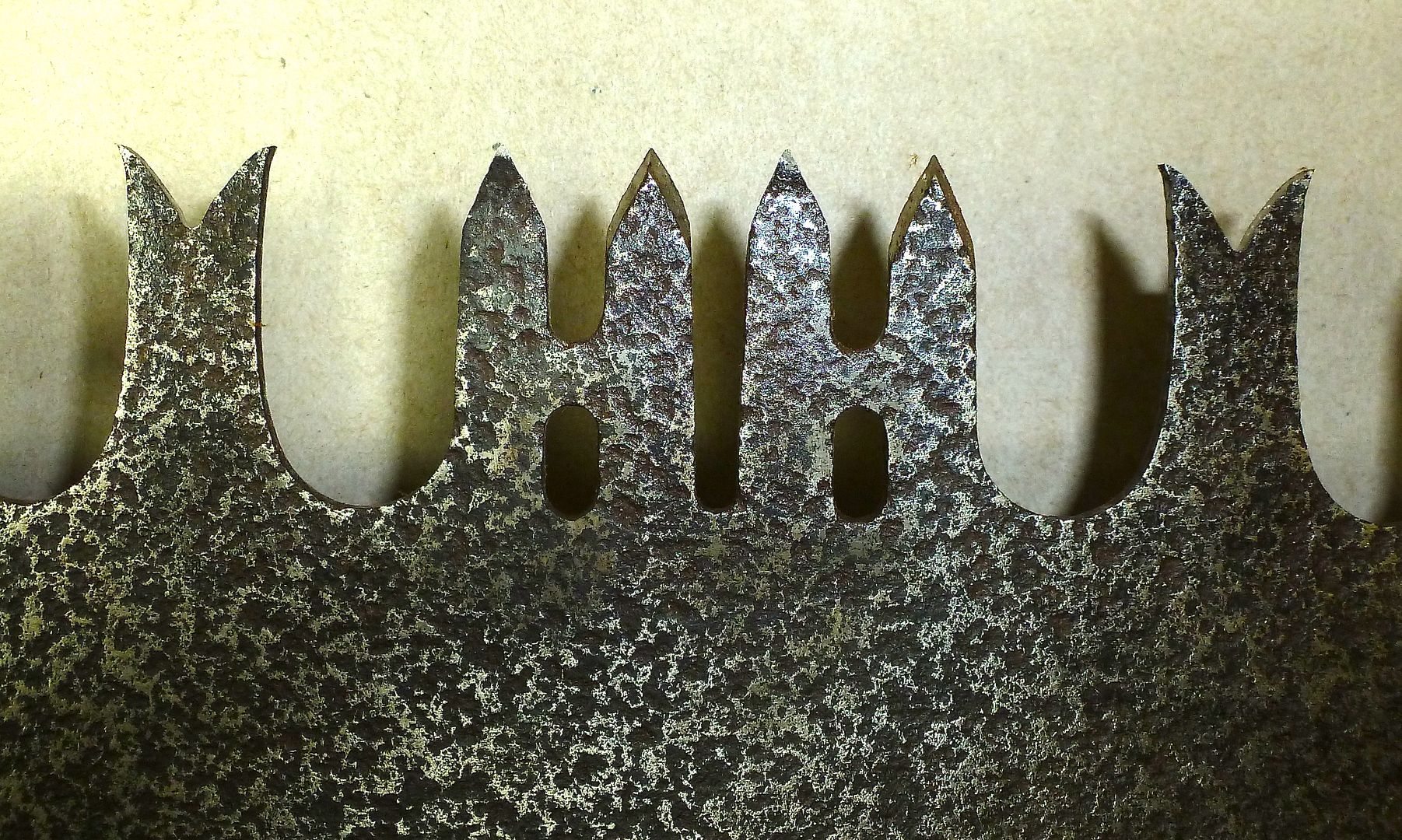

As a filer for my trail club, I am occasionally "gifted" with a saw when somebody cleans out their garage. Seldom are these in the best of shape, but I do try to put them back in circulation. This saw had serious pitting across the blade, but when I filed it up and hammered the raker swage and tooth set, there were no chips or breaks. In the jointing process you will flatten off the top teeth somewhat. This will allow you to pick the spot on the tooth tip with the most metal and file around the pit. It won't matter at all if one point is a bit lopsided, just so long as the final point has clean metal on the back side.
That's awesome thanks. My saw is not that far gone so once again happy to hear it's all good.

nice saw anvil. $1.00 :-).
