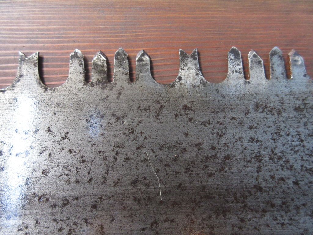

. . . This will allow you to pick the spot on the tooth tip with the most metal and file around the pit. It won't matter at all if one point is a bit lopsided, just so long as the final point has clean metal on the back side.
Sorry if I confused your saw. This is the "drag" saw that I was referring to:
Tom
As a filer for my trail club, I am occasionally "gifted" with a saw when somebody cleans out their garage. Seldom are these in the best of shape, but I do try to put them back in circulation. This saw had serious pitting across the blade, but when I filed it up and hammered the raker swage and tooth set, there were no chips or breaks. In the jointing process you will flatten off the top teeth somewhat. This will allow you to pick the spot on the tooth tip with the most metal and file around the pit. It won't matter at all if one point is a bit lopsided, just so long as the final point has clean metal on the back side.

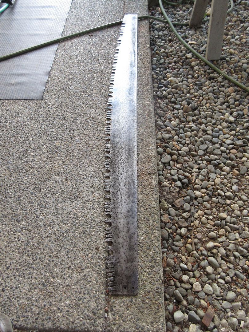

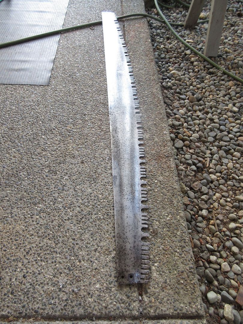

Here is a clean 6-footer laying on my 100% wood saw-buck:
Nice saw and sawbuck.:thumbup:
. . . I would stop polishing about now and start working on proper tooth shape and sharpness and you have a lot of teeth to work on.
I'm done polishing and it will be a user. Need too make a handle and a saw vise plus waiting for some tools to arrive via mail.
