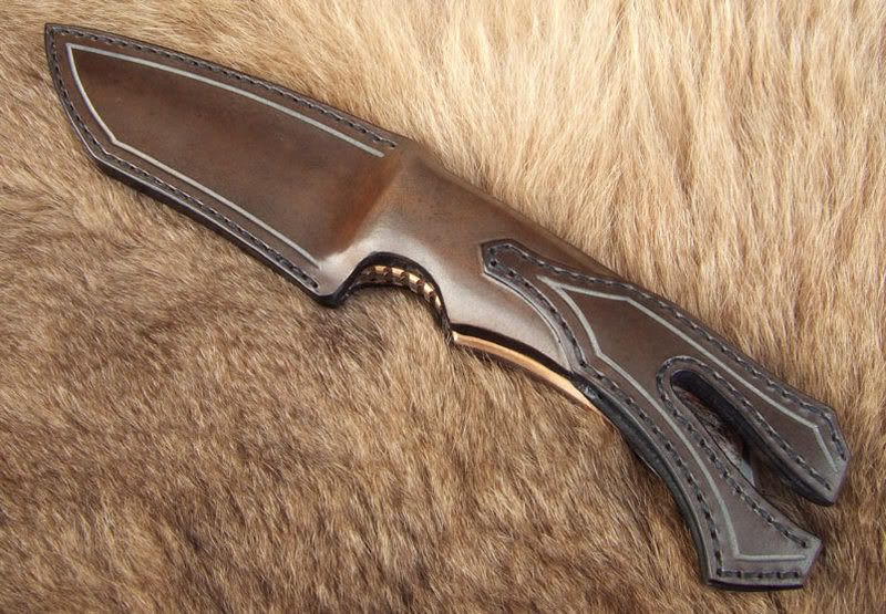

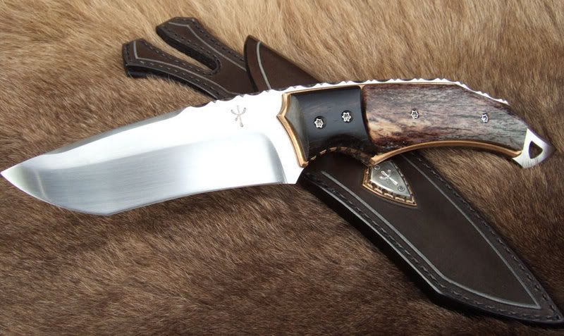

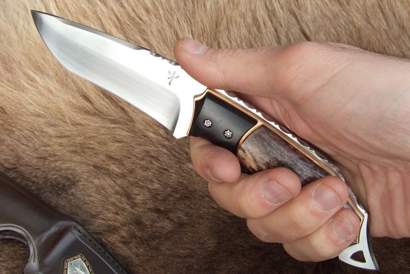

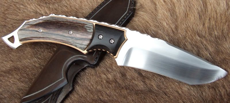

My first hollowground blade ever.
I found it quite hard to put a hand rubbed finish on the blade and still maintain the crisp grindlines.

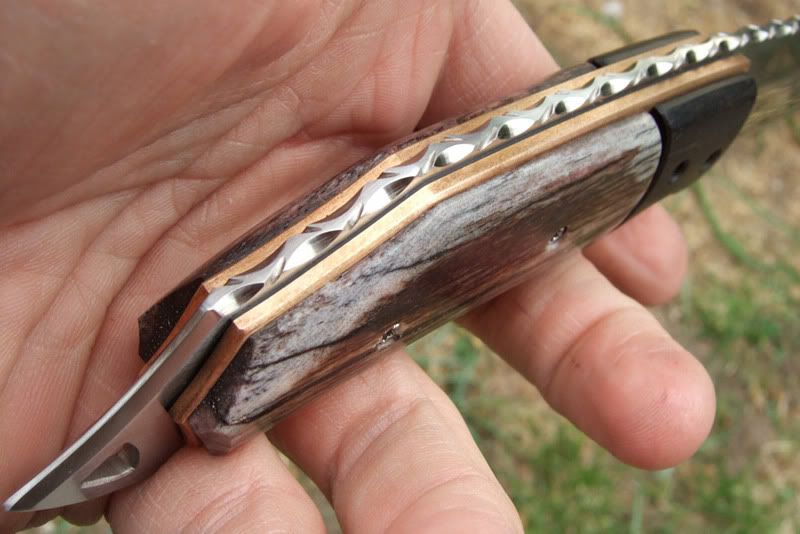

Anyway, the blade is made of RWL steel and is filworked along the spine.
I used bronze liners, stabilized giraffbone scales and ebony bolsters for the handle. All held together with filworked torx screws.

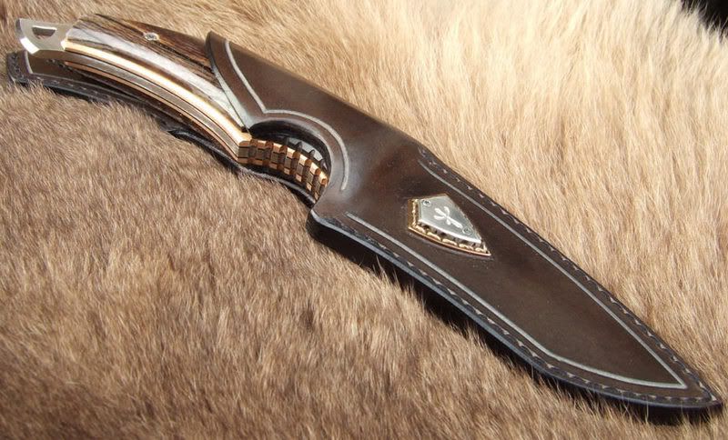

The knife has been done for quite a while, just got around to finish the sheath yesterday.
After some experimenting I managed to get the right shade of grey I wanted for the sheath.
Diluted black dye in many many layers did the trick.
Detail in pewter and bronze.
Any and all comments are welcome.
Thanks for looking.
