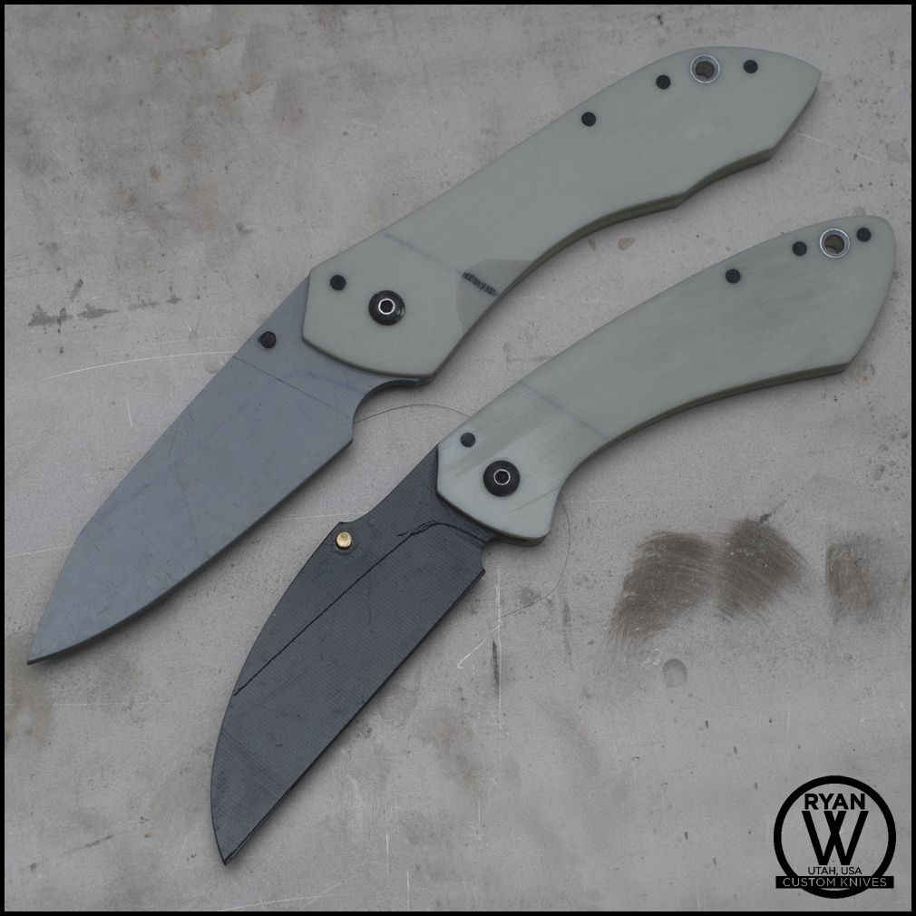

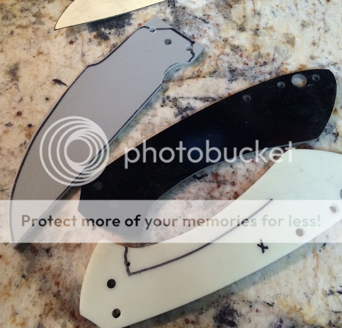

after talking with Eric Ochs I have been making up some "models" out of Kydex, and G10 just to make sure everything fits together. I am going to share a few WIP photos I grabbed during the process (I have made over 15 now in different configurations) Not all will be of the same model/design.
Happy to answer and questions if I am able

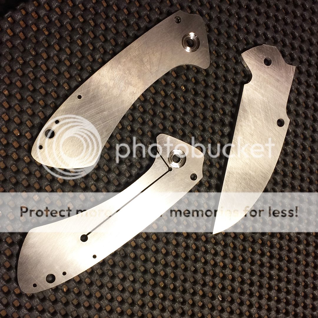

I have left a lot of the WIP work out of the photos, this should just give you an idea where the Ryan W. Knives Saddleback Folder is headed, I spent the weekend working on it with Eric and could not be more pleased with how it is going.

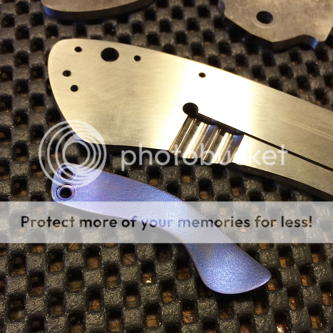

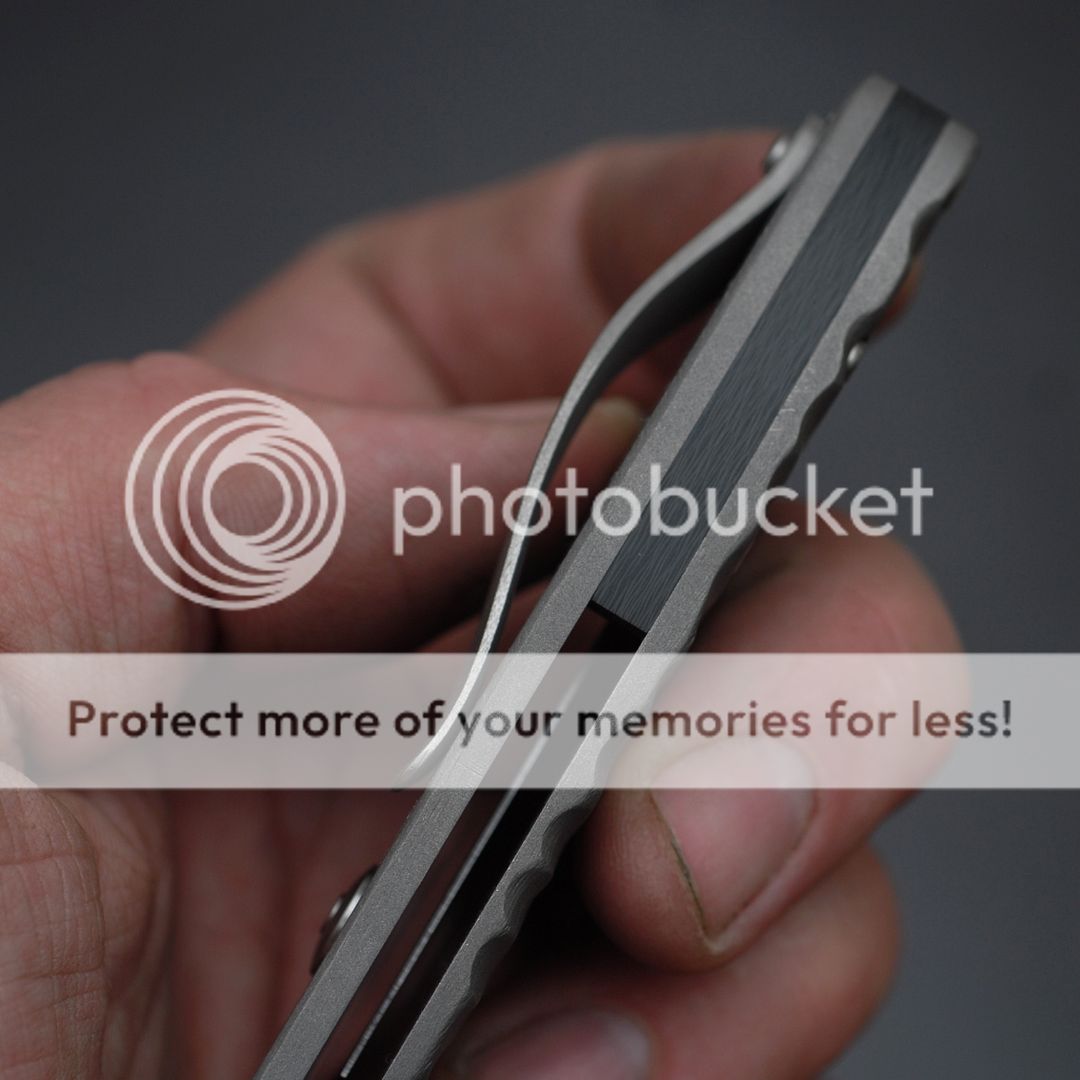

Custom Ti pocket clip ready to be bent into shape and cleaned up
Here the clip is after being cleaned up, orange peeled and anodized ready to go on the knife

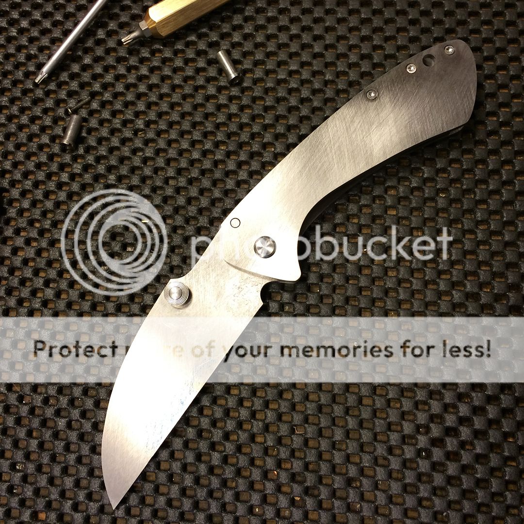

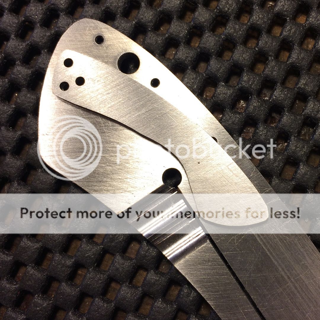

I initially wanted to knife to closer resemble my Saddleback Wharnie Fixed blade which has a skinny neck, but we were concerned that it would be a problem with the Lock bar being that thin so I decided to narrow the presentation side, leaving the back wider. which also allows easy thumb access to the lock bar when disengaging the lock bar to close it.

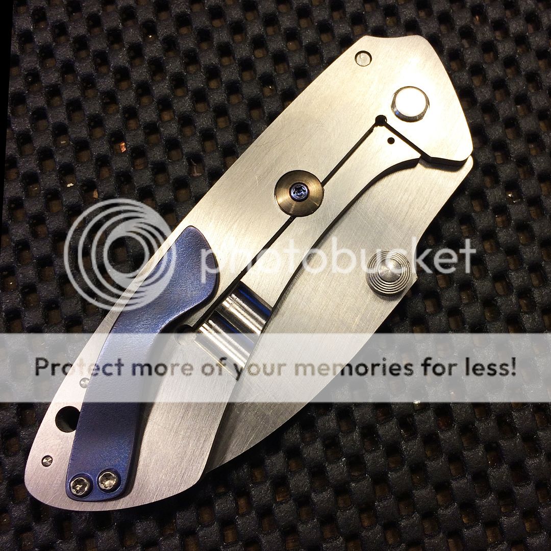

one of my favorite shots from this build so far here is the closed shot of the back
Here is opened... Obviously I still have to finish up the CPM154 blade!
Here is the Presentation side (Needs some love) ready to work on

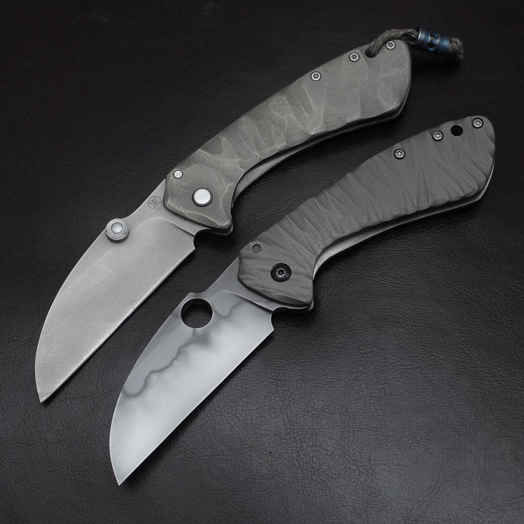

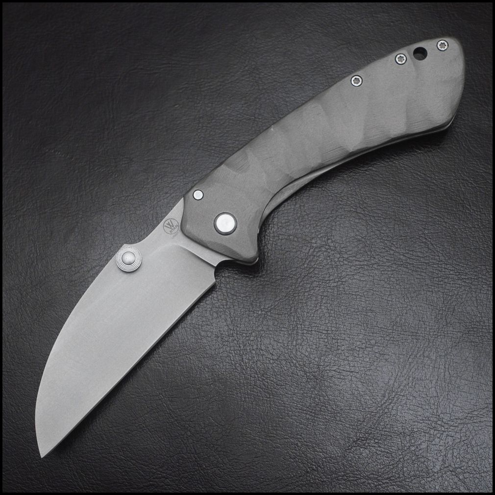

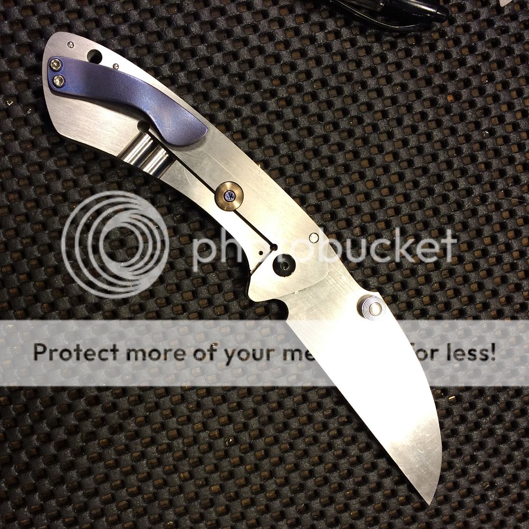

Just realized i never updated this thread with photos of the finished Prototype Eric Helped me with (Immensely)
Really happy with how it turned out. I have actually just finished up the First SaddleBack 100% out of my shop made by my hands. Will get photos here when able
Excellent looking knife! I love your fixed blades and moving to folders is a great progression.
What is the blade, handle, and overall length of the finished knife?
I ask because your placement of the thumbstud is unique. Most folders have them closer to the pivot right about where your makers mark is.
I have smaller hands so on tip up medium sized knives (8-8 1/2 overall) i have to very slightly readjust to open with the stud. Never been an issue just a personal quirk whichever maker you believe in dealt me.
With the stud where you placed it id wager this would completely negate that for me.

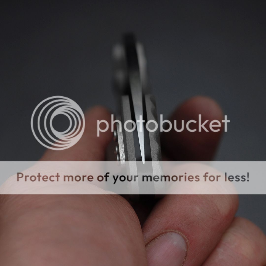

Its on bearings so no doubt its smooth, but does the stud placement affect quick flciking or slow thumb opening at all?
Thanks for the post everyone...
Benchwarmer: OAL: 8" Blade: 3.5"
I had a lot of space for the thumbstud so I used the big one. These are going to have the Spyder holes but I was waiting for approval from Spyderco to do that (Which I have now) Probably best way to show you the action is in a video

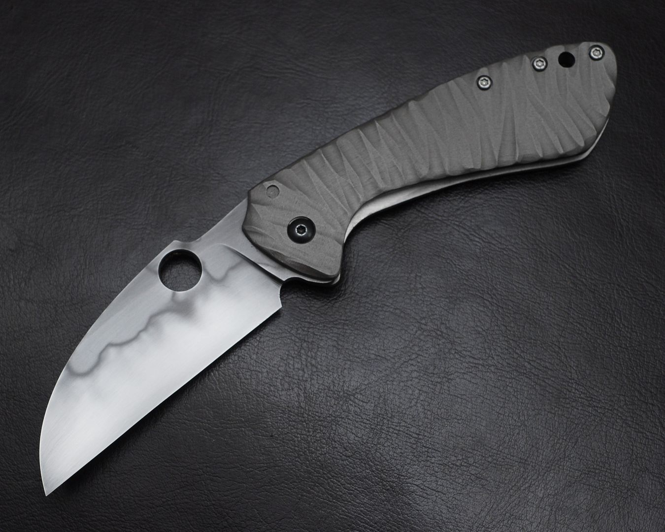

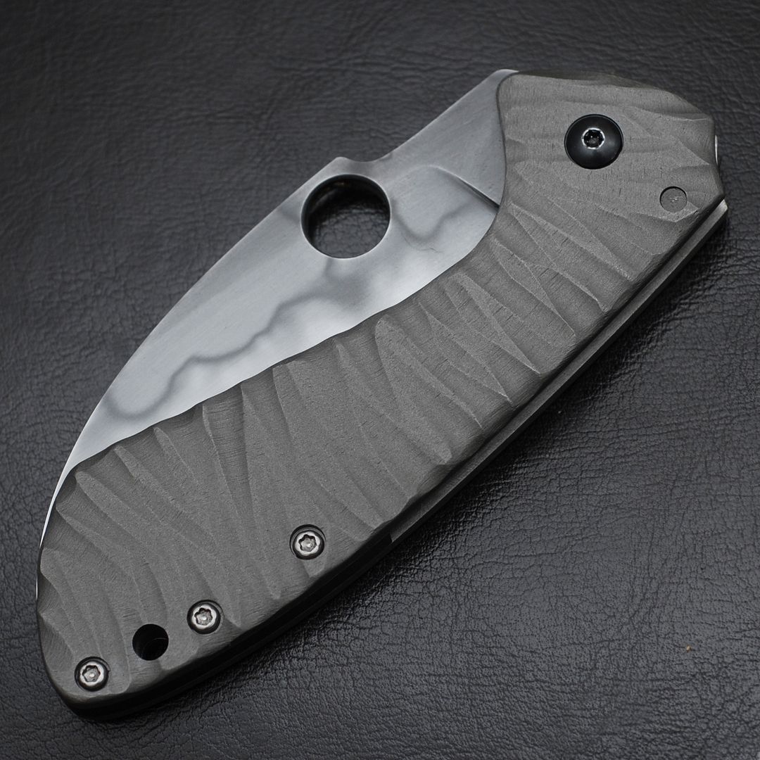

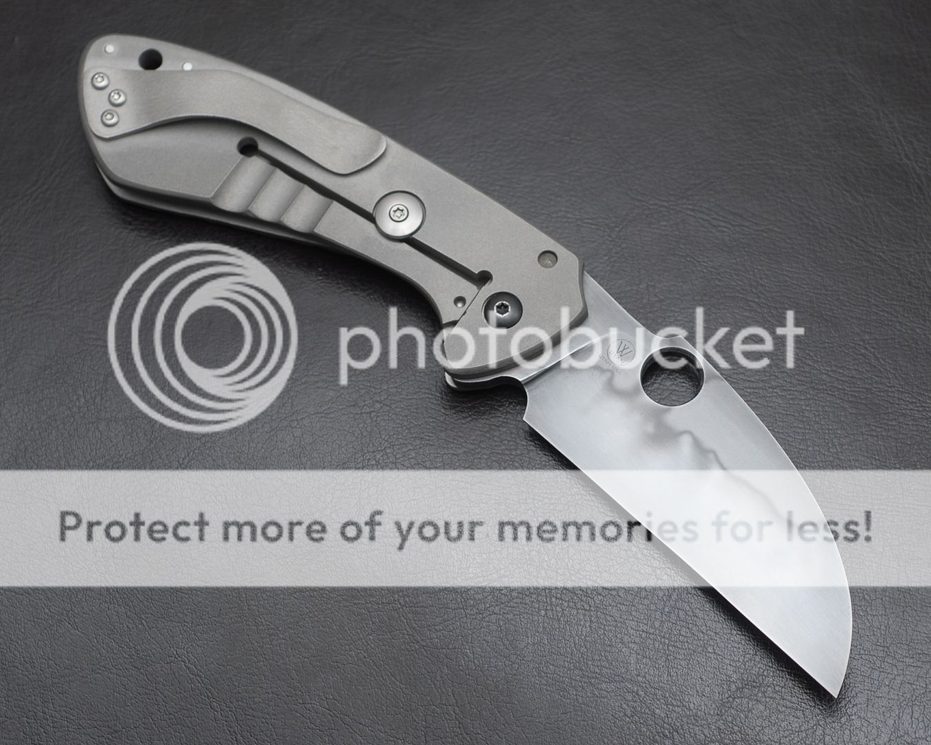

I have finished the first one to come out of my shop with the Spyder hole
You were right, the video shows the action perfectly.
Now i can't decide if i like the thumb stud or the Spydie hole more.
Thanks for your response and the vid Ryan!
Here are some more photos of the New SaddleBack (#001)... This one is Sold but hope to make a few more ;)
I will have it with me at the Blade Show, If you are there grab me and ask to have a look at it! Comments appreciated!
