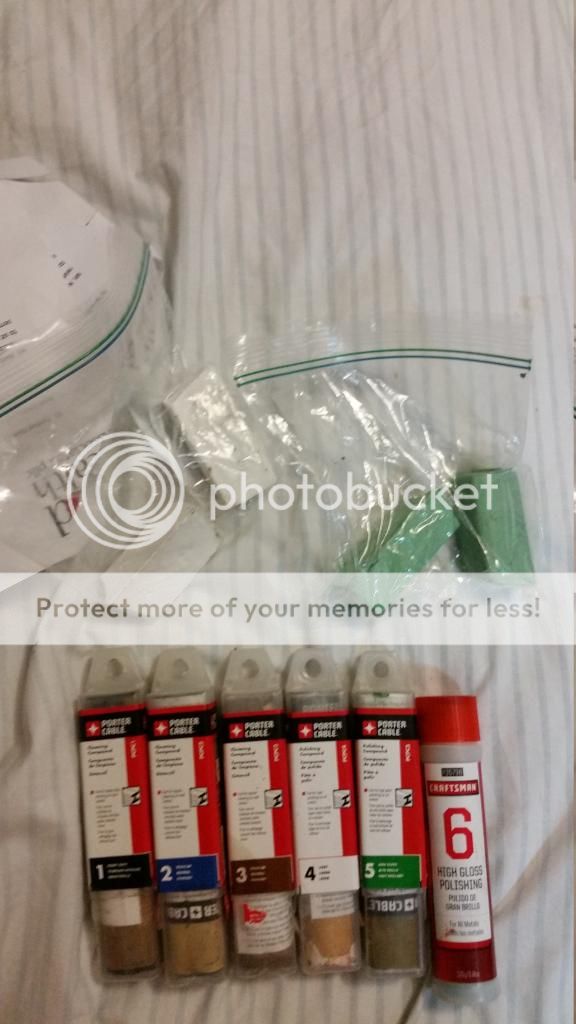

i have these. the no. 6 is a green compound craftsman brand theres a white vlock compound and a green block compound i have no idea what the microns or grit sizes are. so if anyone knows please do tell or pm me or both lol
