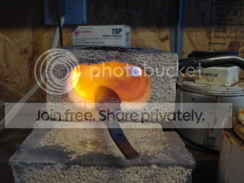

Here's probably your cheapest route other than finding someone in your area to help you out. This is what I used to heat treat my knives before I built a kiln. Its built out of a soft fire brick. You can try to find them locally or order one from Darren Ellis, they're cheap so if you buy/order one I would suggest buying 2-3. Plus if you build one then you can use it multiple times.

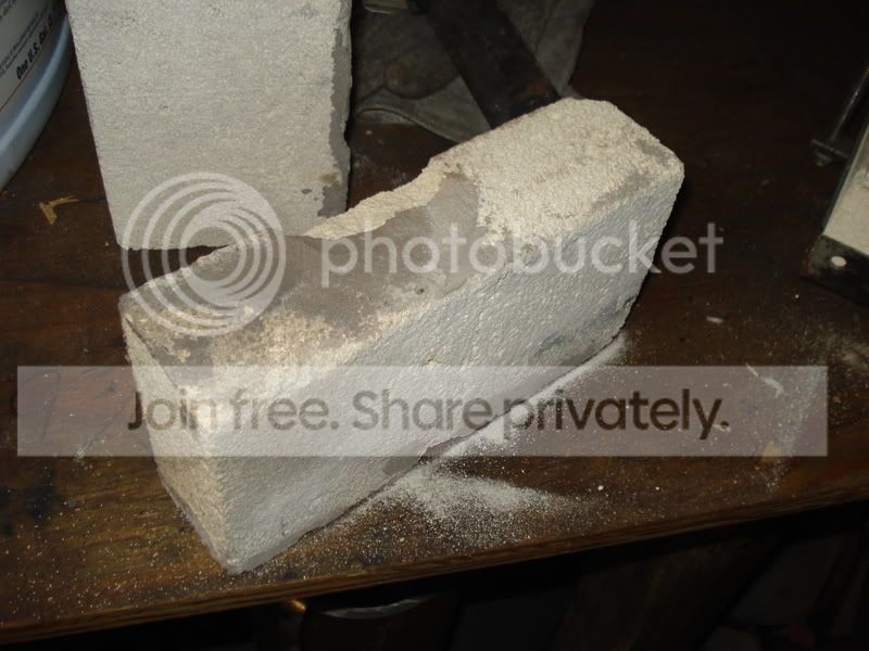

Here is a picture of the firebricks I'm talking about. Notice that its a soft fire brick not a hard one like you use in a wood stove. Those won't work because they have no insulating properties.

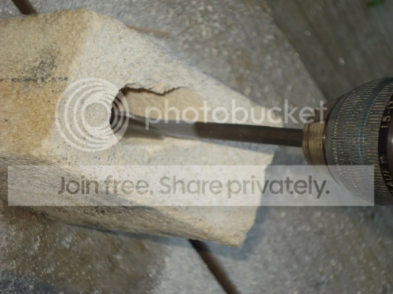

Next I use a spade bit and a cordless drill to bore out 2 holes that will later become the chamber. You could use a smaller drill bit it would just take longer. Try not to leave the edges too thin so there is less of a chance of cracking.

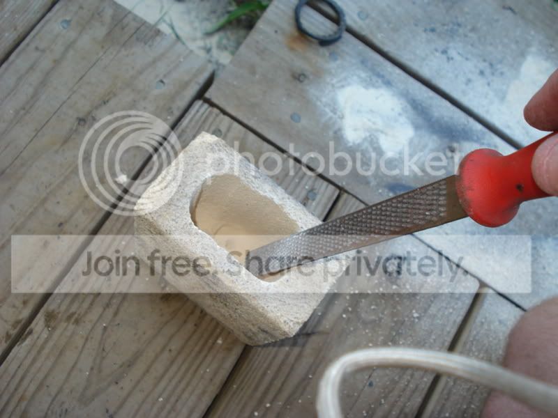

Next I used a wood rasp to knock out the excess firebrick material and make the chamber into an oval shape.
The last thing to do is drill a hole large enough to fit the tip of your torch tip into perpendicular to your chamber you just drilled out. Notice the torch tip on the right in this last pic. You might want to also use wire to help hold the brick together since they have a tendency to crack after repeated use. I don't know how big your knife is but i hoe this helps.
That's pretty much the setup I used starting out. You can play with the position of the torch hole to get the best flame distribution. Use a Bernzomatic JTH7 torch and place the torch tip several inches outside the hole in the brick to allow O2 mixing as the torch blows into the small forge. Use a couple of bricks drilled out end to end to increase the depth of the forge, but you'll lose heat as you move away from the flame hole and there will be hot spots. Let the blade come up to temperature (past non magnetic, pull it out and let the temps equalize a bit in the blade but don't let it cool too much. Then move the blade in/out in the brick forge to reheat to even heat, trying to hold the temp as you reach the critical temperature.
