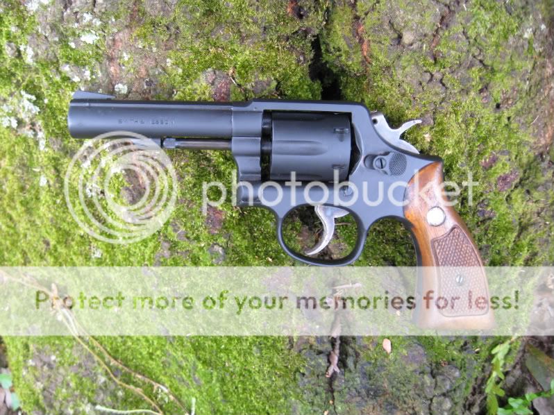

Hey Guys,
I have an S & W Model 10. What would be the best dog/bear load I could use through this revolver when I go backpacking?
Thanks,
Geoff
you don't say where you are, so I have no idea if you mean "black bear" or "Polar Bear".
The trail load I carry in my 4 inch heavy barrel Model 10, uses new .38 Special Winchester brass, CCI small pistol primers, Blue Dot powder and the Sierra 140 grain JHP bullet.
It is more than adequate for protection against dogs, and I have no doubt that it would perform well on Florida Black Bears.
I see bears frequently, and after some 50+ years of running into them when hiking and camping, I don't feel that I need to fear them.
Hey Mannlicher,
That is the exact revolver I have.
I live in California and the reason I asked this question is that my 357 686 weighs 3 pounds and I hate hauling it around when camping. I know the 357 will do the job, I just was not sure about the 38's capability.
Geoff

My 10-8 is very accurate with 5.5grs. of Unique & a GA. Arms 158gr. SWC. it chronos at 1059fps from its 4"HB. & is a book plus p load, not a problem for a model 10-8 or newer & some older model 10s. cast bullets at 1000fps or above are great for a lot of game. cast bullets can be used on mouse to moose, with the right shot placement !
