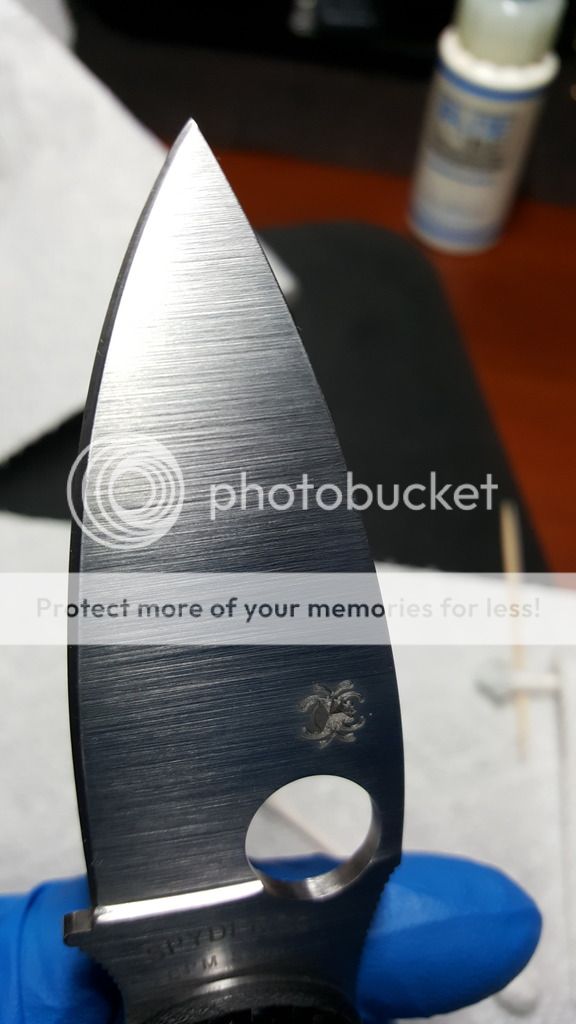

I tried for about 2 hours searching for a possible solution but couldn't find much. Hopefully someone can save my hide here.
Could someone tell me how to clean up etching caused by Bar Keepers Friend or maybe point me a good shop that I could send the knife to?
The knife is a Sage 1 S30v. I've only ever used BKF for cleaning Sharpmaker stones and never on the knife. I had never even bothered reading the ingredients, something I usually do, or the key part about not leaving it on beyond 1 min. I had cut some exotic plant stalks without cleaning the blade after until two days later. It caused a haze or patina on the blade like I had never seen before on this knife. I decided to use BKF but left it on too long and one time too many before realizing I was making it worst!
Now it's etched to the point its annoying. Cloudy hazed looking. I have some polishing compound bars in 5 different grit from black to green and even the black (roughest one) would not do much when tried in a small test area using a dremel with buffing wheel. I really don't want to try any more crude methods unless I know it's been tried before. Have not tried 0000 steel wool yet and doubtful that even work.
S30V being such a tough stainless unlike a stainless sing, it would seem that to even budge this would have to be put on a belt sander by someone who has experience doing so and without ruining the factory engravings.
Any help much appreciated

Sanding is likely the only thing that'll clean the etching up. Linear passes in one direction only and parallel to the factory grind lines, using a sanding block. Something around 320-400 grit SiC wet/dry paper is where I'd start, more closely emulating the factory finish. S30V is pretty wear-resistant, so the finish left by sanding will be finer than if done with the same grit on simpler steels; hence my suggestion to start a little bit coarser. Higher-grit sandpaper will have a bit of a tougher time with S30V's carbides as well (it doesn't sharpen easily at higher grit, with SiC paper), so sanding generally goes better at somewhat lower grit on such a steel.
Yeah sanding it had crossed my mind but wanted to hear if anyone else would suggest it or tried already. That sounds like the best option but may be the second one I try. I briefly hit a very small area with 1000 grit wet/dry paper as it was all I had last night. It would move some steel (could see it clogging the paper) but as you could image at such fine grit it would only polish the peaks which was insignificant with the deep brushed grind on these Sage S30V. It would have to be around 400 as Obsessed mentioned. Could be high as 800 too but we will see. The right grit should allow to get down in those valleys without actually smoothing the finish too much. Hopefully if I decide to try this method I can stay away from the Spider logo and feather around it to look right.

The removal of patina (oxidation) with polishing paste or BKF and steel wool is only a surface fix, as the oxide is much thinner and much less wear-resistant than the etched steel on the S30V blade.
The etching of the S30V has actually altered the surface texture of the steel, sort of like pitting would do with corrosion (which is what the BKF did to the S30V, technically). So, with one method, only a thin and not-very-hard dark oxide is being removed from the surface of relatively unaltered steel; with the other method, the steel itself, with it's uber-hard carbides, has been permanently altered by the etching. This is why it'll take some sort of aggressive sanding or grinding to fix the etched steel, whereas the oxide on the simple carbon steel is much easier to remove with metal polish and some relatively light scrubbing.
A patinating process on simple carbon steel will actually pit or etch that steel microscopically. But again, with such a treatment, the alteration to the steel is usually much more shallow and occurring in steel that's much less wear-resistant, and therefore much easier to 'fix' with some polish and elbow grease. Compare that to a chemical process capable of deeply etching stainless steel (which S30V is), and how much work it'll take (sanding/grinding) to fix the damage resulting from that.
Agreed. I came across a new package of 400 paper I had at home. I tested on a small Buck blade that has the same textured grind as the Sage although less wear-resistant but it took little effort to remove some surface scratches and cleaned up nice. It left a very slightly less of a brushed appearance. Being the S30V is rougher texture 320 might do the jon better so I'll pick up some and give it a go. I've abandoned the steel wool idea.

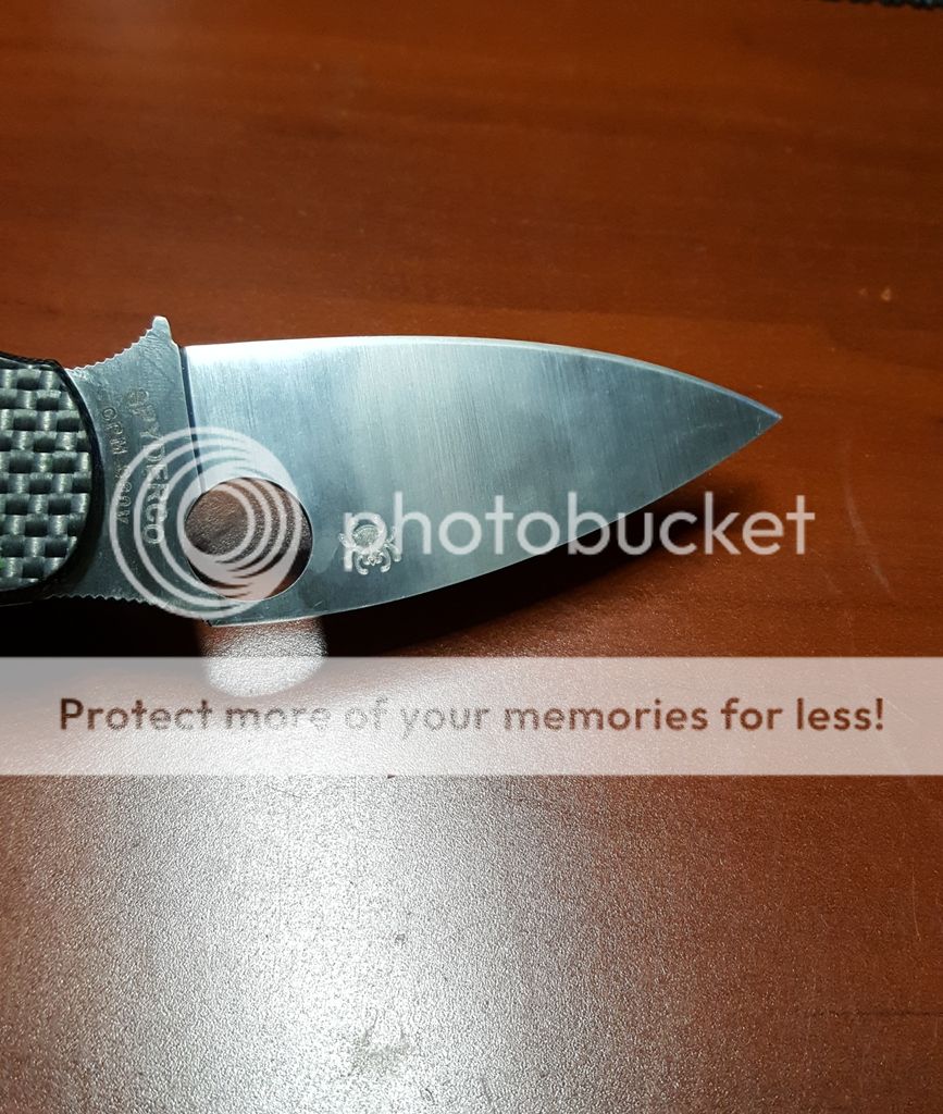

400 & 600 seems to do the best. I used good quality wet/dry paper and wet sanded it. When trying 320 it seemed the grit wouldn't bite into the S30V and wasn't doing much. It would have taken applying pressure that I wasn't willing to give for safety reasons. 400/600 worked well.
I disassembled the knife and laid the bare blade flat on a surface. Cleaned it with a dab of ammonia before polishing then and again after followed by oiling. I was able to remove some old scratches too to so was actually a gain. I tried to polish evenly while going completely from one edge to the other without stopping in the middle to prevent check marks. At no time could I notice one spot was done more than the other so.. blending was a non-issue. Probably because this steel is ridiculously tough. Thanks for everyone's input it was much appreciated and it helped.
Edit: My lesson learned here was BKF is a very useful product however, pay attention to the amount of time it's left on a blade, or anything before rinsing. Lastly, scratches on S30V with this brushed grind, can be removed by wet sanding without much of any signs that the blade has been thru any such sanding.

It looks good ... I'd say you picked a good route to go :thumbsup:
