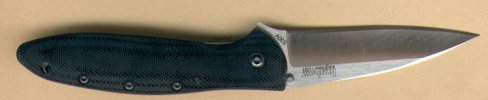

I just bought a pair of new s30v Leeks, and while nice in appearance, I find they do not open smoothly or reliably like my other 3 Leeks. I have not tested them in terms of sharpening or cutting because I don't want to blow my chance to have them replaced if necessary. I've only oiled them and tried the AO mechanism numerous times to break them in. I'll still get an incomplete opening, whereas my silver, black, and rainbow Leeks never fail. Recommendations anyone? Thomas, are you watching?:confused:

Maybe I've learned something on these blade forums! Piecing together comments on my Leek, and other solutions I've read in other threads, I decided to fix this knife, and it turned out dead easy. I went out and bought the appropriate Torx driver and backed out the pivot 1/4 turn, and bingo! the knife worked as it should! But with too much blade play, so I tightened it 1/8 turn and it's still good! The thumb stud was hard to reach though, and slippery, so I got some fine emery cloth, wrapped it around a fat dowel, and (gulp) started grinding away at the g-10 handle on my NEW LEEK! Well the sky didn't fall, and the knife works great with it's new thumb notch, and since form follows function, I think it looks great too. Hmmm, maybe I can get a job designing knives?! All that steel, all those machines, my name on the box! Huh where was I- -Oh Yeah, Thanks for the comments guys in this and other threads;)

Here are some pics of my "customized Leek". First the knife open, then a before and after of the stud area (did I mention I bought two? Gotta have a safe Queen!)

Professional looking job. :thumbup: Hell, it looks factory issued that way, or atleast maybe it should be factory issued that way. Thanks for the pics!

I agree. I like the recessed thumb area :) Nice work man.
