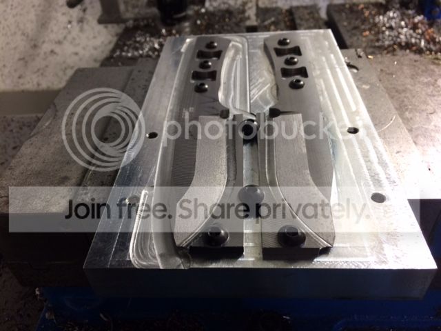

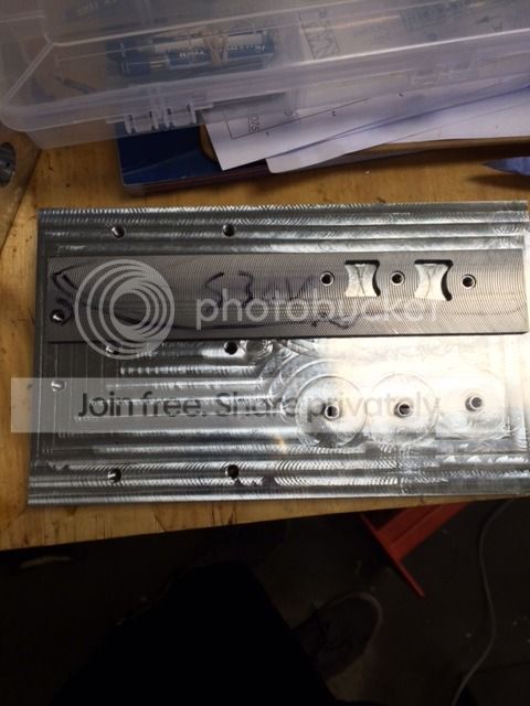

I'd love to see your progress as well. I've debated doing this a few times and I get to the point of trying to decide how to do the work holding and invariably decide it would be faster to simply grind by hand. I'd like to see your workholding plan especially. I was just going to make a little tooling plate that clamped the blade similar to how those who use filing jigs do, with some miniature toe clamps.

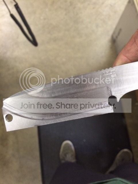

I made up a few blanks over the weekend with what I believe to be Ok success. As a whole, It machined a bit better than I was anticipating. I utilized High speed machining to rough the blank down with air blast. I only cut 4 blanks but had no noticeable tool wear issues on my roughing or finishing end mills. When It came down to the actual surfacing I got mixed results, both less than perfect.
As I was expecting, when surfaced with just air blast it appeared to "tear" the material rather than cut. This is certainly in part due to a previously used tool. When I tried to surface with flood coolant the finish was noticeably better but It appeared to have started to work harden.

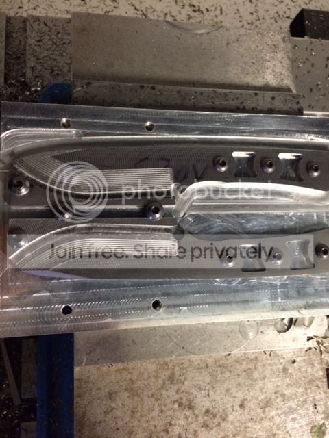

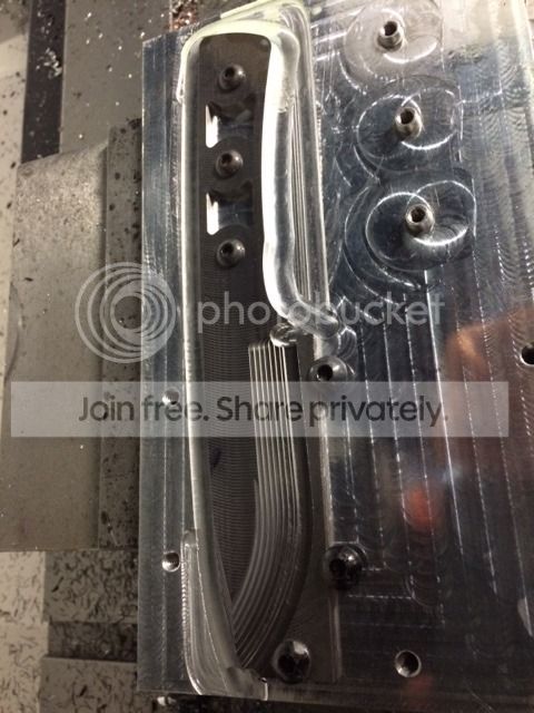

my fixture is made of aluminum since it is the first iteration which will certainly need revised once I see what kind of results I am getting. The holes in the tang are reamed which are a very close slip fit to the fixture. The hole near the blade tip is body bound to the button head in the fixture which locates the blades repeatably from one side to the next. Once both sides were machined I used toe clamps from the back to secure it as I mill thru the .03 web to separate the tab from the blade.
I was very pleased with the flatness of the blades after they came out. I wasn't sure if the stresses would neutralize. The Stock was very good going in FWIW.
I am certainly expecting to have to finish theses blanks with some hand word, but both of the results listed above will need more than I was hoping for. I have a few more approaches to try.
Stay tuned. Any suggestions or comments would be appreciated.

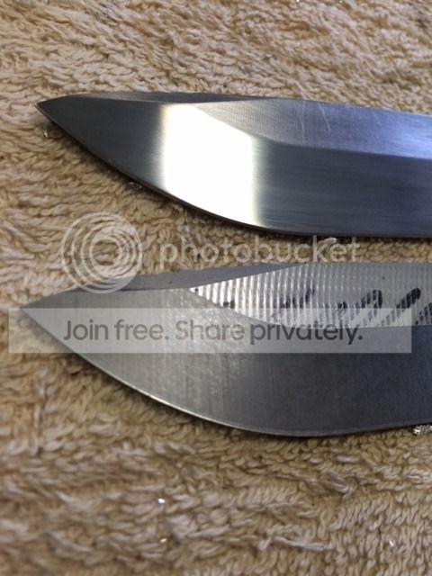

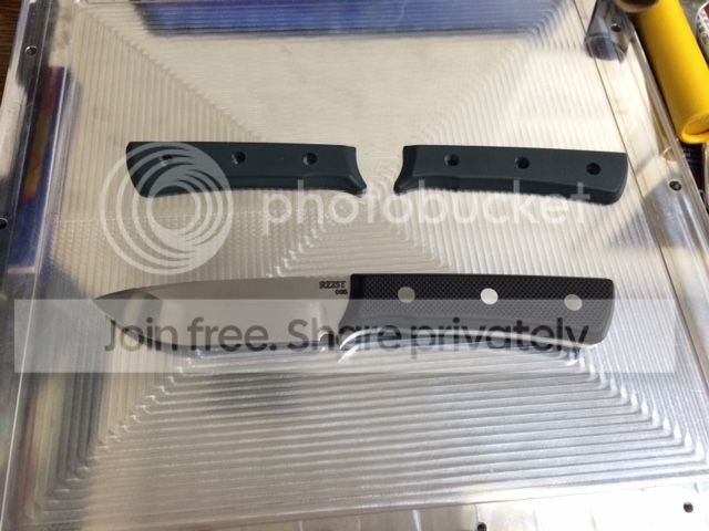

Back again, this time with better pictures.
I changed my finishing tool path and cutter to a .25 bull end mill. It was set to finish with a constant Z but I found a climb milling linear tool path to provide a cleaner surface. It makes for a slightly longer run time but the finish is, in my opinion, worth it.
With just a small amount of hand work I am able to get a pretty good shine.
