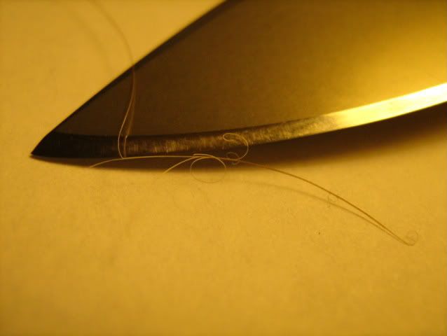

I think the main problem is we are all use to the amount of time it takes to sharpen softer steels like 1095, AUS-8, and 440. It can be frustrating at first but keep cleaning your stones and spend the extra time. Here are two knives that I sharpened in the past few days, the first one is a kershaw cyclone with 13c26 steel, took about 45min to reprofile, sharpen, and polish. The second is a BM mini-rukus S30V, this one took 2+ hours to do the same.
cyclone
mini-rukus
