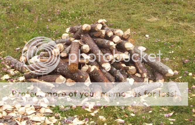

Half of that pile of wood was chopped with a Cold Steel shovel with a 30 degree included edge and it still sliced newsprint readily. An actual knife steel can actually go more acute still. These were heavy chops, full power from the shoulder with the wood being cut on average in 10-20 chops per section.
In general as you reduce the edge angle the cutting ability, edge retention increases and ease of sharpening increases. At some point you will go so far that you pass the durability of the edge but this is *way* more acute than common sharpening angles and can usually be addressed with a suitable micro-bevel or light convexing.
I don't actually know if that is the limit of the shovel, I just can't grind it any lower on a belt sander due to the curvature.
-Cliff
