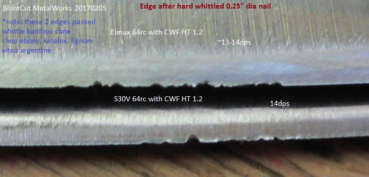

This weekend, if convenient - I will piggyback ht a s30V w/ maximum grain refinement - target for 64rc. If it performs at or better than Elmax 64rc level, then s30v could earn a spot in my lineup.

Just finished testing S30V 64rc CWF HT 1.2 (maximum grain refinement). Edge geometry 14dps, 0.015" behind edge thick, DMT F finished grit.
Whittle bamboo cane: passed.
Chop ebony, katalox, lignum vitea argentine: passsed.
Chop cooked pork rib bone: visible with 5x loupe - 3 -4 ripples (bacon bends not rolled nor chips).
Hard whittle 0.25" dia nail: Passed with light pressure. Ripples with moderate pressure. Chips (~0.02"/0.5mm tall) when push hardest with thumb.
This sort of reconfirmed my earlier suspicion (not enough empirical data) s30v via std ht has coarse grain. So my refined grain S30V 64rc is now inline with the rest of my stainless steels performance.

It's been interesting reading all the different opinions on this steel. Certainly cannot argue with this. Thanks for doing and sharing such a detailed test.

If you are using corner/edge of the SM stone, that would be most likely culprit micro-cracks at/near the edge (unseen, points of initiating deformation upon moderate force while in service). Also apexing with coarse stone can also micro-cracks near apex, especially for blade with low impact toughness.
